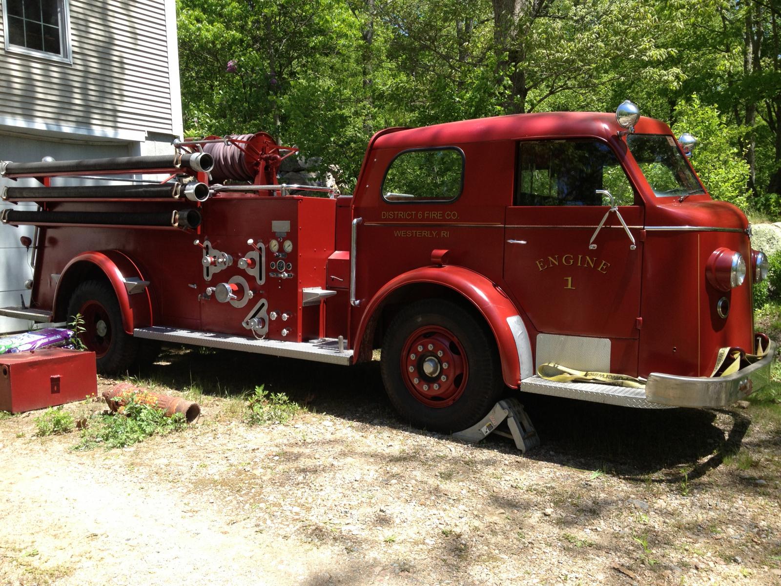

Besides my B-42 dump, I also currently I own a 1949 ALF pumper (see pic) that I sent off to a repair shop a couple years (yes - years) ago. They have not been able to get it running (there's a much longer story, but I won't bore you with it), and seem to have actually dug a hole that they can't climb out of, and now it's sitting out behind their shop deteriorating.
Is there anyone here that knows of anybody in the Northeast (RI/CT/MA) that is capable of getting an old ALF V-12 running, including synchronizing the carbs? The carbs have been rebuilt by the V-12 shop in TX, but the truck was not running when I dropped it off, and they did not solve the not-currently-running problem (it had run a few months before when it was garaged for the winter) first. So now they have the carbs back, but no baseline to start with to get it going again.
Anyway, they've given up and have actually offered to buy the truck from me. But I have a lot of work into it, and hate to let it go. So if I can find someone that thinks they can get it going again, I'm very tempted to try one more time before taking up his offer and just finding another truck (maybe another B?)...
Any leads would be appreciated....

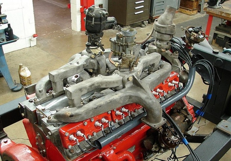

Very odd v engine, valves are horizontal.
Since the V-12 shop was involved in the carbs/ engine and since all they do are ALF V-12 series engines, maybe they know of a tech near you?
post-3242-0-67118900-1451701326_thumb.jp
thats some what like a scripps marine
I think Scripps was in on the original design or licence produced a similar engine for WWII USN use in tenders and such.

that sure is a complicated looking mess for a truck thats supposed to be ready to run instantly
That is why I tell anyone who asks about getting an antique fire truck to steer away from the ALF v-12's. The trucks are an icon in the American fire service, but the engines can be a nightmare.
Hi I think lycombing originally designed the engine in the early 30s for auburn to use in their one of there cars and when they closed American lafrance modified it with dual ignition for its trucks. I have a 1938 junior 400 pumper with that engine mine only has one 2 barrel carb and has always been a good runner. I had trouble starting it at one point and when you got it running it ran bad. My truck has a manifold vacuum pump primer on it. When you pull the primer knob it closes one side of the carburetor off and opens another valve to that side of the intake manifold which sends the vacuum to a priming tank. On mine the second valve got stuck open and half the engine had no manifold vacuum. Mine also has a pump governor that controls the engine speed to the pump output which is mounted under the carb if yours has one it may not be fully open. On a hill the truck does sound kind of Lise an airplane. Dean
