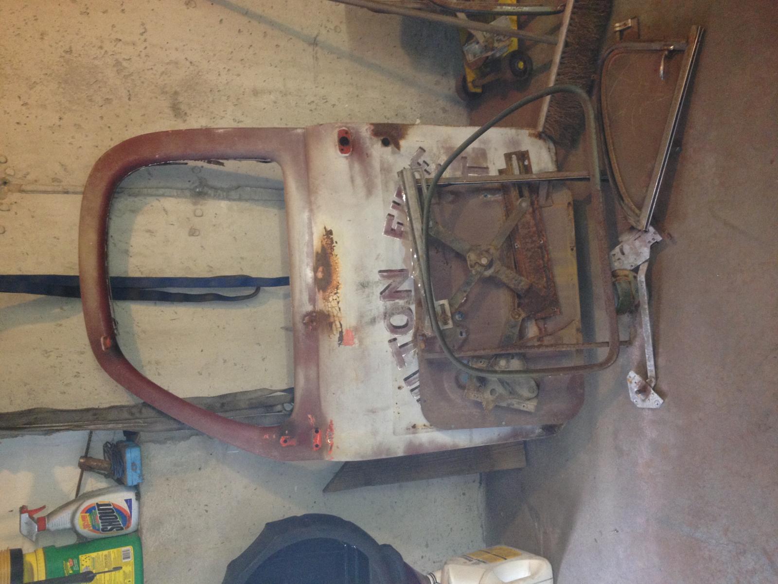

Keep the pictures coming. I'd hang that door on the wall as a souvenir and get one without rust to replace it. It would make a great decoration. Good luck. Mike
That's a great idea. I have two doors in better shape off of a parts truck I picked clean. I have to fix up where mirror brackets were welded on and bolted but the damage should be easily fixed. That door has no bottom...the hornets love to build a nest inside the hole where the lock should be every year. I hate those suckers.

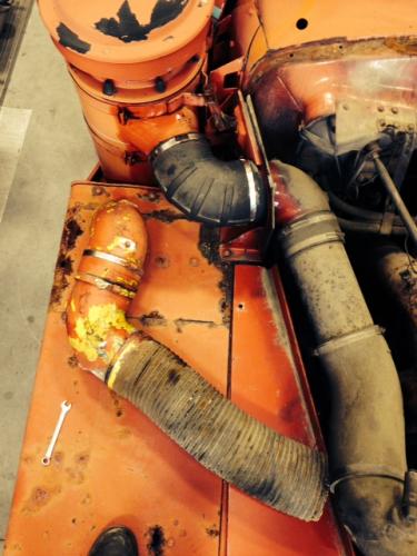

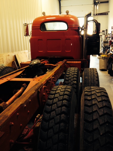

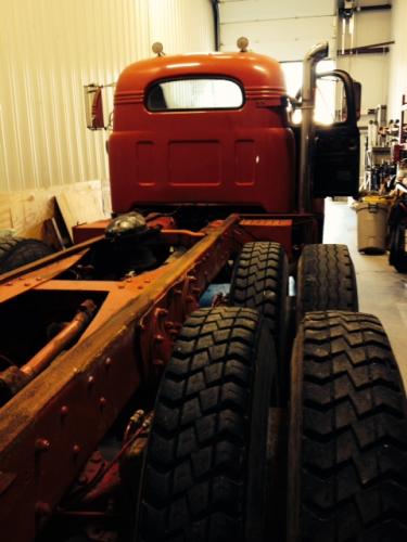

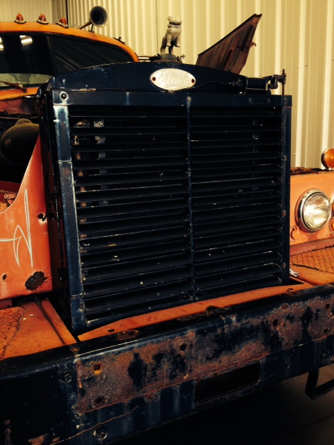

Did some work yesterday. Tore the left front off, both doors, the air cleaner and the corner markers from the bumper. The floors look solid although they have plenty of man made holes to patch up. Once I have stuff all apart I will start blasting and prepping for paint. I suspected but am sure it was orange from the factory. I kind of like that as it will not be yet another red or green Mack. Tanks and radiator to be black I think. I need to write to the museum for the info on it still...guess now is a good time. It's kind of a pain that they used nuts and bolts rather than captured nuts. They must have assembled them in teams as one guy can do both ends. I think I have to pull the heater box to get the air cleaner bracket off...Oh well. Hey is the that an oil cooer in the picture of the engine? The hoses out to the housing by the drivers door are hard as rocks. Is that an oil filter housing? if so what goes in it? I plan to replace the hoses. what do we think of orange?

Yes from the pic that appears to be a oil cooler. The line coming off the front by the rad hose is a pressure line just like a hyd hose so it will be hard and not very flexable. And yes that is your luber-finner filter housing it takes a large cartridge style element. There are two sizes (if i remember correct only two) a small and large most macks take the smaller of the two sizes. The other line is lower pressure back to the cooler. As far as the v8's their hard to find and parts are even harder. This was brought up on a different page and it was said that parts are almost non existent. If im wrong here someone please correct me.

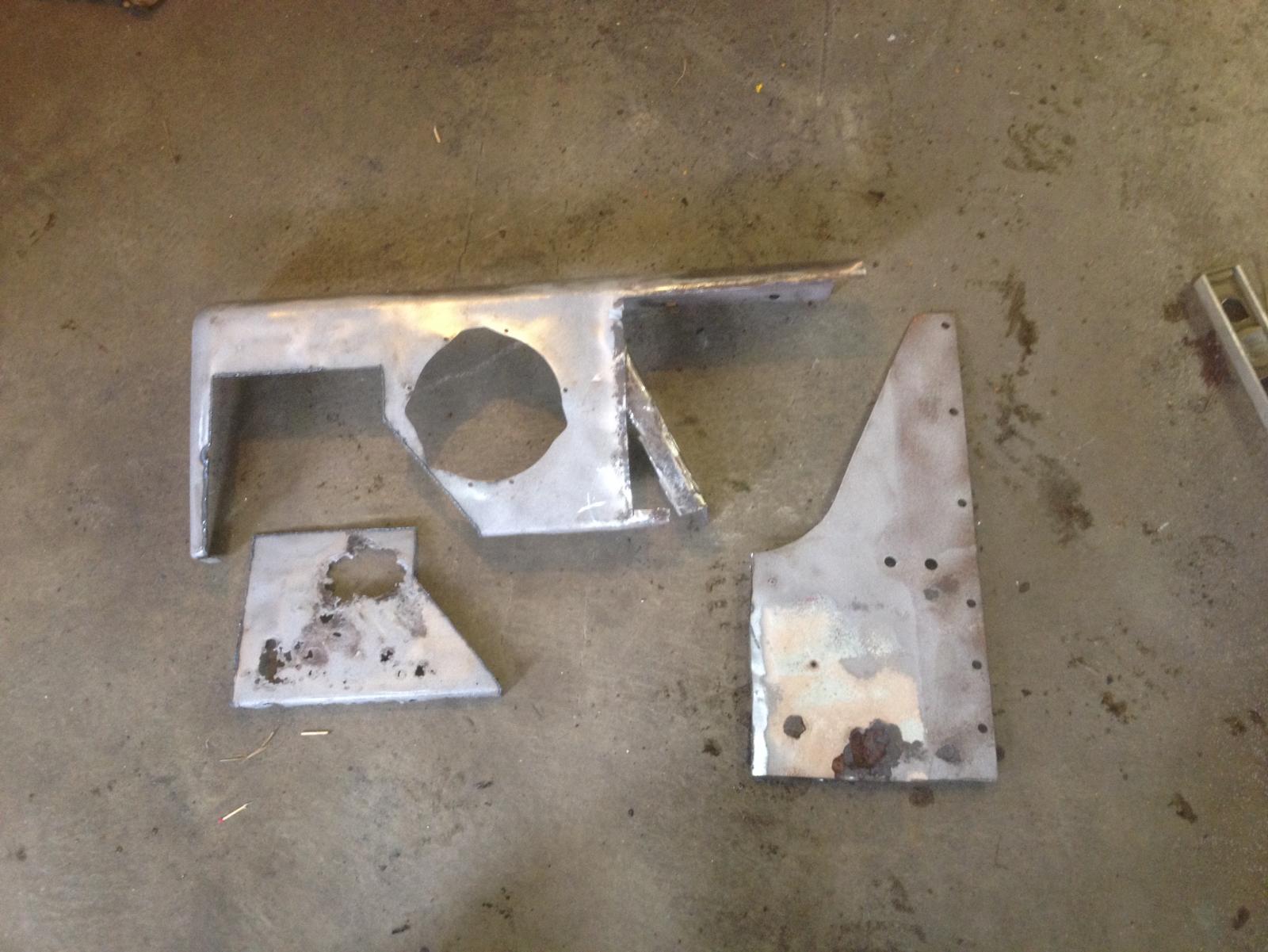

I spent some more hours cutting stuff off and up. I have almost two of everything and none of it is good enough to just clean up and paint. I have a bunch of items that if I take half of each of the pair and weld them together I'll have a good piece. I see a lot of cutting and welding in my future. It's almost funny that the top of my original is solid and the bottom rotted off and the exact opposite for the other parts. No complaints though. I'm having a blast.
I hope to sand blast the parts up and start making good parts piece by piece. I'll prime them all up as they are completed and get them ready for finishing and paint. It is amazing how much extra stuff there is on the truck. I pulled a pile of stuff off that was added for one reason or another along the way. I ordered some sheet steel and some small angle irons to patch up the nose pieces. They are all either rotted or torn from abuse along the way. I have a good plan to make up some nice pieces as long as I don't run out of wire or welding gas.

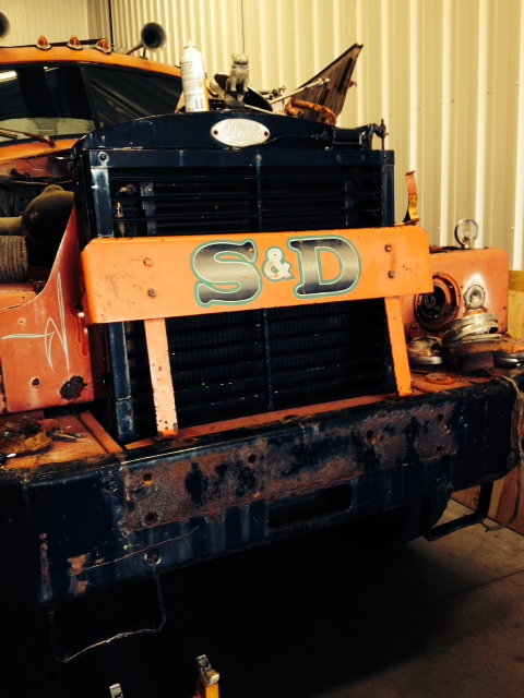

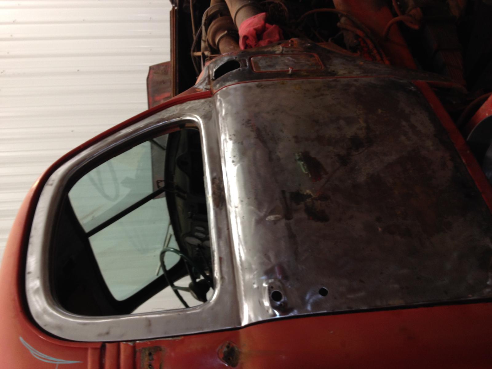

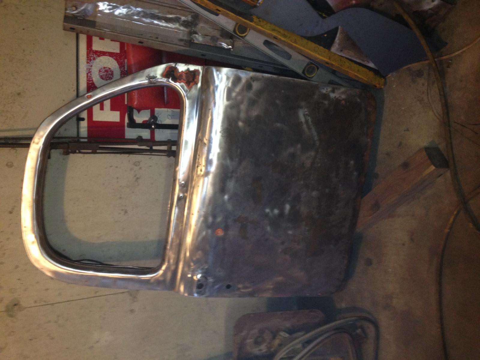

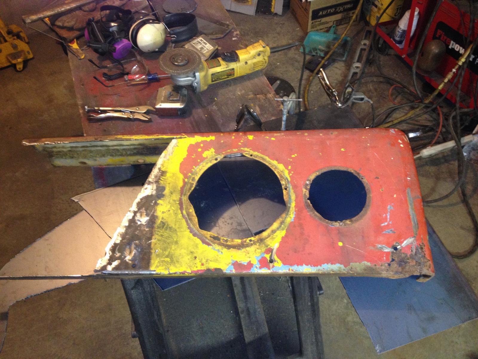

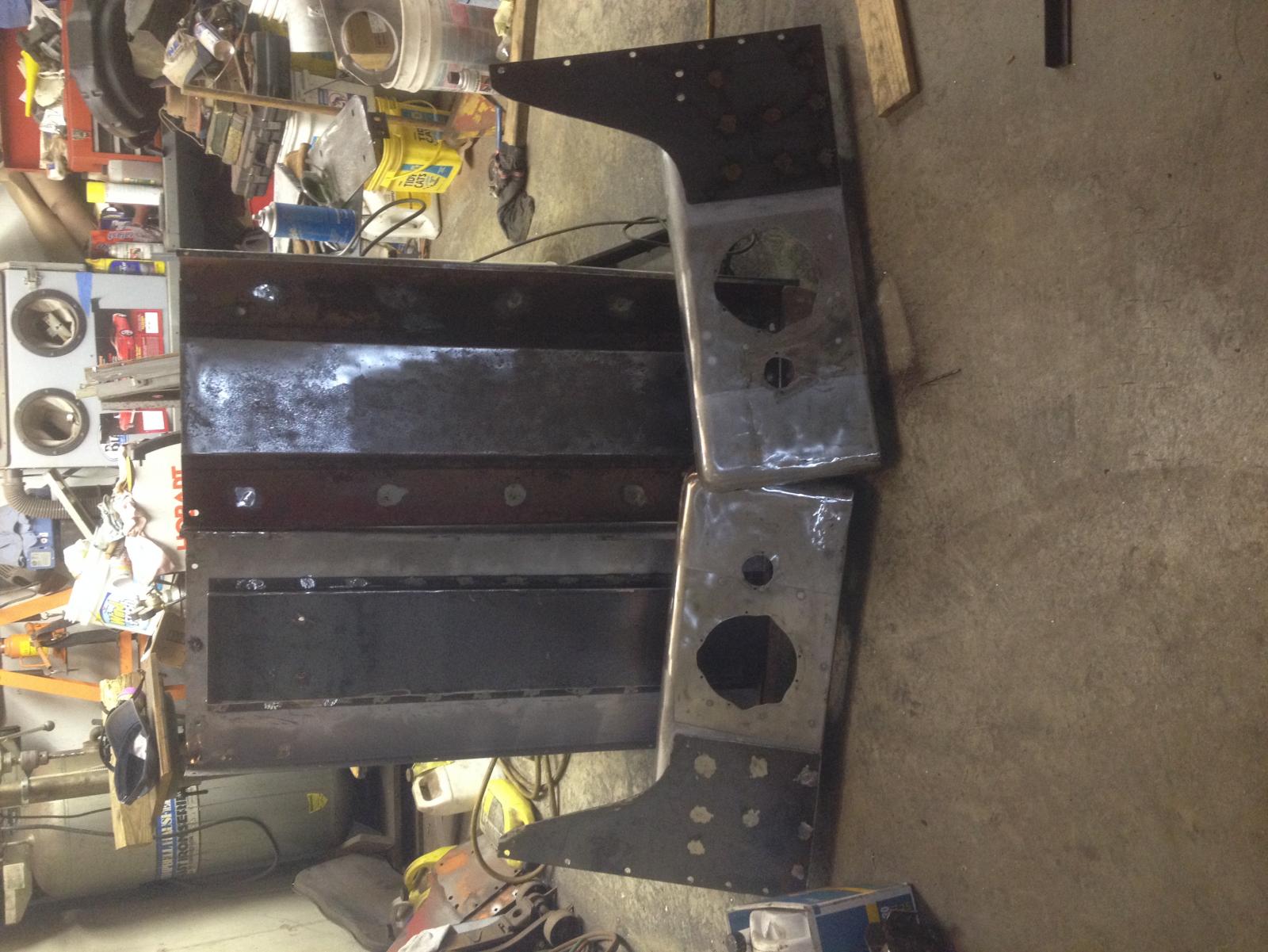

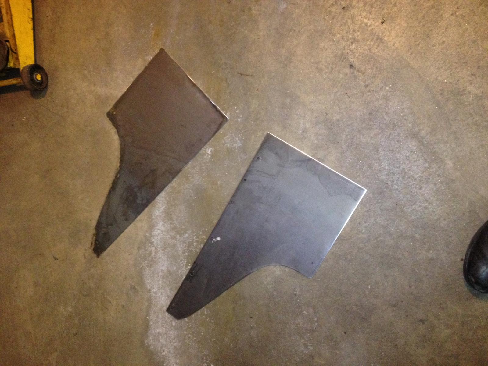

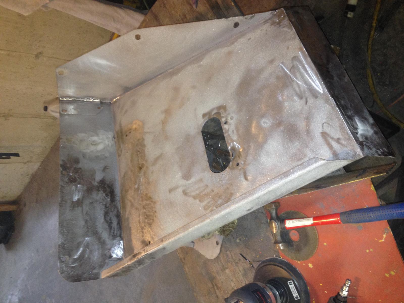

Some progress pictures attached. Hopefully I have a handle on how this works...The front end was all ripped or rotted but I've patched it all up with lots of fresh steel. I have parts off of three trucks and some sheets of steel in the works in these pictures. Making everything straight is a challenge as dents and twists are the norm not the exception. A bad day of this is still better than a good day at work...More to come.
