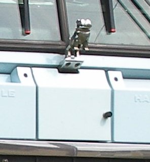

Ben - the MH uses a different mounting base then most other trucks (see pic).
I might just put my 1/2" impact wrench on the Bulldog screws and go for it. :angry: I will start with my HF POS and work my way up to the the BIG one! Something is going to give. giggle.gif
