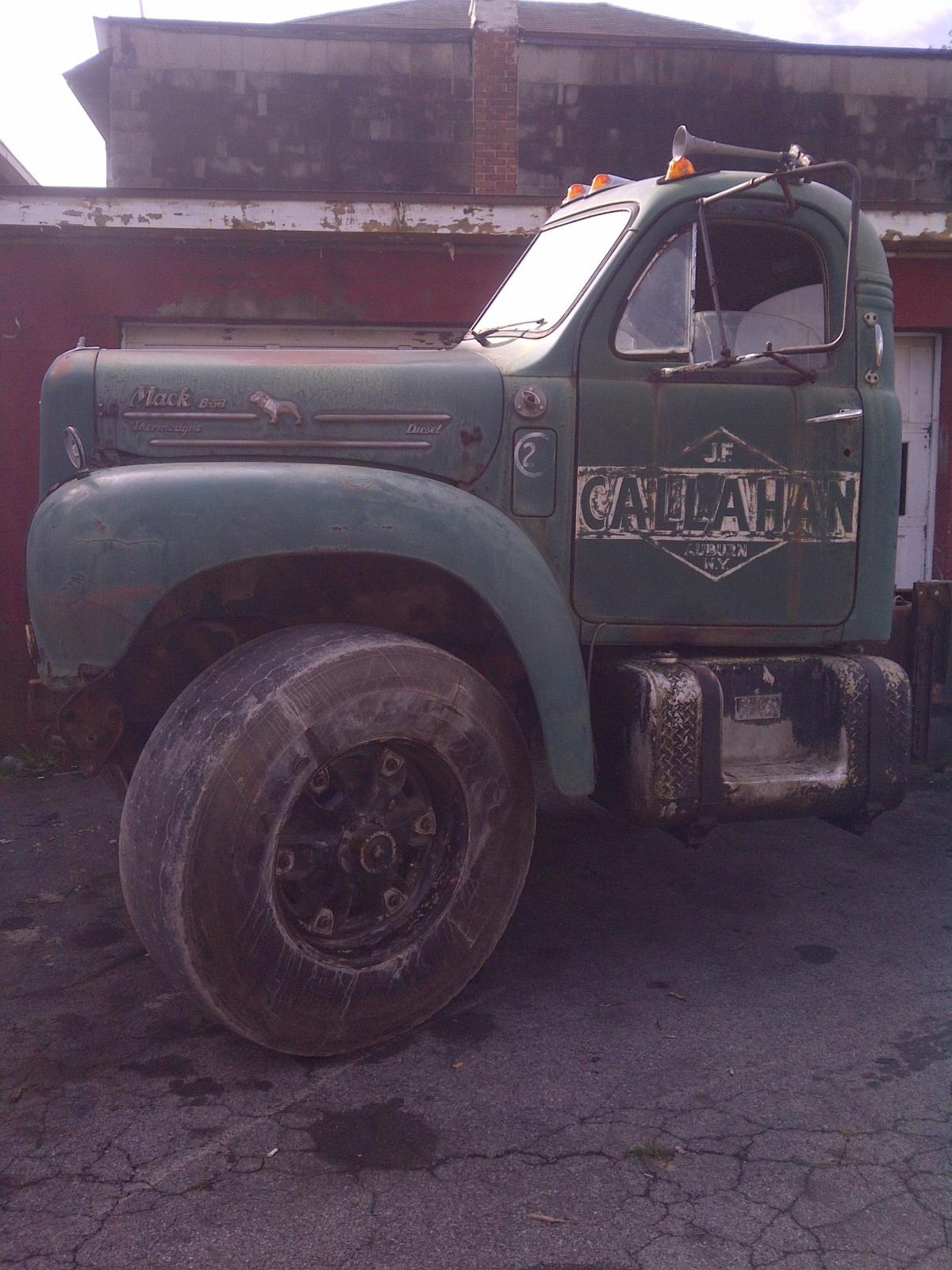

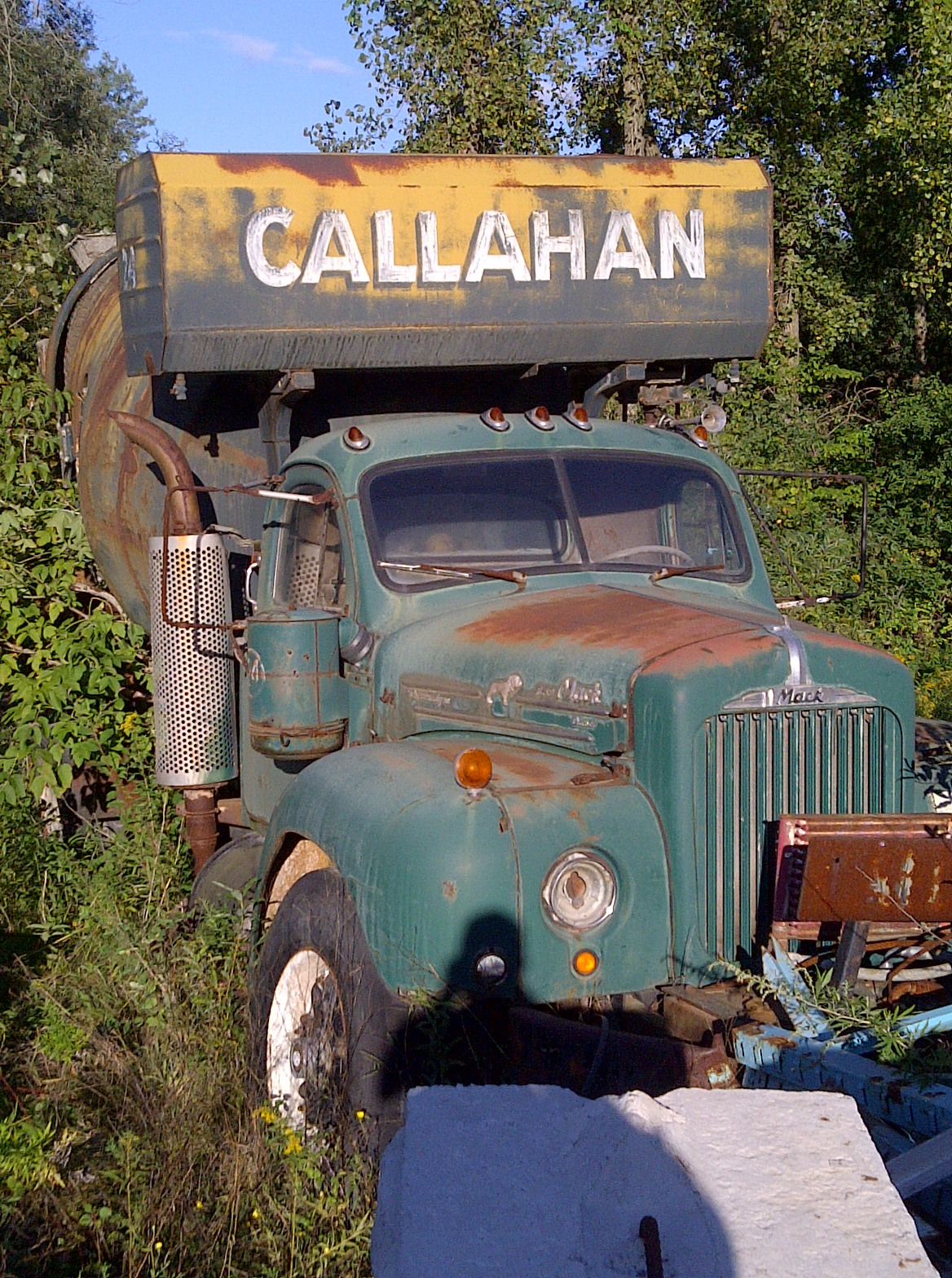

Is Callahan the company that worked out of the Auburn, NY area? I was born there (many moons ago, well not too many) and I think I remember seeing this companies Dump and Mixer trucks.
welcome to the site,,that truck dousnt look bad at all,,,rather than change all your starter setup,,mount a small air compresser pump,on a plate,and a small mower engine to push the pump,,that way u got all the air you need if you run out...would be allot cheaper,than changing everything...choice is yours..good luck.bob
Thanks for all the kind words! And Callahan concrete was a big outfit here for many years.

Welcome. I'd soak the starter unit in kerosene or diesel. After years of use the vanes (paddles) gum up. What did you do with the mixer unit? My mixer was parked in the late 60's early 70's with a full load.... Paul
