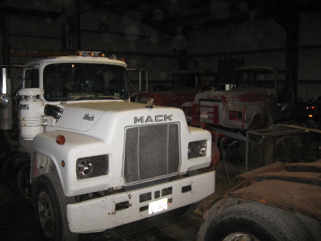

I get a call from a gentleman this afternoon and he is liquidating his father's estate and complying with the will in which I was named in, (for some reason). I don't immediately recognize the caller's name but when he tells me his deceased father's name, I immediately recoginize him and am saddened with news of the passing. His father is the person that gave the B67 to me. The reason for the call is the 1988 R model tractor that was a replacement for the B67 has specifically been left to me. Not having much to do in the shop today I grabbed up my shop helper, drove up, conversed for a bit, then drove the tractor home.

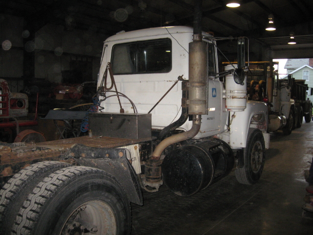

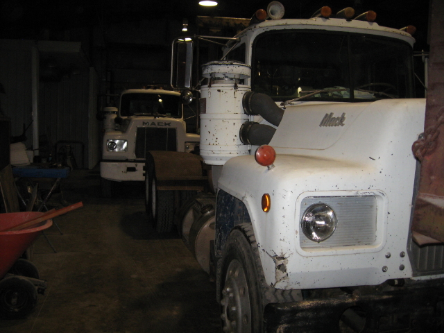

This runs like a top but is underpowered bobtail. I think it needs a turbo replaced due to smoke and lack of power. Seems like it hasn't seen a shot of grease in eons either. Something seems to be going bad in the 10 speed Mack trans also. It is damned hard to pull out of 7th, and 8th gear on the upshift but the power band is smooth. My helper was driving almost 75 mph to keep up with me when I had the speedo pegged on 55 mph. I know the truck was built with a Mack five speed and he had the 10 speed installed. It is a triple countershaft trans but must be a newer series than my old ones as it looks different and has casting letters denoting a "wet clutch". Never have seen something like this before but I'll prolly get a look at the guts to see what is up. The shift pattern is tight and the shift handle is solid through the power band. A very quiet truck with rear taperleaf springs, and air ride cab that bounces like a basketball, (needs shocks). Hell this thing rides so good I'm going to follow Trent's lead and call Phil for parts to convert one of mine.
Here are some photos.
Rob

Nice gift. Something strange with the trans. The five speed would have been a T2050 (.6 OD) and the ten speed T2010 (.78 OT) should be slower, not faster.
I say it looks like a Mack trans but I can't be certain. It does have an eight bolt PTO on the left side, and a six bolt cover on the right side. There are definately 10 gears as sixth gear is to the seat and down just after you pull the range selector up, and it has three countershafts.
The trans is dirty and can't be investigated for numbers until it is cleaned. The truck was used for private low boy hauling, and farm harvest. I also don't see any rust as it's always been stored inside.

Scraped off some of the dried "goo" on the left side of the transmission and it is stampedT2100. It also has a dry clutch but the aluminum casting has raised letters stating to use ATF as the fluid for one of these things. The round, raised boss would be bored and threaded with a plug if it were a wet clutch.
Found a busted tube on the CAC and several tubes that are bent shut. Looks like impact from following a tractor or combine too closely during harvest. The radiator core while complete, is weak although it doesn't leak. The engine really smokes black when accelerating and shifting gears and makes almost the same power as my 58 B61 with a 170hp engine, LOL.
Also discovered the rears are 4.17's and it's on 11RX22.5 radial rubber.
