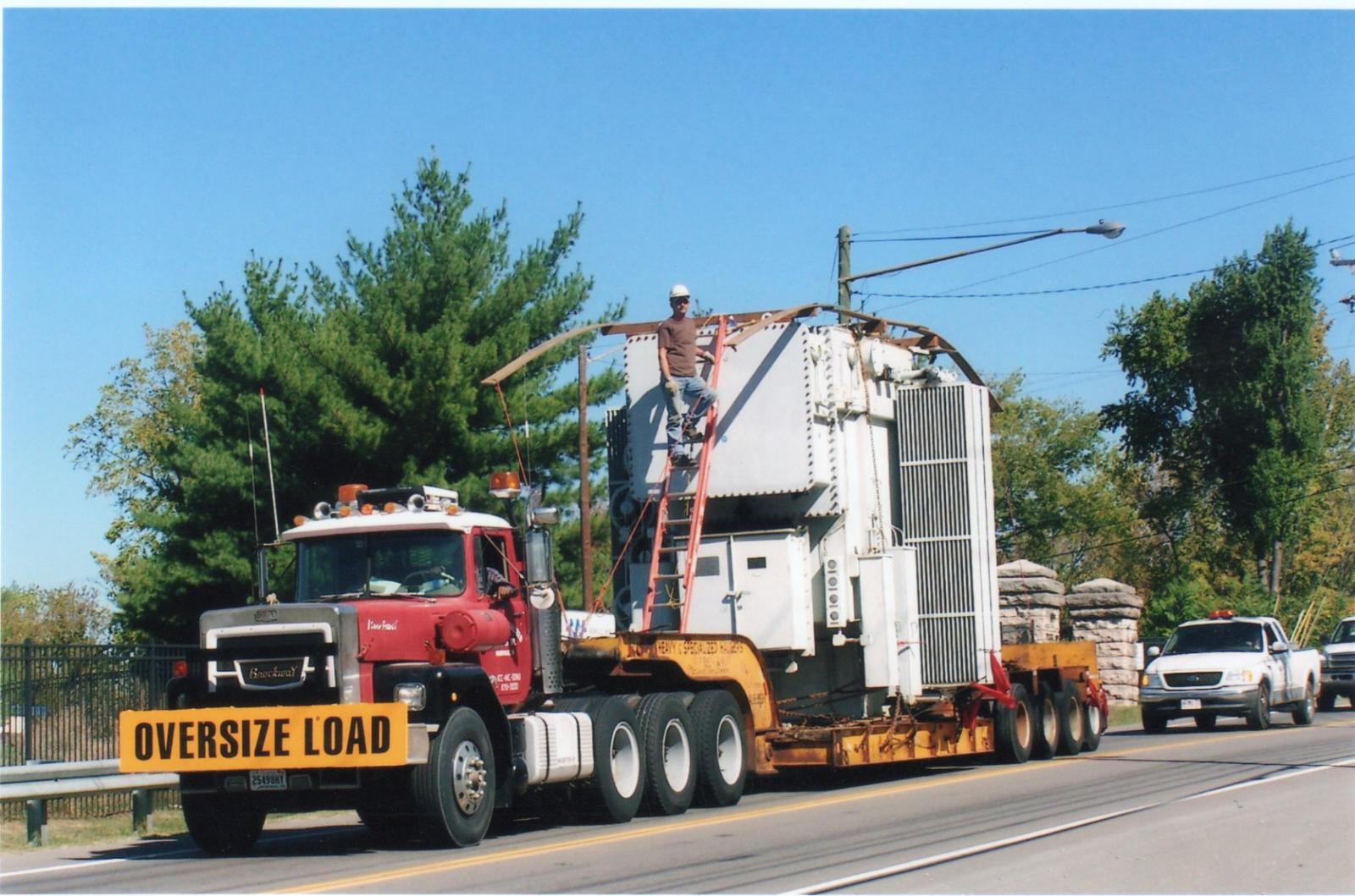

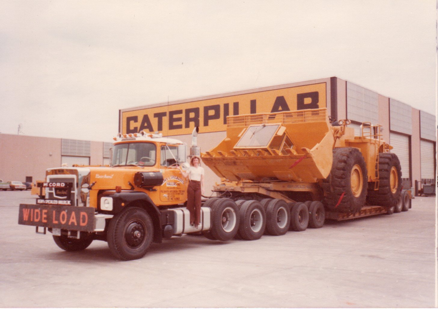

Here's one that a local heavy hauler had. When they went out of business, I tried to buy it but I think it went for over $40,000.
