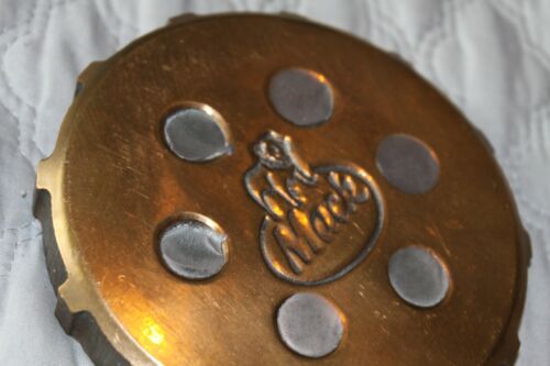

  9. I just picked up this fuel cap on ebay that I've never seen before. Its a 4" brass non-vented with the Mack emblem on it. Any idea what it would've came on? All the non-vented 4" caps I saw on 80's vintage Macks had no logo on them.
