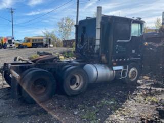

I've seen worse looking undercarriages on fire trucks around here from the mid 80's. Look at the rear springs, there's absolutely no rust jacking in the stack. Definitely looks like it can be saved. Is most of the stuff still in this junkyard that can be seen on google satellite images? I'm less than an hour away but never heard of the salvage yard before you started this post. I'd like to take a look at what else is there one of these days if thats alright.

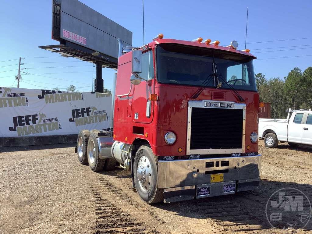

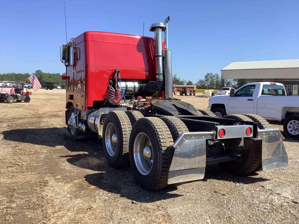

No affiliation, 11/12/21 auction in Mississippi. 1979 Cruiseliner 350, 10 spd, Neway. Appears to be a Schwind repainted red. https://www.proxibid.com/Commercial-Trucks/Truck-Tractors/1979-MACK-CRUISELINER-VIN-WS712LST44065-TANDEM-AXLE-TRUCK-TRACTOR/lotInformation/64745869

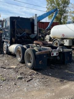

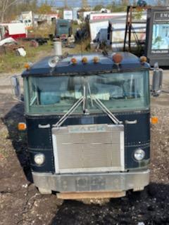

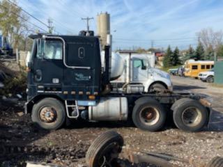

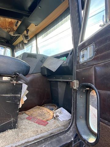

No affiliation. Located in Depew, NY (Buffalo-Niagara) at Casey's Truck Salvage. 716-681-0750. Called about it and they sent some pics, asking 5500, down to 5000. Did run, listed as project. More than I need to spend right now having just got my Superliner and it doesn't have the "Western" themed interior. These are getting rare since not many people have saved them from scrap, never more than 1 at any show I've gone to. 330 tip turbine, 10 speed roadranger, 38 rears.

Last picture is whatever used to be fuel that I got it running on. The worst rust of all is shown in the back of cab pic. Found an inspection receipt from 2005 in the truck and its less than 700 miles from the current mileage. All documents and tags I've found expired in '07
