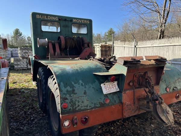

  1. They have the dimensions listed in the ad as 30x10.5x10. Makes it tough to move around just going to shows.
  2. https://westernmass.craigslist.org/hvo/d/westminster-ww-mack-prime-mover/7474623774.html
  3. No connection, craigslist ad in Gardner, MA 707 gas, neat looking piece.

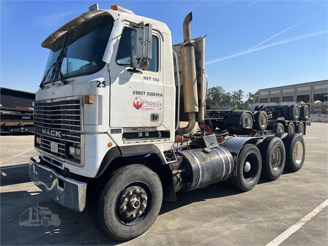

  13. No association, it looks like its been through hell but still a cool truck. I think it was on truckpaper a few years ago in much nicer shape. Can't be too many like this. https://www.truckpaper.com/listings/trucks/for-sale/212844179/1991-mack-mh613

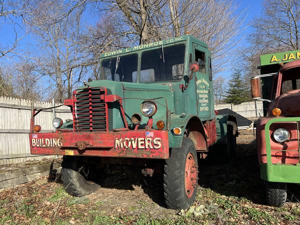

  17. Wow, you're absolutely right. Exactly 10 years ago. Titled "couple pics for Vinny" of all things. They've devolved a bit since then. The 2 that appear only as bushes today on Satellite images had buckets on the stacks 10 years ago. The place was a bit more active back then and it seems there are even more there today.
