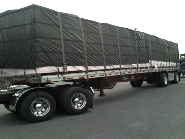

Alot of the local steel hauling companies are converting over to curtains. Don't have to worry about a guy falling off a load while throwing tarps. Doesn't take but a minute to slide it forward/back and lock it down. No bows/side kits to mess with either.
I'm sure there are downsides, like wear/tear, but think it's a pretty good set up from what I've seen. Had a few deliver here at work and got to see it first hand. Usually the rookies get tarps, the vets get curtains.

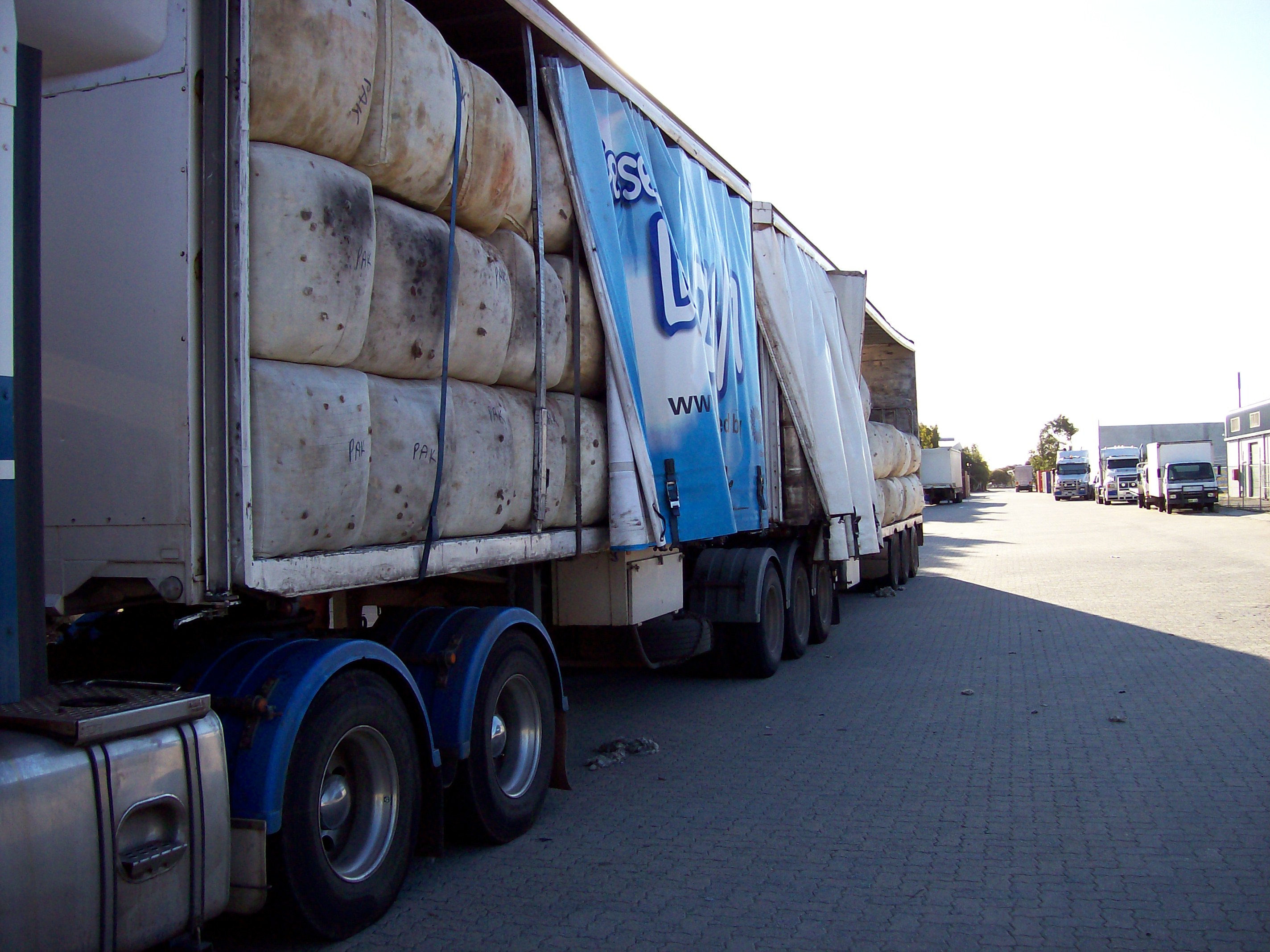

Hello, we have lots of Tautliners down here, we load every thing from the wool bales in pic to amonium nitrate bulka bags for the minesites to just general freight! they normaly have gates inside the curtains however in this pic I have no gates up as the wool bales are like hauling a beached whale and dont fit inside the gates! I hate the things, the curtain rails are never maintained properly and they stick.
in this pic there is 220 bales of wool on this load, I was heading to Melbourne from Perth with a GCM of 62tons I was leaving perth around 9 to 10 pm on tuesday nite and ariving in melbourne midnite thursday nite to unload friday morning, melbourne is 3600kms away from perth. the wool allways shifts and moves and your forever retensioning straps.
Grant

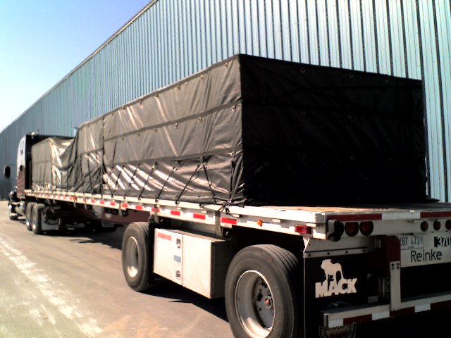

Well Rob I still do it the good ole fashion way. However I would love to do it the conastoga way. No matter the the fellas with the side kits only have me beat by about 20 minutes unless the load is seriously ugly in that case there is lots of cursing and thinking going on under that little black hat.
matt
