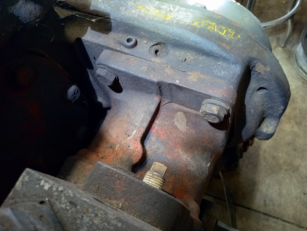

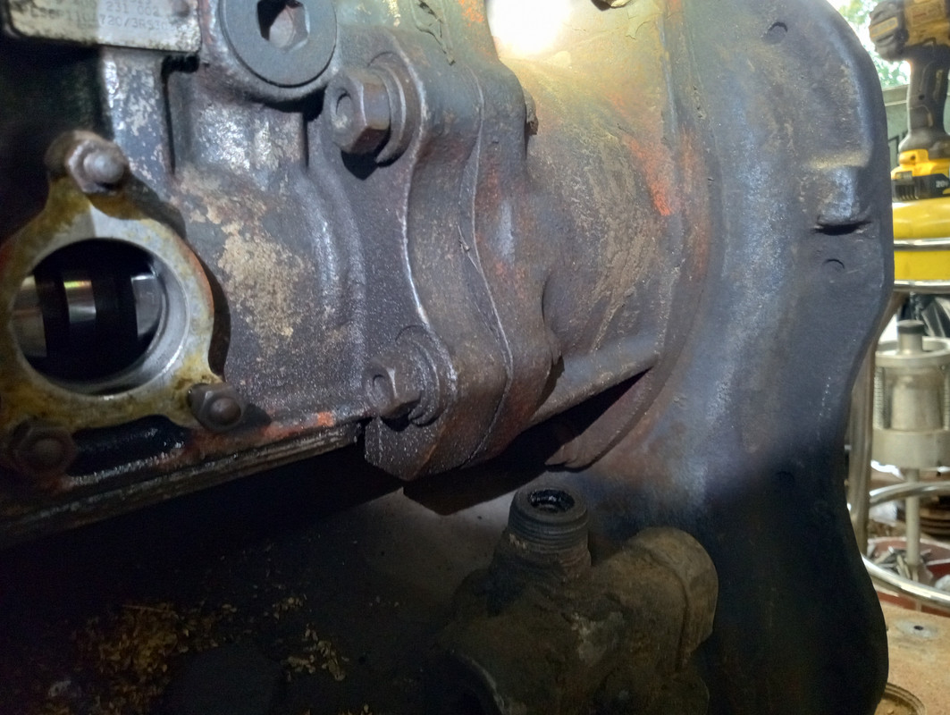

No pins.  You can see the color differences in the three parts so someone has been into it.
The three bolts into drive looks solid,the four on pump look like they may "swivel"?  Should I just pull front cover plate to see gears?
Larry
The slotted adapter with the pins is when you take the two top bolts and one bottom out that bolt to the block. You have a pic of the top two.  terry:MackLogo:
