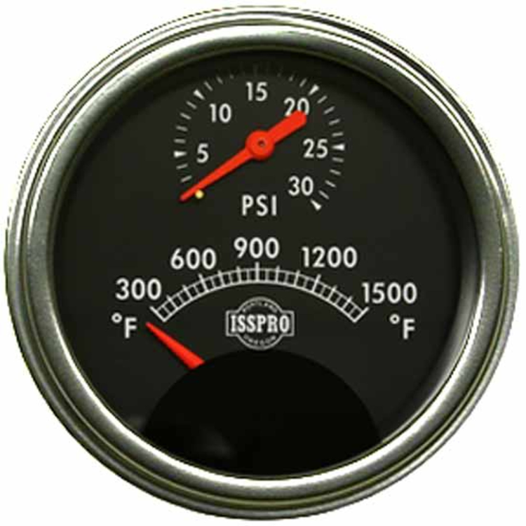

I like that gauge Larry. However, like everything else these days, can't find one anywhere on the net. I swear, 15-20 years ago whatever you wanted just type it in and up it would come. Now, search engines are so screwed it doesn't matter how vague or specific a description I type in I get page after page of shit that isn't even related to what I am looking for. "No problem" says my internal "common sense" "I'll just go to the company web sight". I can not remember that last time I went to a company/business web sight that was the least bit user friendly or useful. I can't believe that companies actually PAY people to create these worthless webpages. Now, to be fair, after wasting an hour searching for something and coming up empty, I usually tell my wife what I am looking for and within 5-10 minutes she finds it. I ask what she typed in and it is ALWAYS the exact same thing I typed in word for word but the sights/pages that come up for her don't come up for me. Probably why I am so happy to drive my model A fords and will be happy to drive my B-61 Mack and any vehicle with an ECM is to me like sunlight is to Dracula. THESE things I understand.

And yet, after spending about an hour searching for that gauge with no luck, I showed the picture to my wife and in 5 minutes (literally) she found it. What REALLY baffled me is that she found it on a sight that I had been to and did not find it there. Unfortunately for me, turns out it is a 3" gauge and I need 2 -1/16" so as cool as it is, it doesn't fit my needs. That and it is $340USD which would be $466CAD plus shipping so about $500CAD so....that is a hard NOPE.
That's why I put it where the ashtray used to be.  Wouldn't fit anyplace else.  I've seen old trucks with a pyro mounted to a piece of alum drilled to the dash.  Cobbled up, but typical for an old truck.
I found it on Isspro website but can't recall where I actually ordered from.  Yes, it was very pricey, but gave me both gauges.
I had wondered why you located it there but now understand. One of the trucks I have had a 3" pyro mounted below and between the two gauges on the left where the engine operation plaque was. It is the same cluster panel that had a 4th gauge added to the right side but put it slightly inboard of the one above to clear the lighter.
