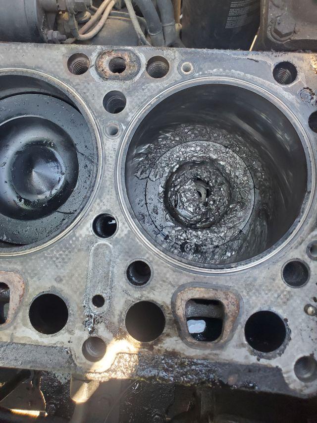

I finally got some spare time to start pulling this head off  So far I have been able to get all the bolts etc and being 2 piece manifolds only needing to pull the back half.  Did pull the entire exhaust though.  Only thing I can seem to get loos are the hard fuel lines from the pump to the injectors.  Got the injector end no problem but the pump end won't budge and don't want to round off the nuts.  It doe look like I can snake the head off being the lines do have a fair amount of movement.
I know I have problems with #4, but when I pulled the exhaust manifold I had oil run out of both 4 & 5 ports. Ports 1 - 3 look good, dry and just black soot so it look like I'm dealing with just the rear head.

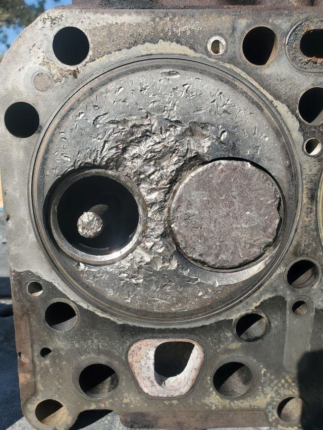

I was actually able to tie the injectors tubes back no problem and lift the head straight up and off the dowels.  They are in good shape.  #4 piston is destoryed but no surprise there.  Going to take head in to machine shop to see if they can rebuild.  I know right off hand after inital inspection that it will need 2 valves, exhaust valve guide and seat and an injector.
I am thinking that this damage wasn't necessarily caused by valve float. Leaning more to the fact the valve spring keeper broke, still probably caused by overspeed on engine, which allowed the exhaust valve to drop and strike the piston and break.  Just my thoughts.

Got the head off. Goping to take it to the machine shop and have it check.  Needs at least both #4 cylinder valves and at least one seat and valve guide & an injector..  Piston is destroyed.

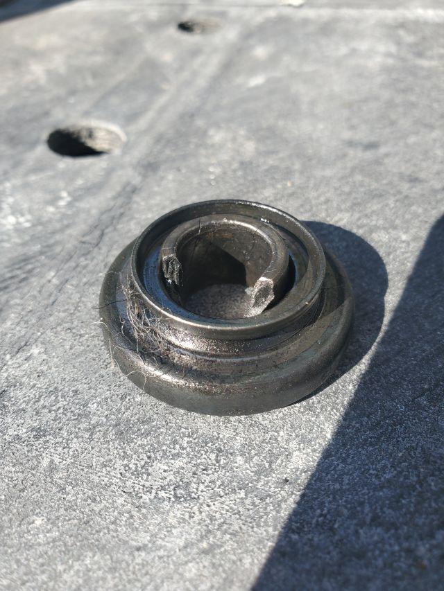

Pictures? Important to know WHY it happened, was the spring break a result of the collision or the cause?
My machine shop agrees with what I feel was the cause. Keeper broke and caused valve to drop and hit piston.  From wear marks and the way the keeper broke it appears the valve stem wore to the point the rocker was hitting the keeper resulting in it breaking.
Obviously the piston is destroyed.  Machine shop says if head cracked there is a company they deal with that specifically specializes in repairing cracked diesel heads. Not cheap but at this point my only option is to have this head rebuilt.

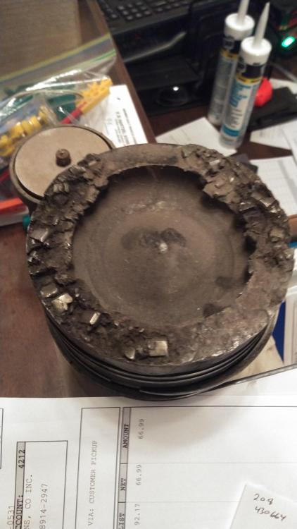

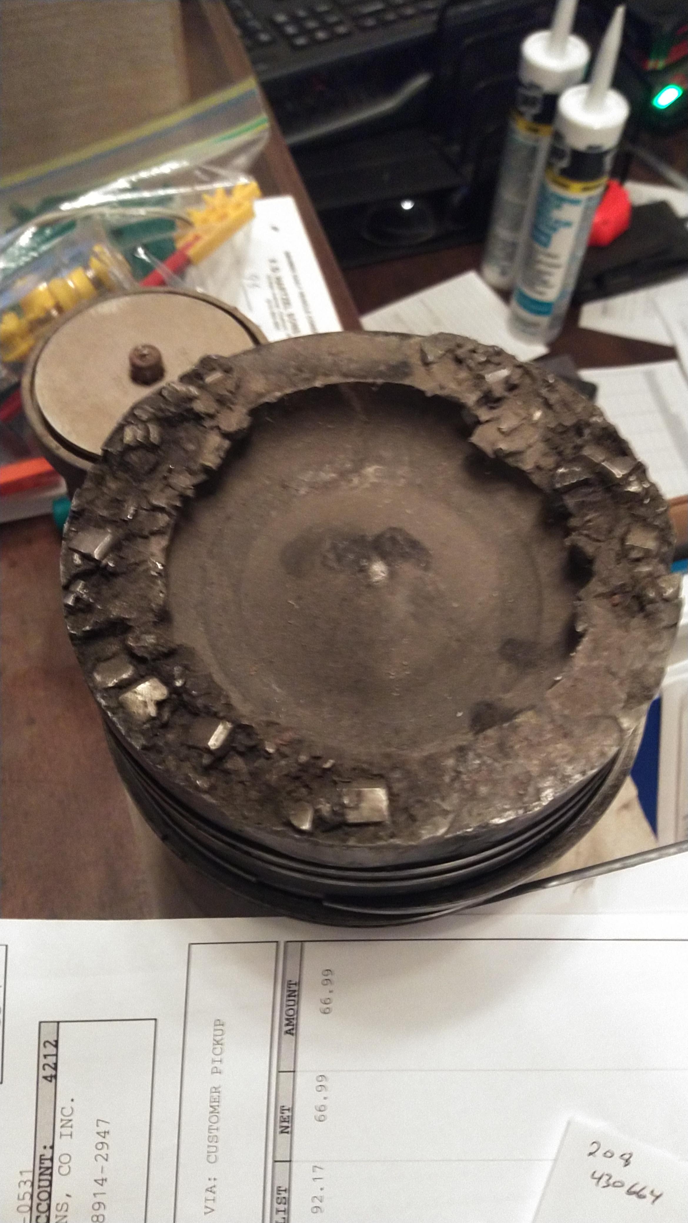

2 hours ago, JoeH said:
Wow that's some carnage. I'd say you need a head.
Here's a piston from my '79 R686 that dropped a valve seat. Bits of the seat are embedded in the piston.
