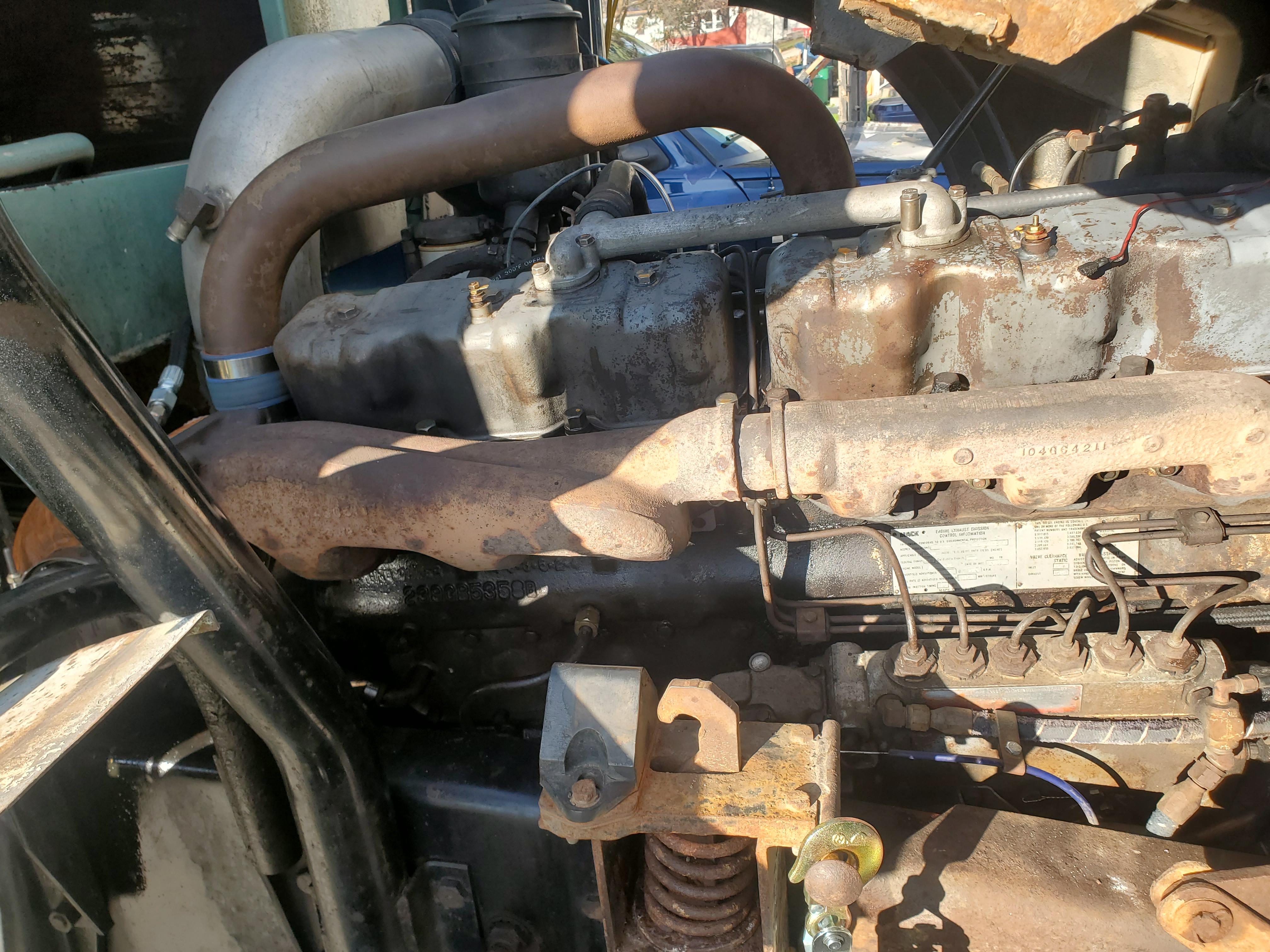

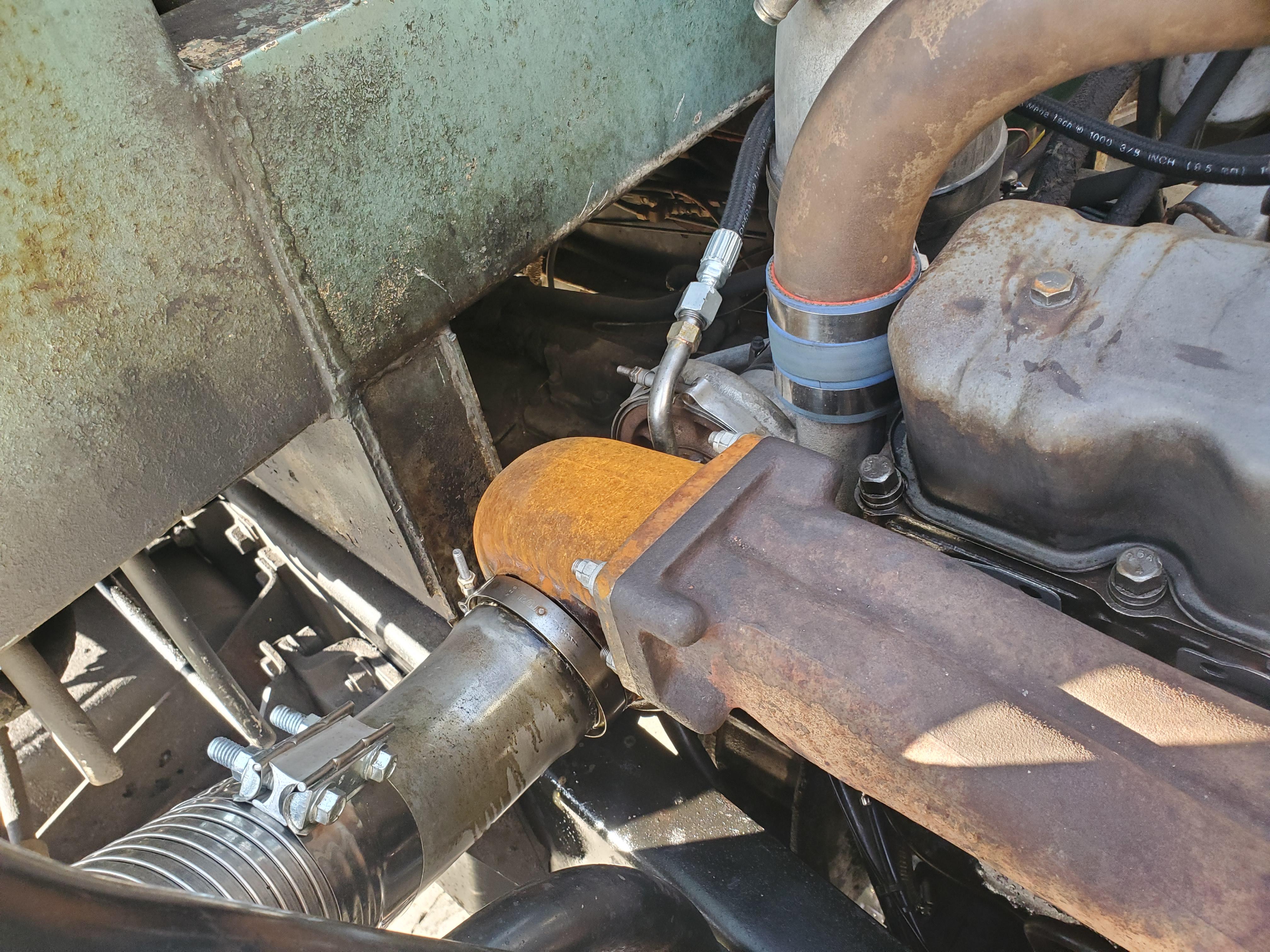

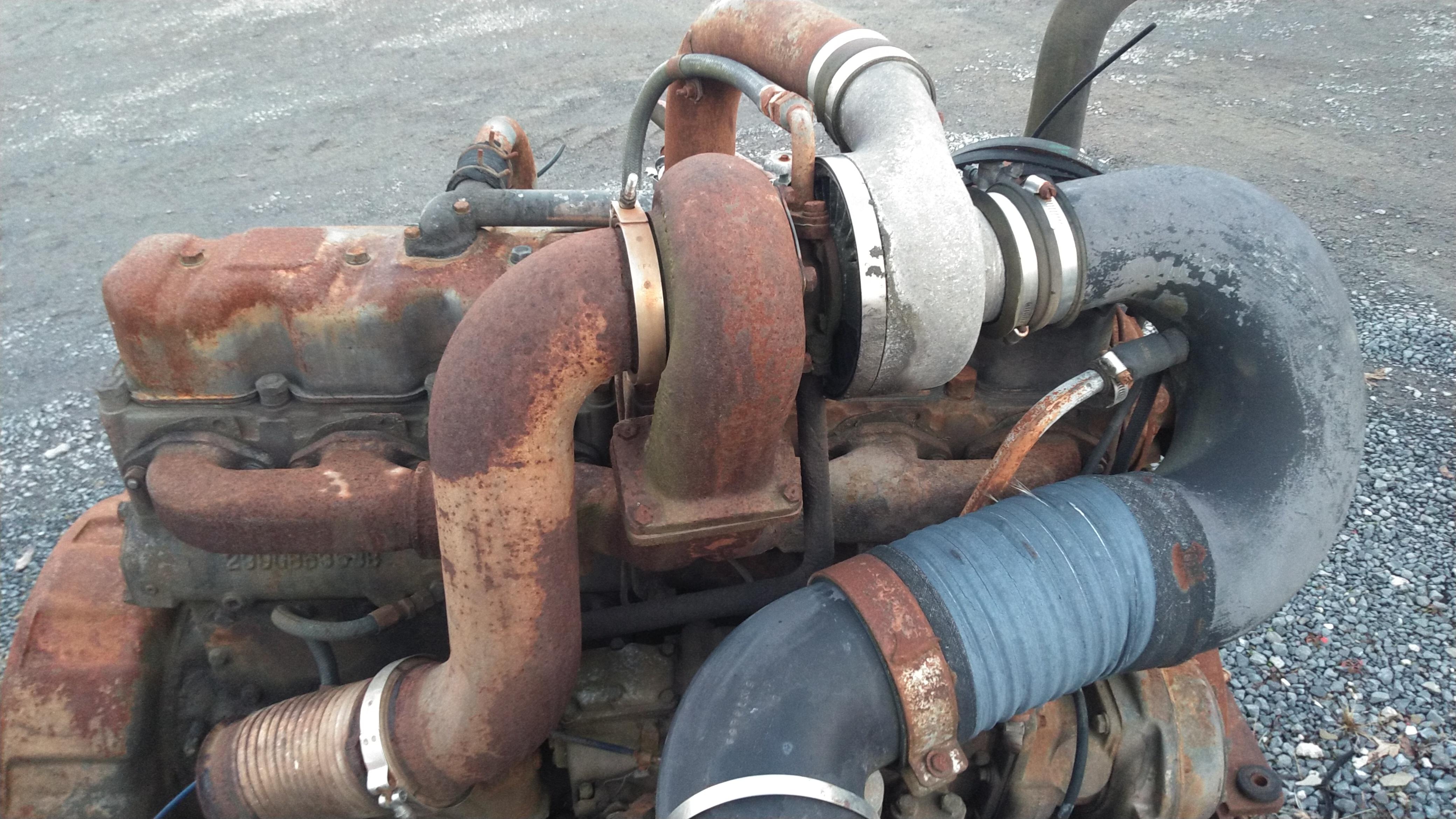

Can you post a picture of the exhaust side of your engine? I have 2 endt675 motors, one from a U model the other is in an R model. I think the exhaust manifolds are the same, but seeing yours will help me compare to the U model I have.

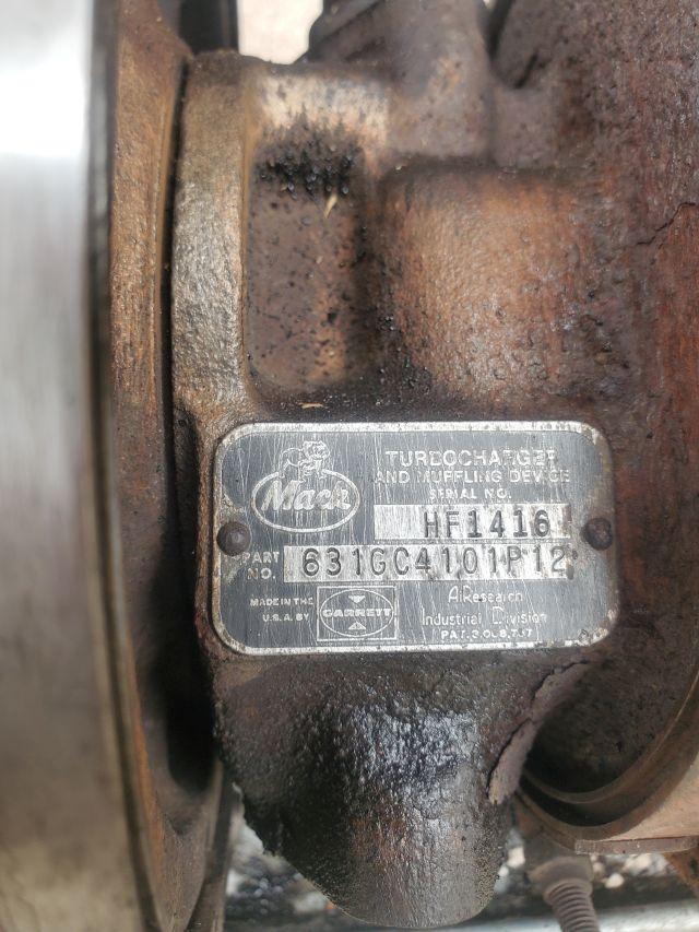

Took me a minute to figure out what that things in! That's a cabover, not sure what model truck.  Your exhaust is a different layout than mine.  There should be a tag between the two halves of the turbo. May need to crawl deep in there and clean it off.
