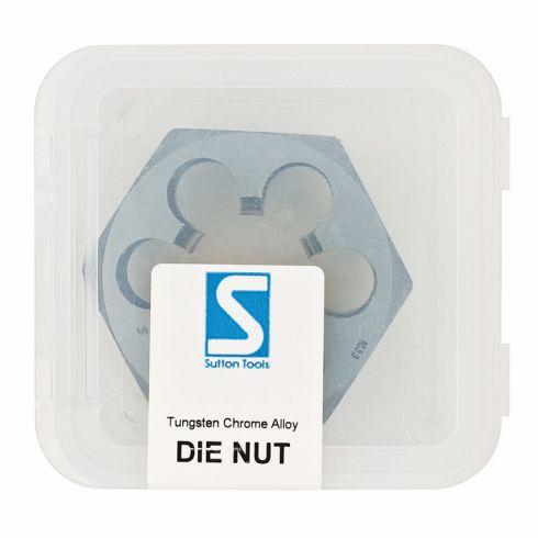

I find if I use a die nut instead of a die they work better, I feel a die is to aggressive and takes metal off the thread, a die nut sort of just cleans it up and pushes the thread back into shape rather than cut
You blokes might not call them die nuts, you use funny names like zerk for grease nipples
Imagine telling a shelia she gas zerks you could, oh never mind lol
Heres a picture of a die nut
They are only any good for cleaning up threads, not cutting them
Paul
we do use 'Taps and Dies' as well.  I have a thread chasing kit. They are less aggressive than taps and dies.  good for cleaning existing threads..  Gooday to ya' Paul..   Jojo
