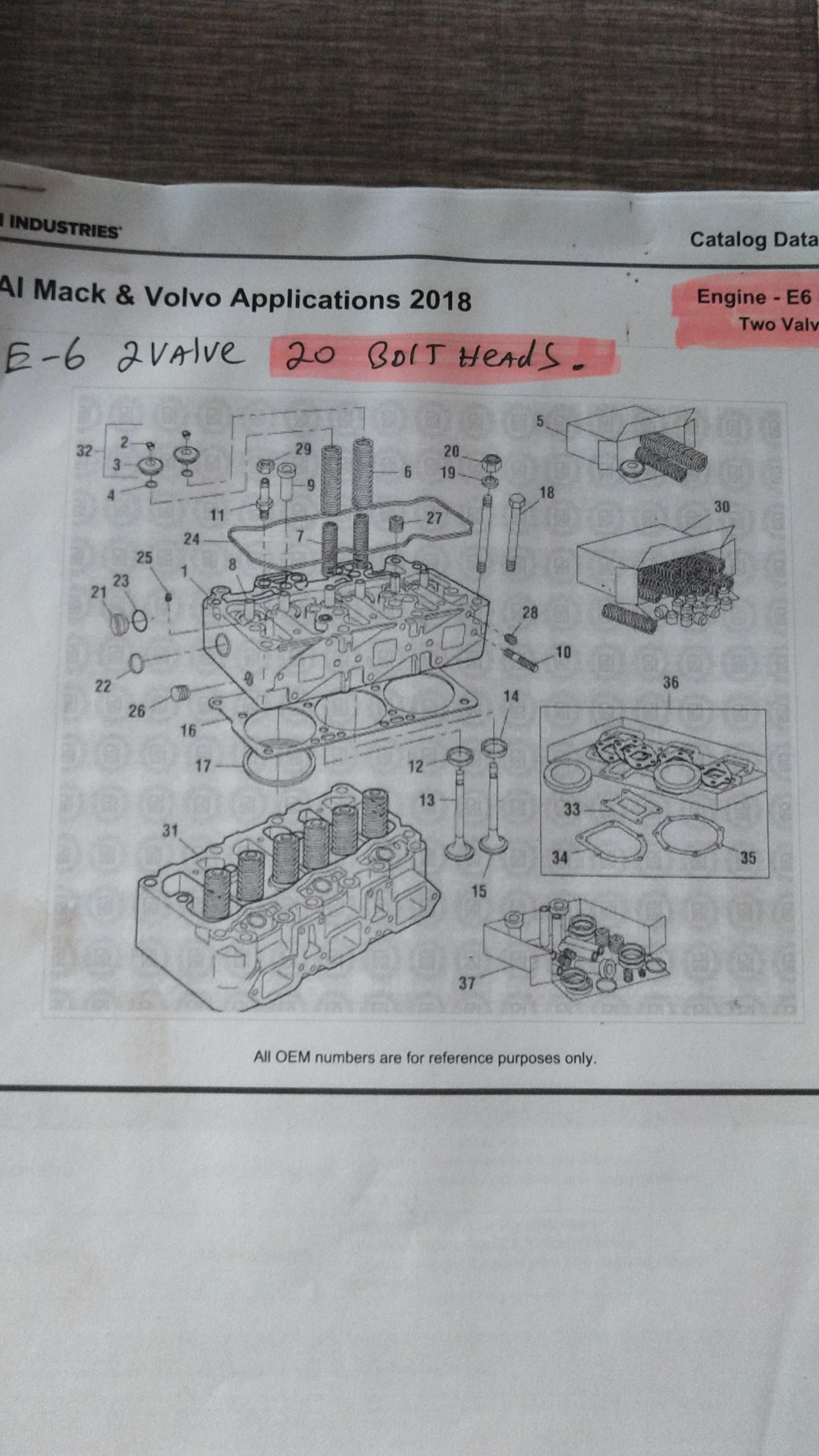

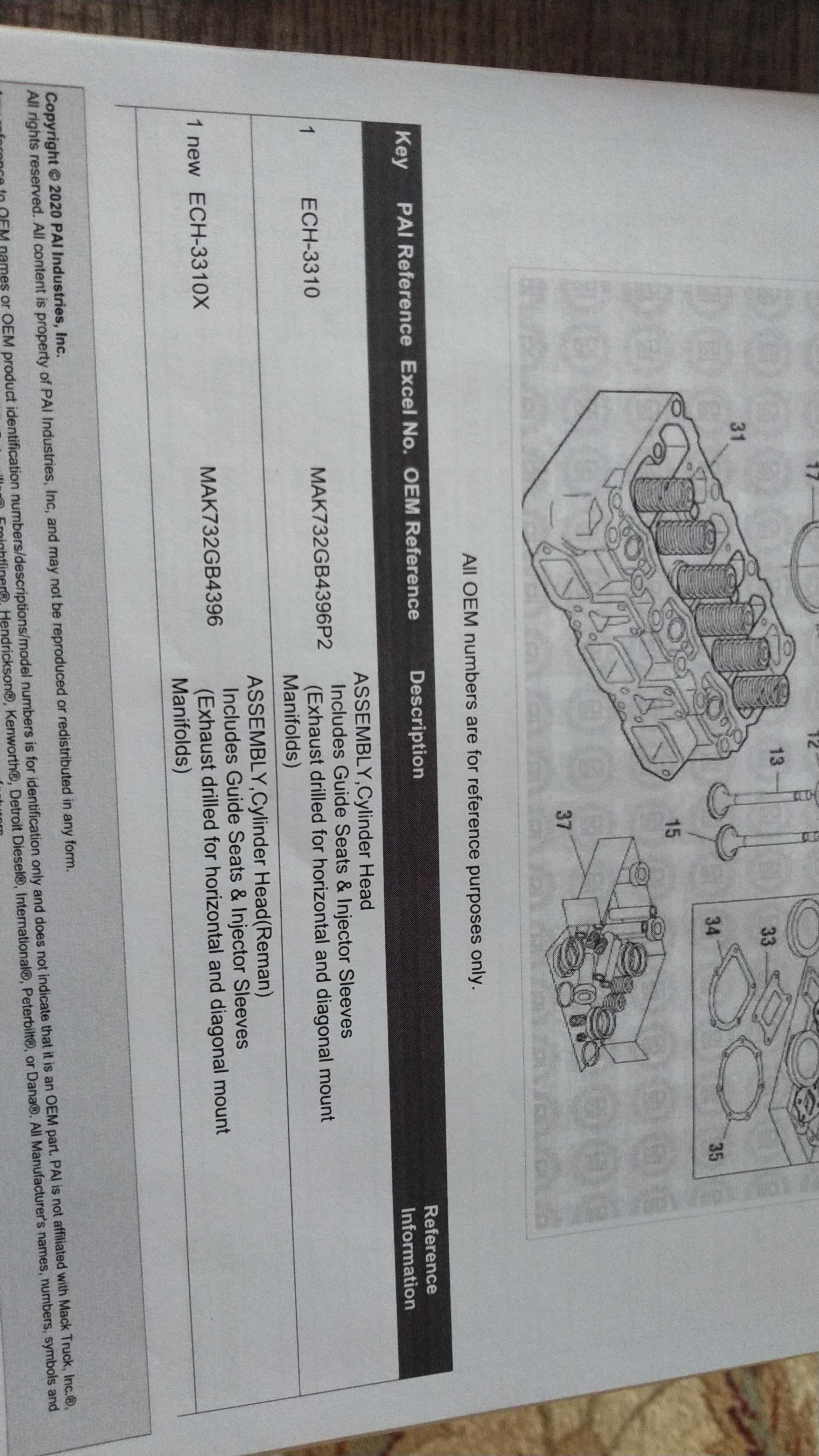

In my search for a head I keep hearing that it must be the same casting number as my head.  What is the difference between the casting numbers?  Anybody really know what heads will work?  I know there is a 4 valve and a 2 valve head and since mine is 2 valve it is obvious as to what I need there.
I may of found a core engine that the guy says matches my engine ID plate.  Says he will sell just the head, but if I want the whole engine I can do that also.  Limited info on this engine right now until monday as to whether it is a running core or not and I will also ask about casting number.  Engine is 90 miles north of me which isn't a big deal if I really want to go look at it.  Not sure how I will unload it off the trailer, but guess I cross that bridge when I get there.

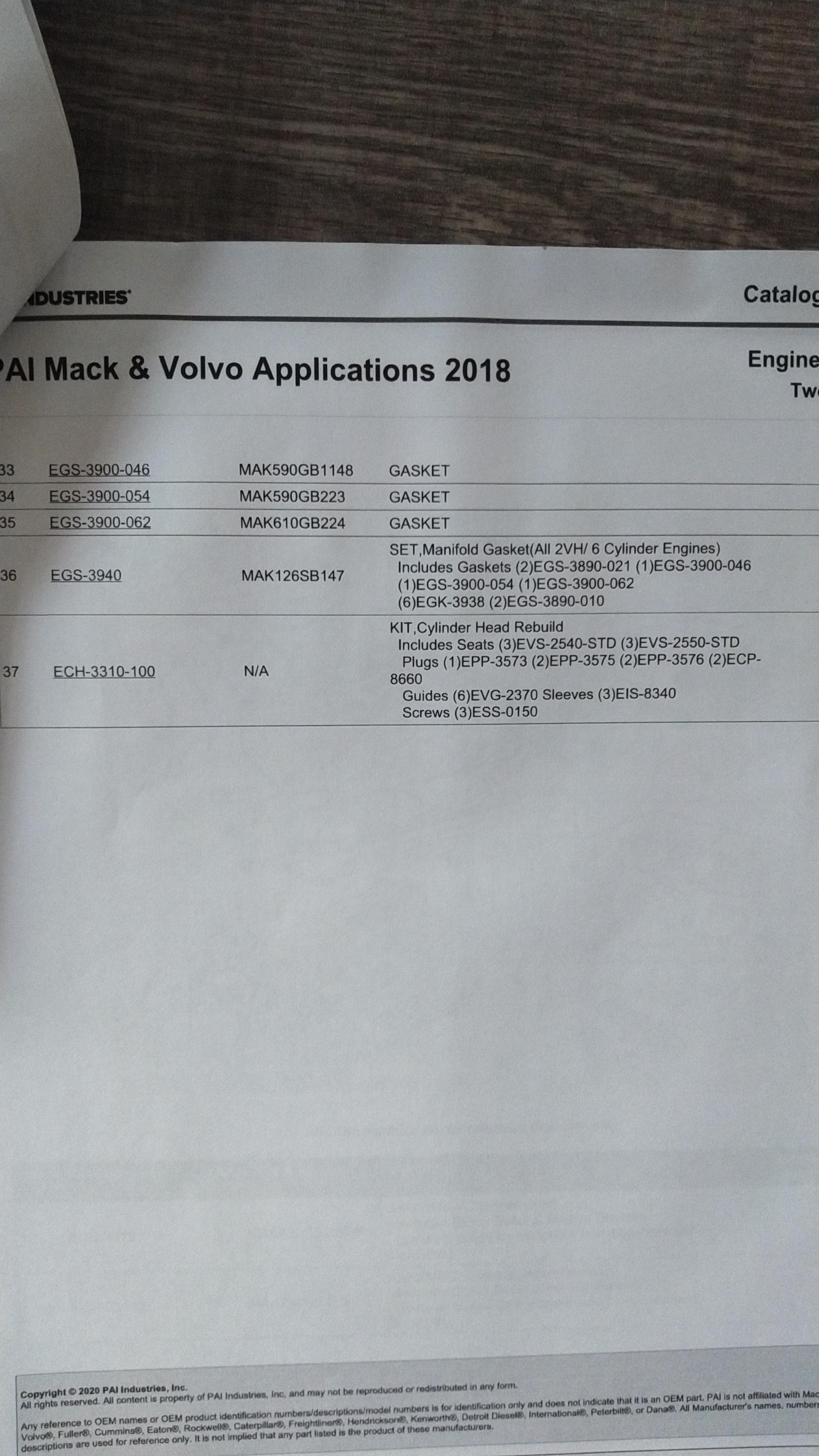

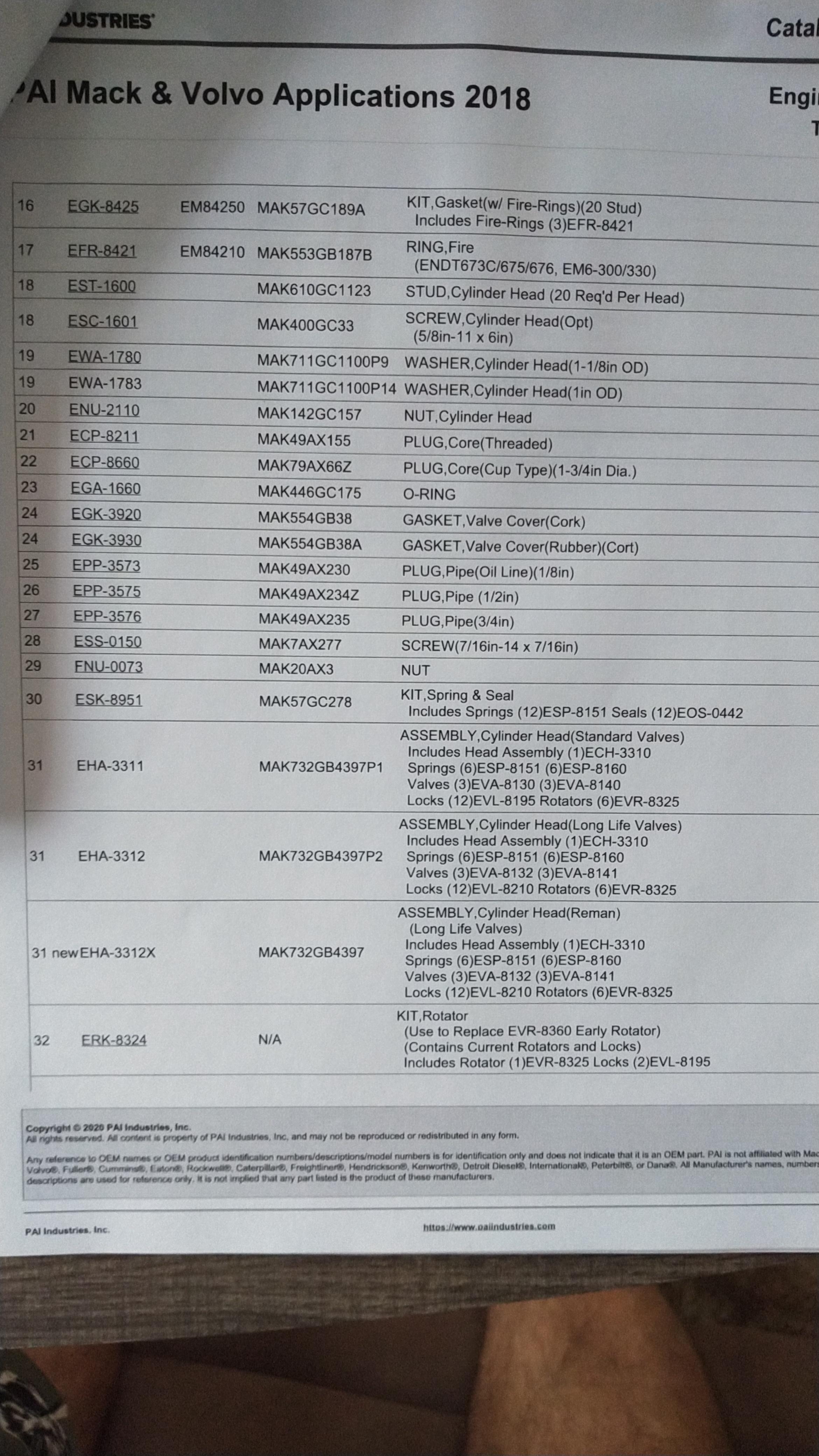

Also another question about sources additional parts.  I think I finally found the intake & water manifold gaskets and what looks like exhaust gaskets through AGKITS (which shows them as being PAI, but when my supplier was talking with them they couldn't find anything other than head gaskets.  Questions now is where can I find the metal nut keepers ( not sure what they are called) where you fold over the tab on the exhaust manifold.?  The gasket set doesn't show those.
I think but do not hold me to this that as long as it has the right amount of studs and is a two valve head off a E6 it should be okay

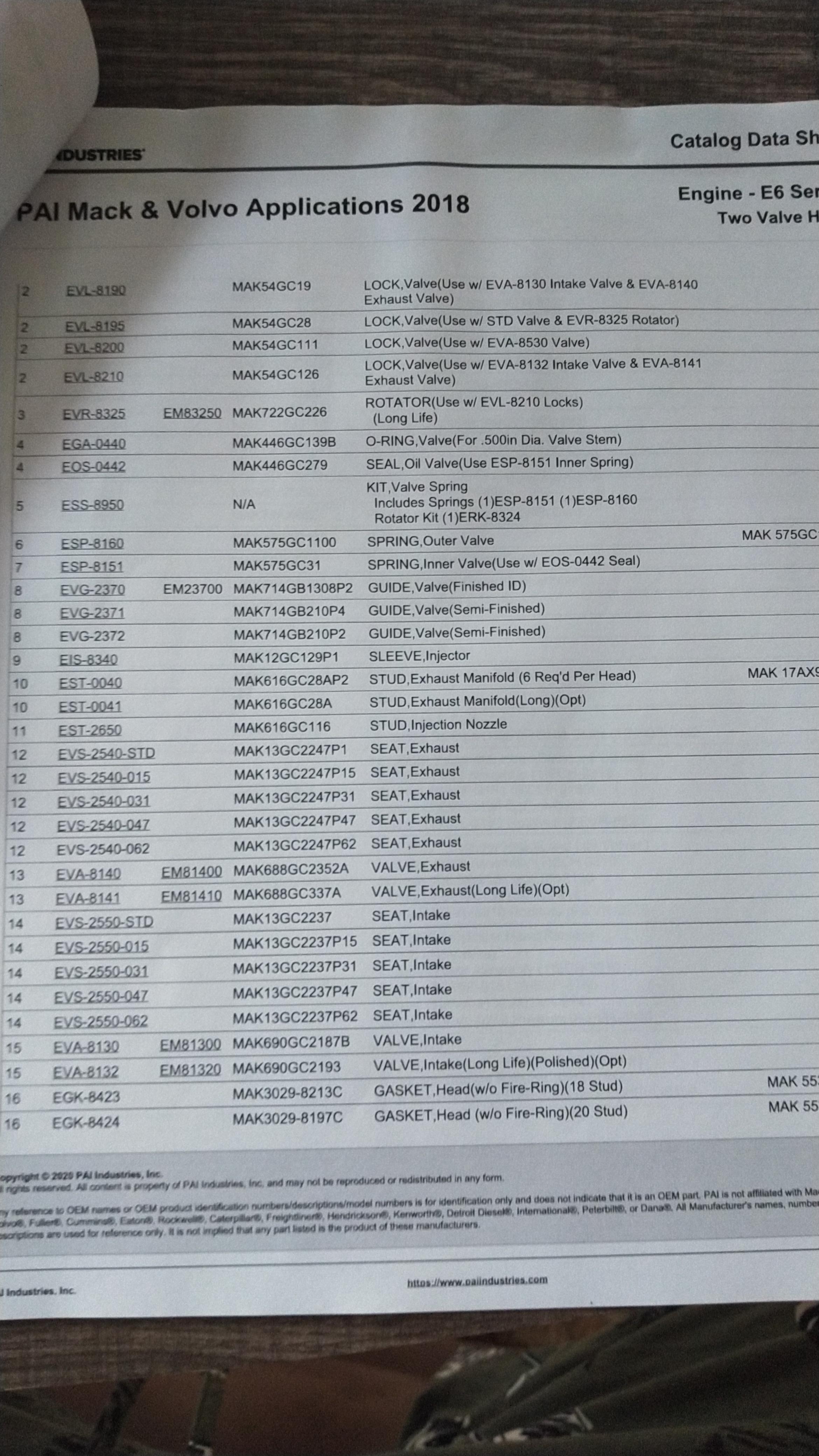

3 hours ago, Joey Mack said:
RS Disposal,,  Will you be able to use any of the info i posted?  I sure hope so..  I can E-mail the pictures to you if you are willing to share your e-mail..  Jojo
I do believe it is of some help. any and all part numbers I have has been of help being the only supplier I have been working with that can do anything with the VIN number is the dealer. Everybody else tells me the VIN number is not a good Mack VIN.  Dealer has been really helpful in looking up and providing me with Mack part numbers.  With that info I have been able to pretty much track down what I need that is no longer available thru the dealer.
Pics would be great
