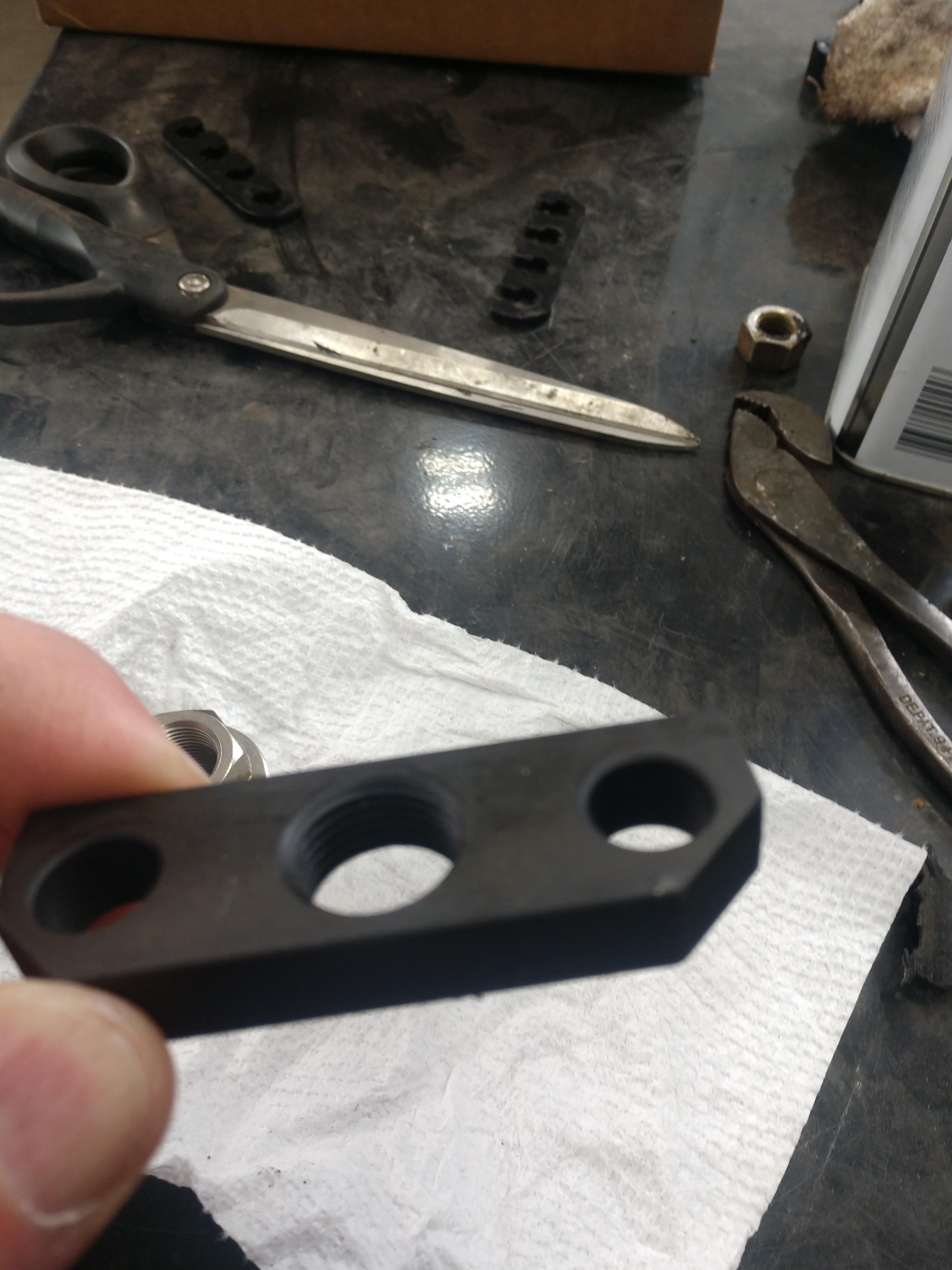

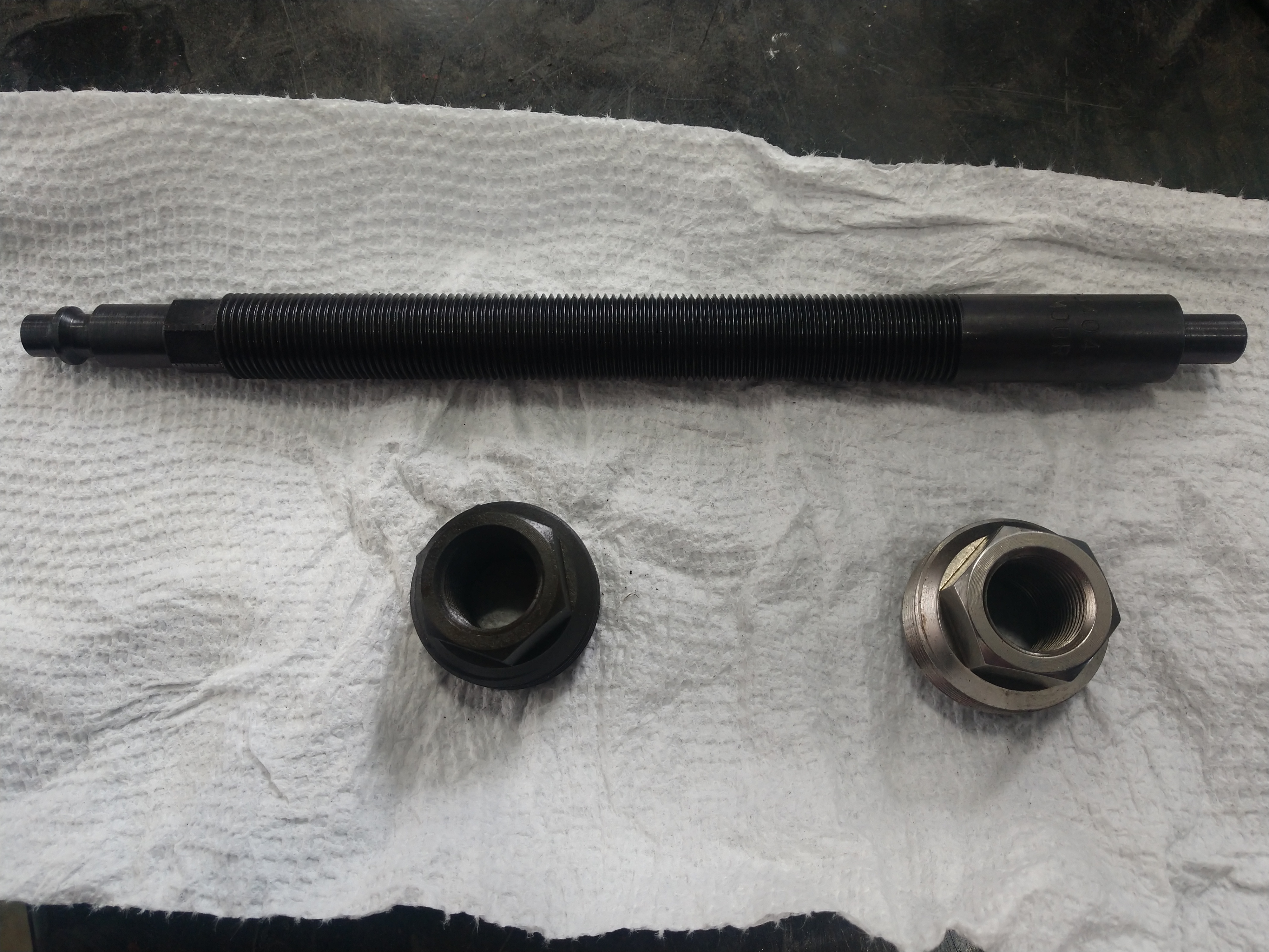

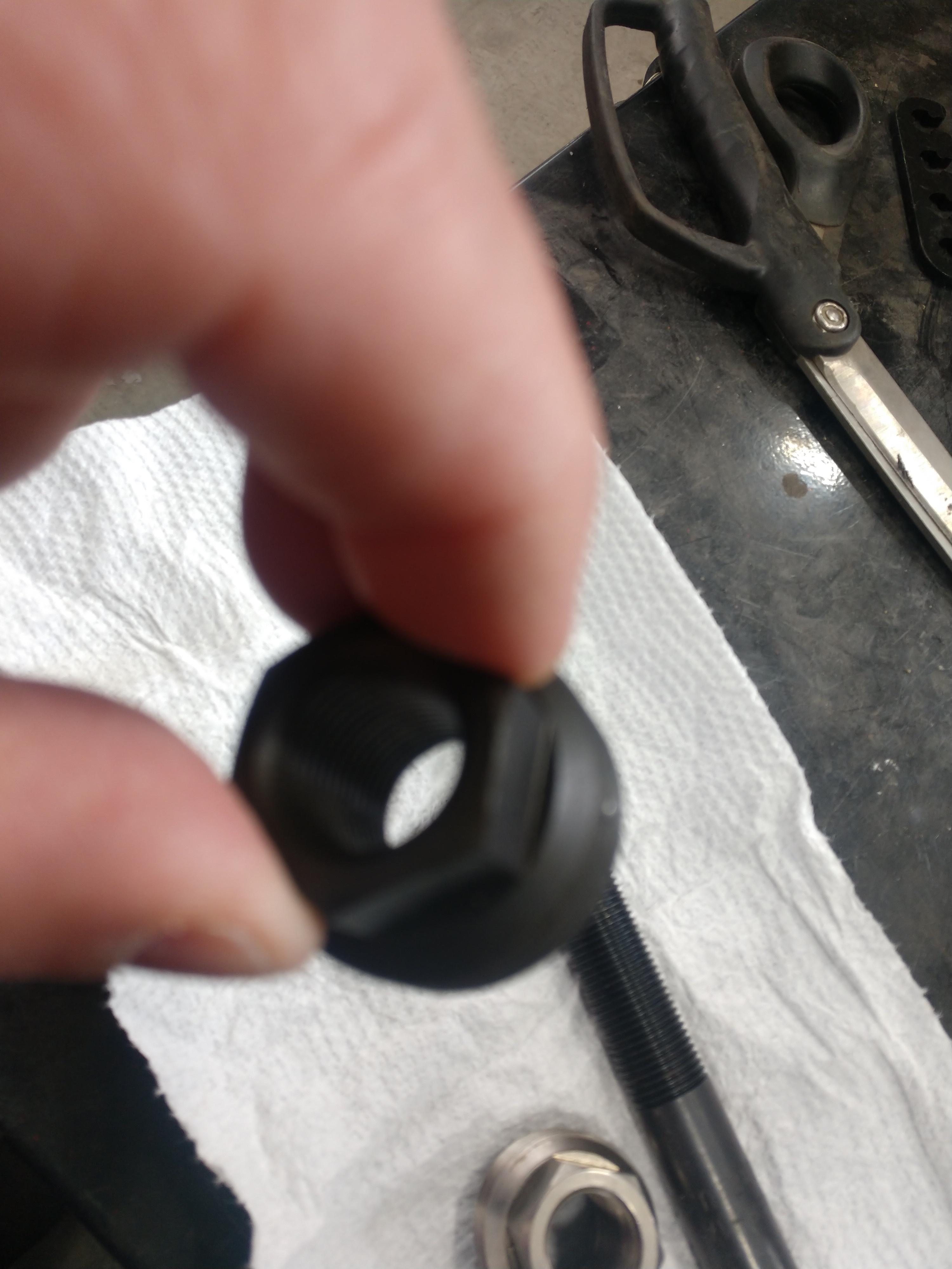

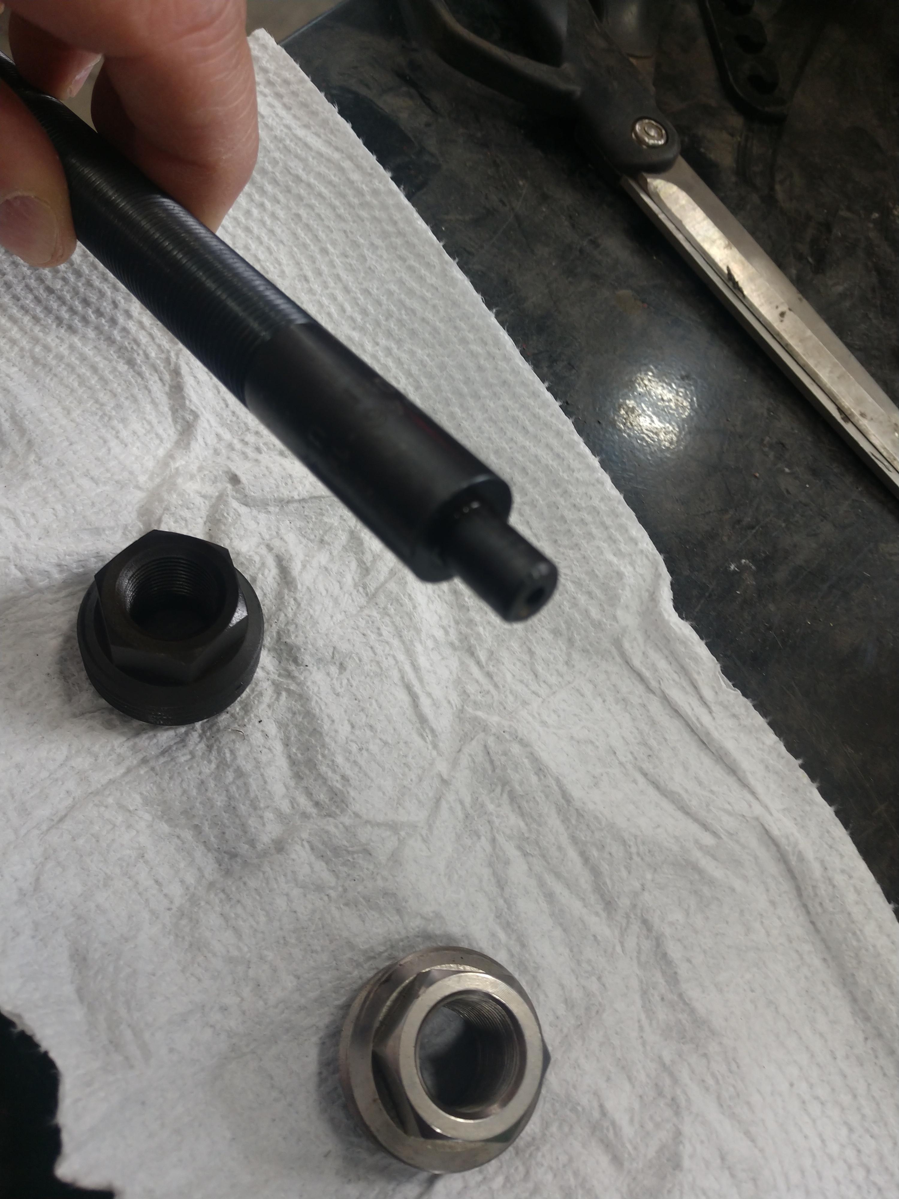

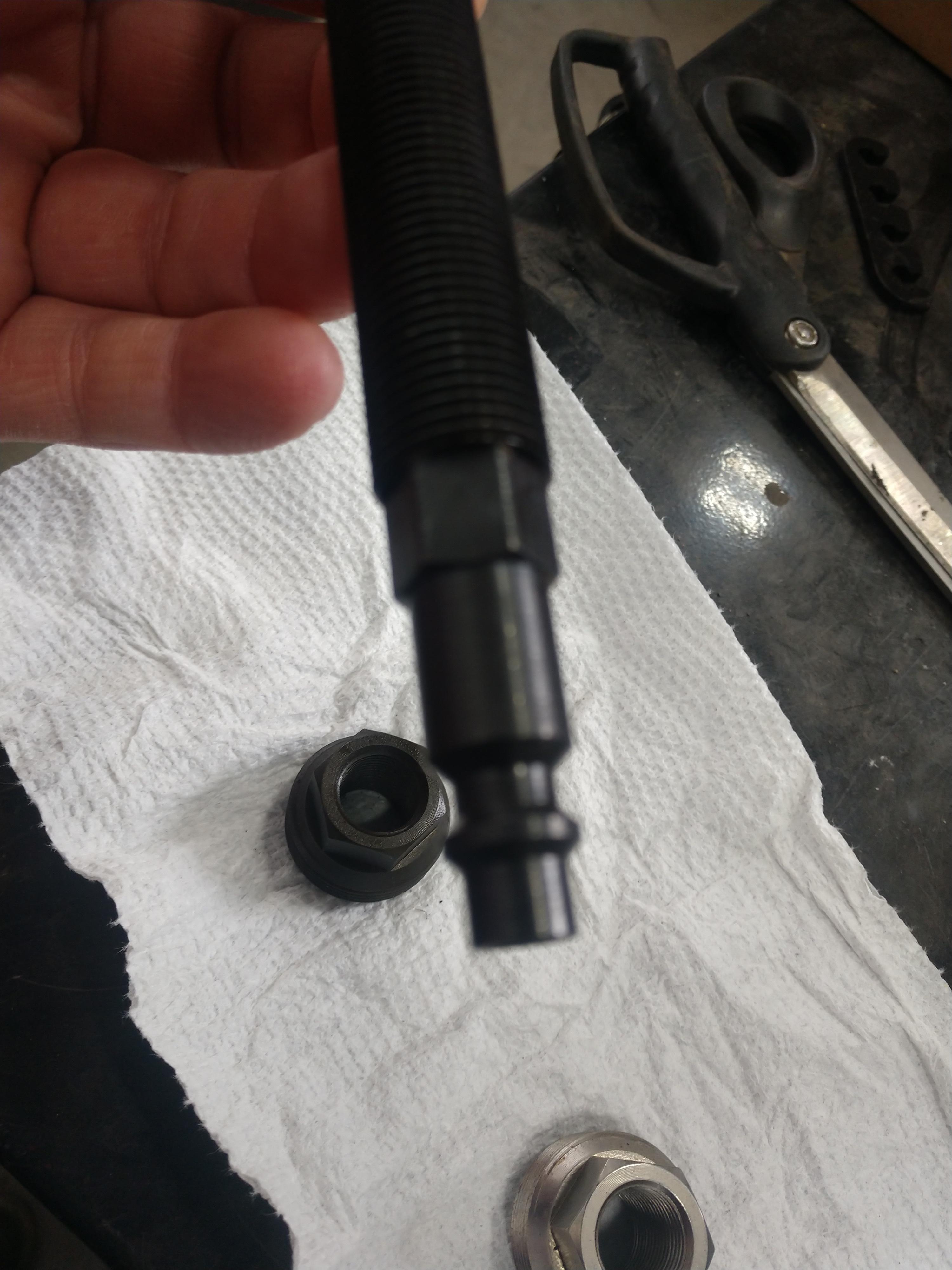

ok,, I missed the part about blowing back through the intake, I just read back over the post..   and Mark is showing you pics of a great tool to own,,  any chance you checked compression before digging deep?  Just curious, and I am really out of ideas on this one..  Good luck to you.  Keep in touch..  jojo
