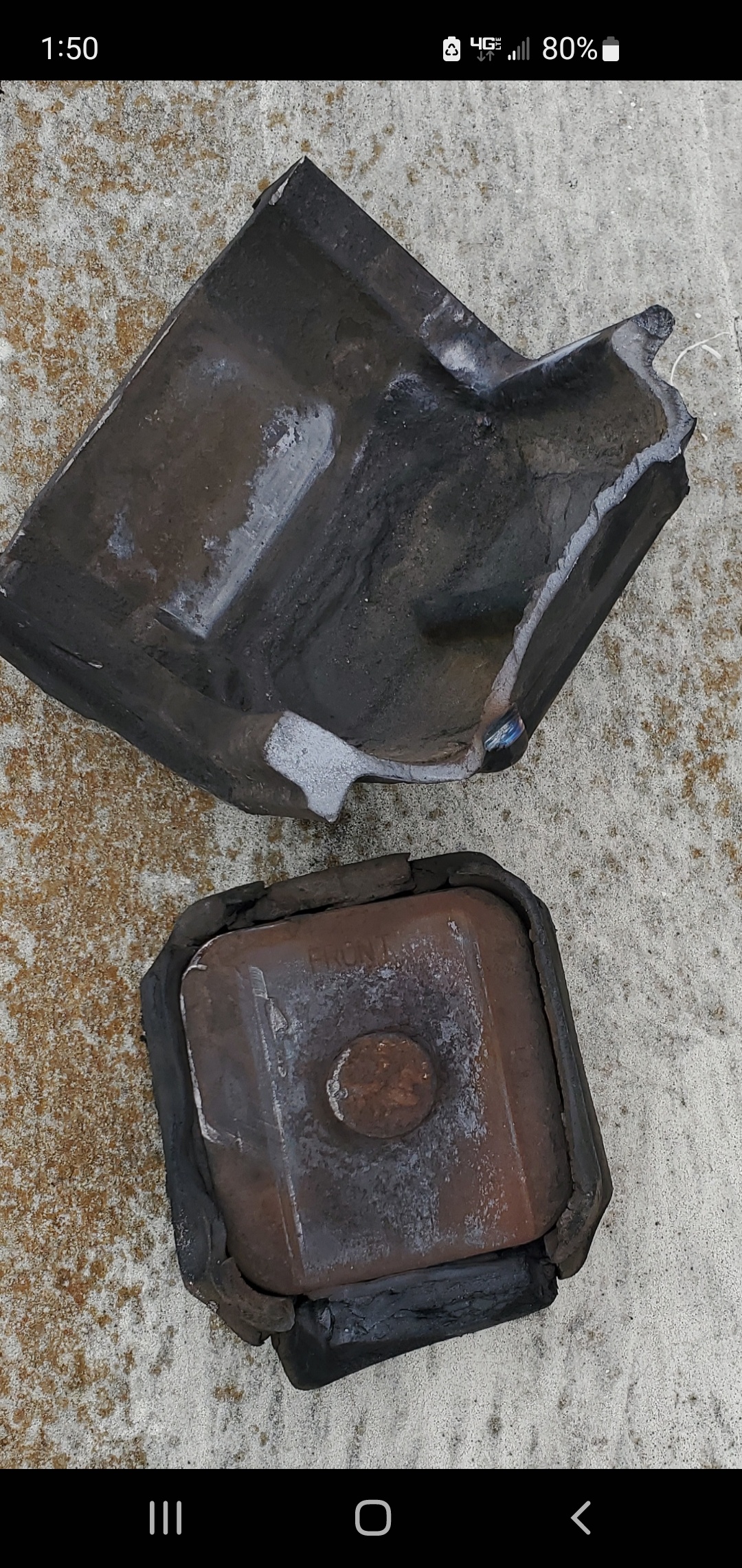

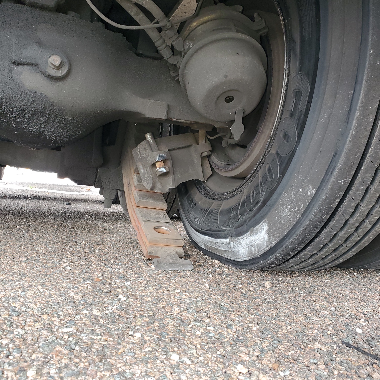

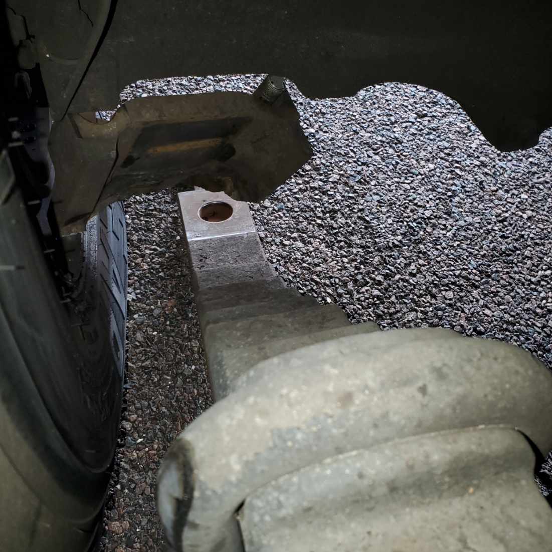

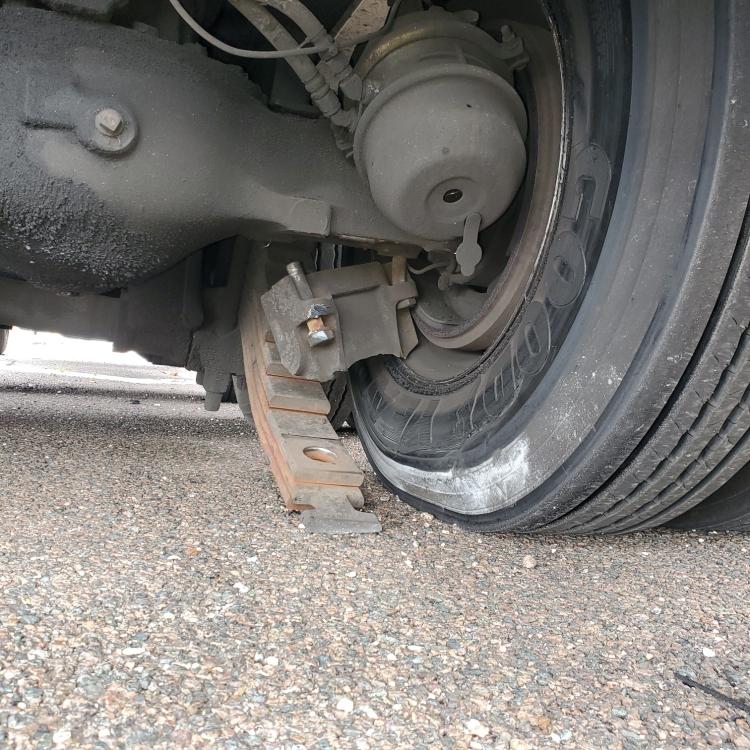

Drive a mack that carries a 5000 gallon pump tank. Rear was walking out about 4 to 5 inches. Brought it to company mechanic told me that mack allows movement. Said drive it no problems.We had high wind warnings and I was driving and it felt a little wiggly but all the wind I thought I as getting pushed around. Now a couple of days later I'm going 65 full load and rear axle pad box blows off I drive the crap out of it almost crash and burned but was able to not hit anything. If you have a high milage camelback rear I advise to check it.I wont drive it without complete parts replacement Springs buckets and bushings.What you think about parts replacement they should not even not replace it all Resized_Screenshot_20221109-135036_Messages.thumb.jpeg.a40a08bfbb56f016f8507e86c57a00d3.jpeg

IDK    those tires don't look like they've been run on a worn out camelback. I'd guess the truck has a side torque rod at least on the rear ?  and the leaf's main doesn't look polished from hitting the bucket ( but it's not a good picture to see all that ) Sometimes when they're that shot the little cover like a dog dish on the carrier bashes into the frame.   Can't imagine what that would have felt like from the driver's seat..... yikes     I'm with Paul on this one

1 hour ago, Hans Remmers said:
Looks like the box was run with bolts loose and then the inners broke off in the housing or pulled out
I reckon your right, this isnt as easy to notice if you dont know we're to look
The bolts towards the center of the camel back I doubt anyone can easily see from walking around doing a pre trip inspection
