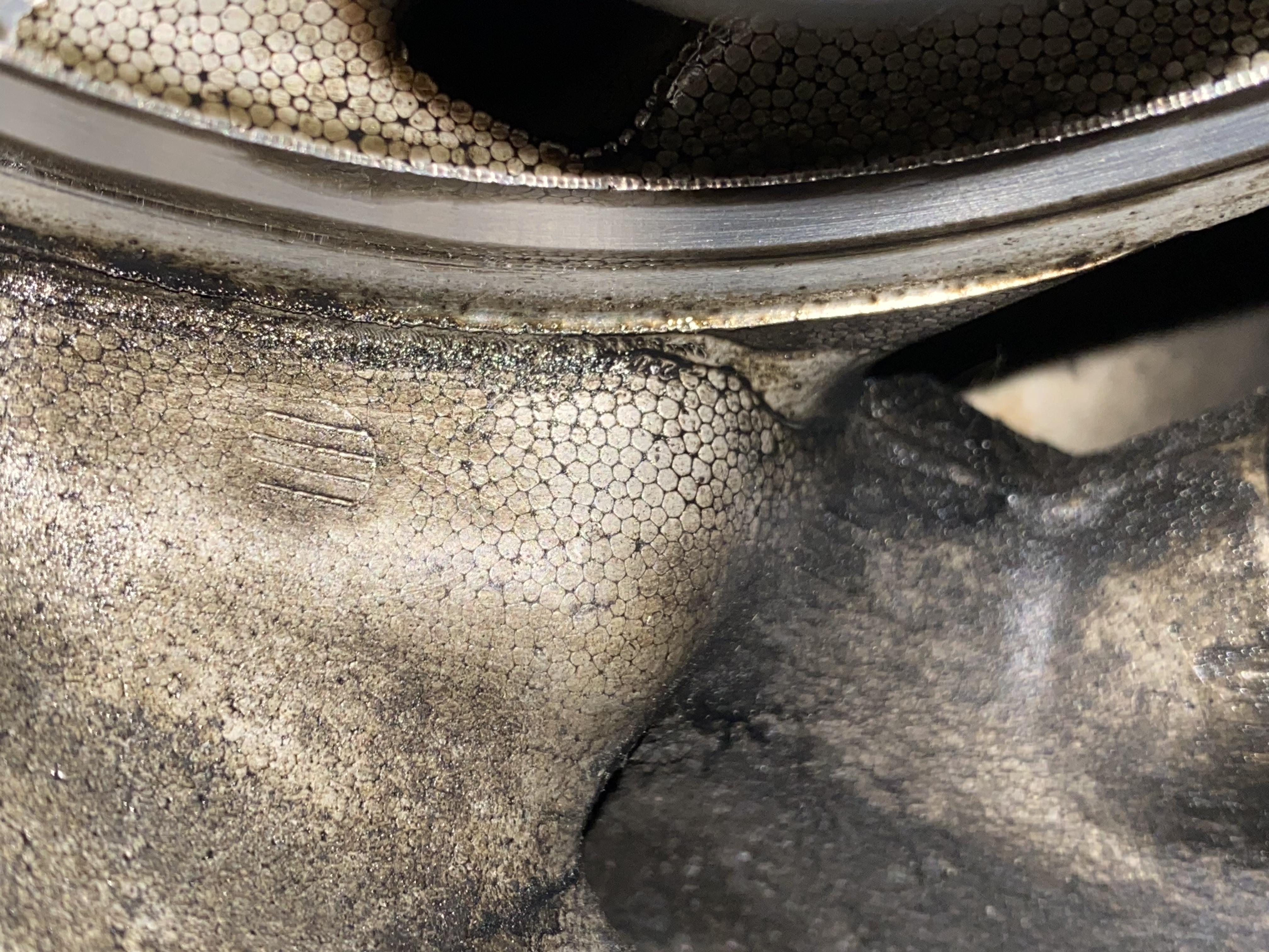

16 hours ago, zeault said:
FOUND THE CRACK!
Right in the armpit.  That’s why I thought it was the gasket.
Time for some JB Weld
Check out Volvo Gouge Pricing for this piece I'd  be curious how costly it is!
Guess that wasn’t it.  Still leaking.  I stuck a snake cam back there and still can’t tell where it is coming from.
This is getting annoying.  I suspect my engine might be burning or making oil but I can’t tell because so much is leaking out.  The area I JB-Welded is dry.  It’s almost like it got worse.
Maybe I’ll mount the camera so I can record it while I’m driving. I am at the point where I really just want it gone so I’d spend the money to replace the mount, but I’d hate to replace it and have the leak still be there because it was coming from somewhere else.

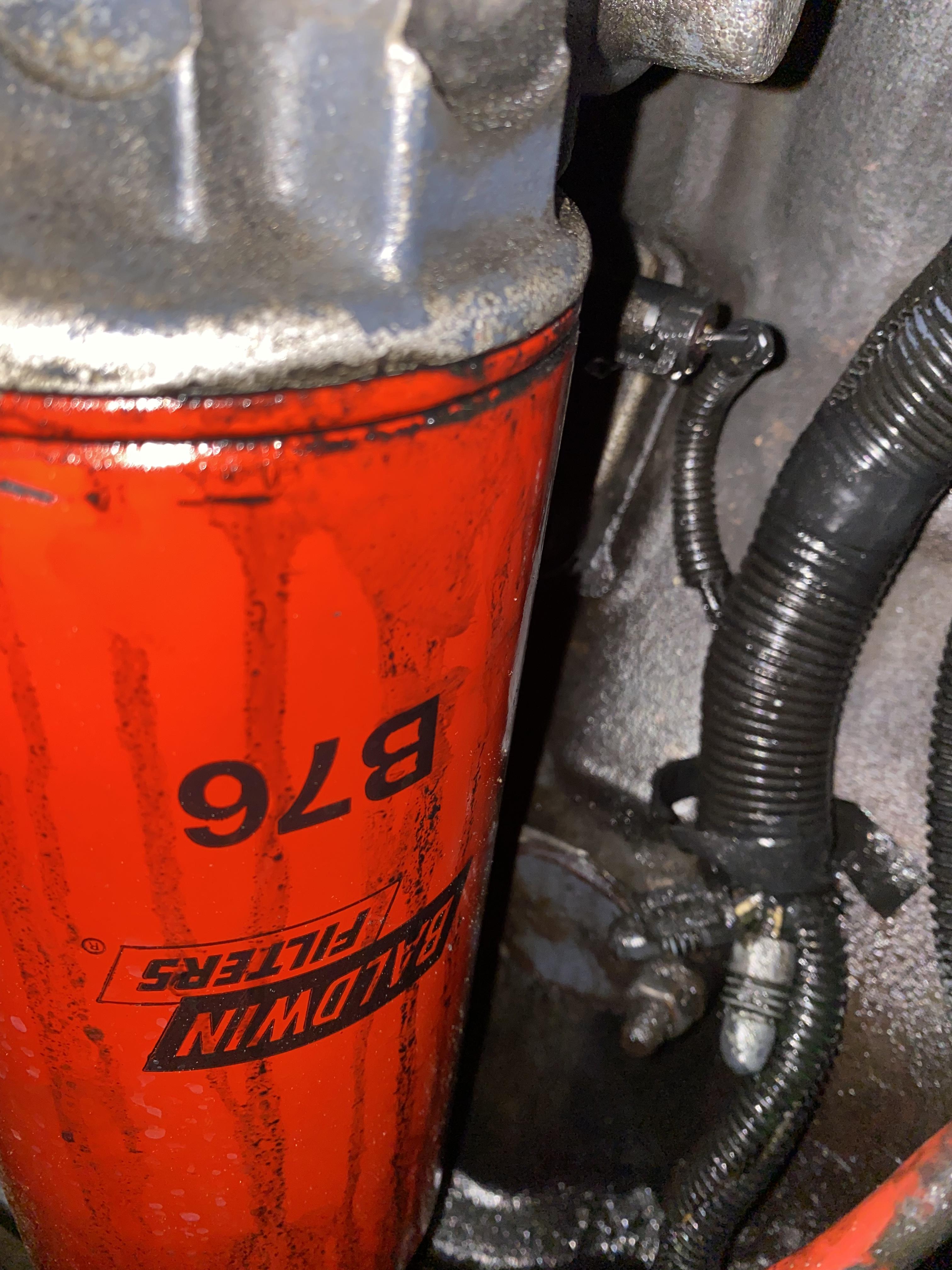

Alright go pop some popcorn its movie time.
https://1drv.ms/v/s!AsGeqBVYV5vqhdMH2cg9mk336L24-g?e=NQOihG
The video doesn't show everything, and there's no sound, and it's pretty boring, but basically it's an issue with the pedestal.  It doesn't seal against the filter no matter how tight the filter is.
It does not start leaking until the engine is up to temp.  When I apply the throttle you can see the oil oozing out and covering the filter.  Then you can tell when I start coasting because the leaking slows down, the oil drips off, and you can see the red of the filter again.
I can't believe I spent this much time and effort diagnosing this, but this whole past month I got burned by mechanics, and then burned by customers not paying on-time, and then burned by my own dumb ass throwing parts at stuff so I guess it's better to be sure before buying a new pedestal but yeah I need a new one.
My aftermarket PAI dealer says a new pedestal is $800 plus tax.  I didn't bother asking the mack dealer.
End of story I guess.
