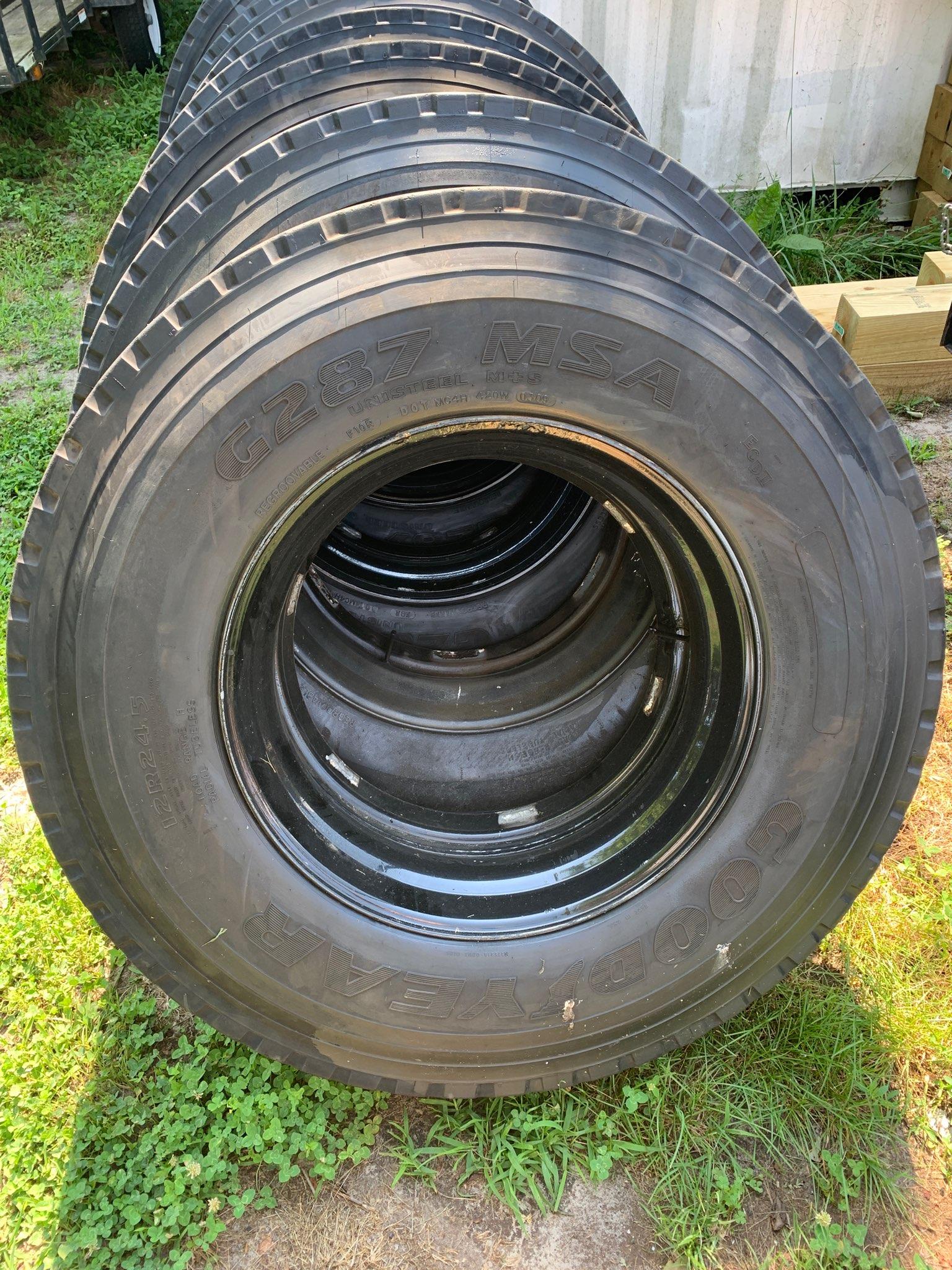

Need help 11.00 or 12.00 24s
My brother in law's business partner is thinking about selling the 85 rd that I've been working on because it needs exhaust and new tires. The truck has 11.00x24 tube tires on split rims. They bought 8 drive 12r24.5s on rims thinking it will work on this truck, but don't work. I'm crossing my fingers that if I can find someone who is willing to possibly trade 8 or 10 11.00x or 12.00x24 decent tires on rims that he might change his mind and keep it. I don't want him to get rid of this truck

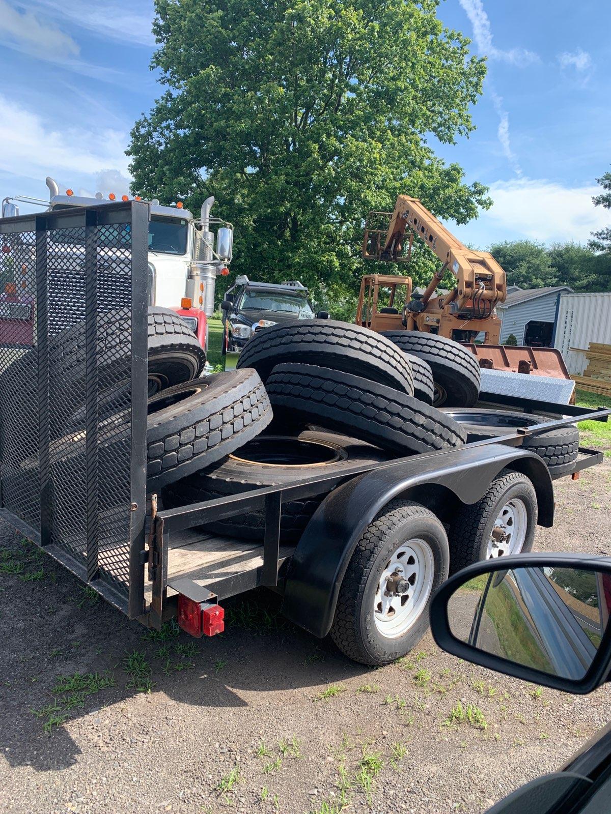

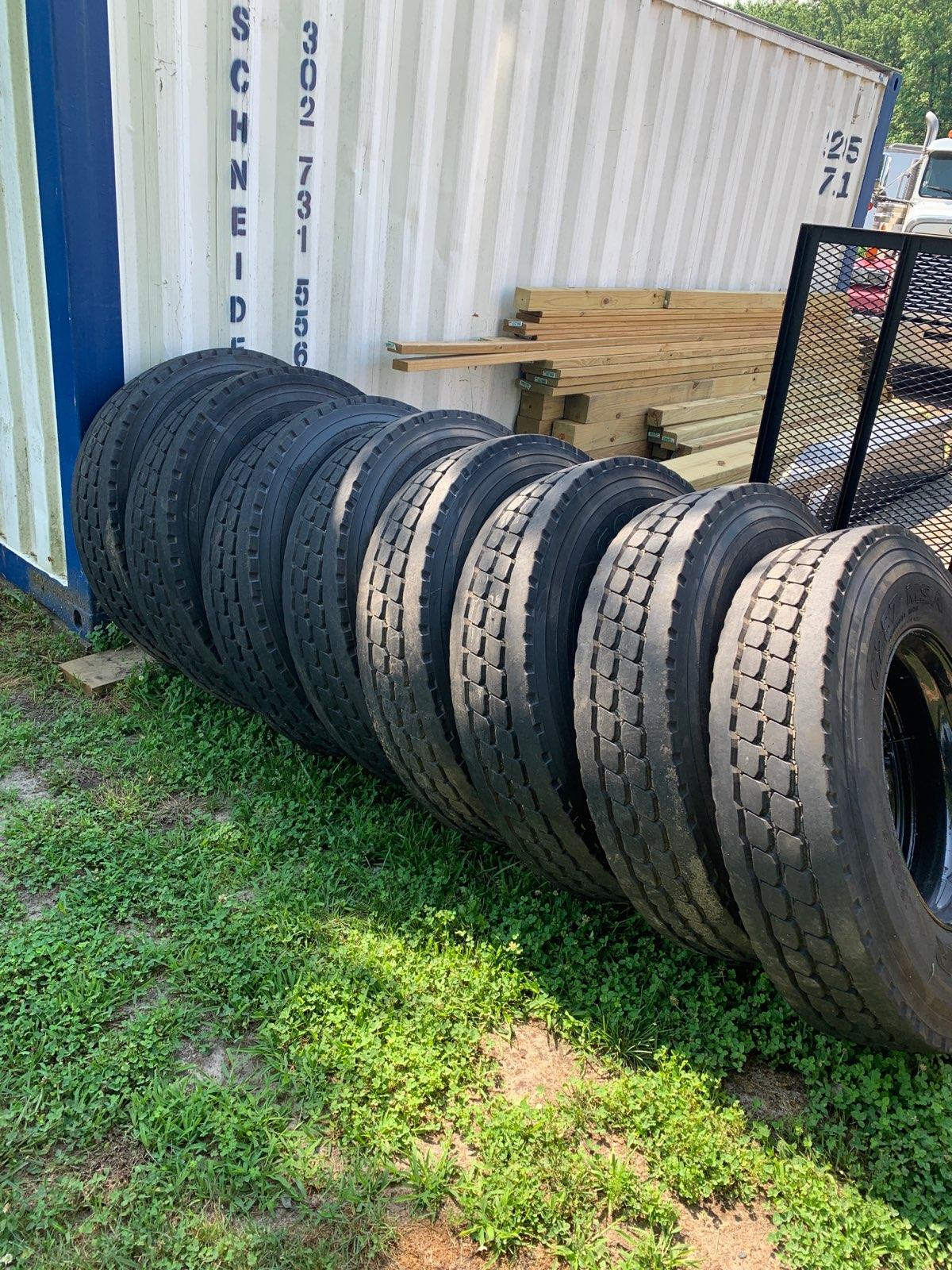

We were misinformed about the split ring I'm sorry. Everyone around my area has always identified these styles as split rims. I'm on 24" dayton hubs. He was going to sell it because of how hard, expensive and trying to find those size tires and someone that would deal with those style wheels. I called one truck tire company in my area (southern Delaware) and for 11x24s with tube mounted its $575 each. I don't know if that price sounds about right or not. He wanted to get away from split rings and go to tubeless for safety reasons and cheaper and more common tire availability. I talked to him last night and I think I might have him convinced to keep the truck for now. I told him if I could find someone whose willing to possibly trade 8 good 12x24.5 wheels and tires for 8 good 11 or 12r24s then he would have the tires he needs plus 8 that are already on the truck he could use as spares.
