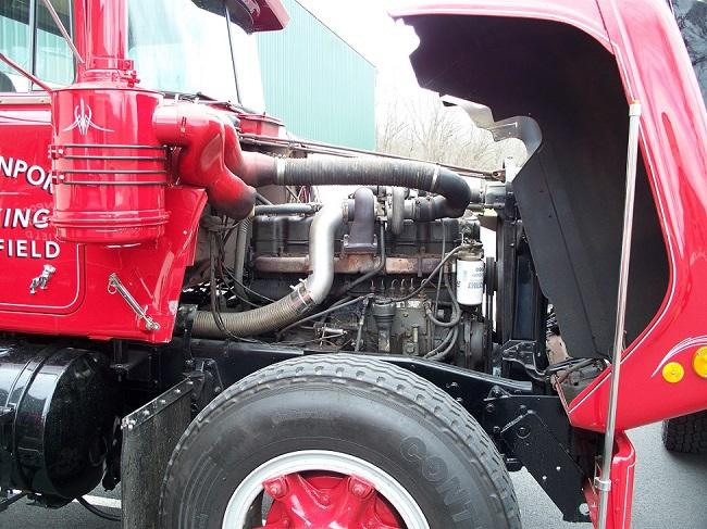

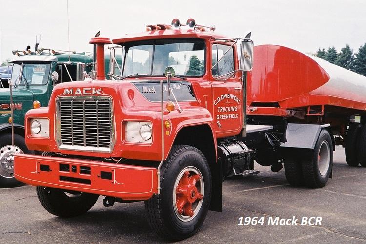

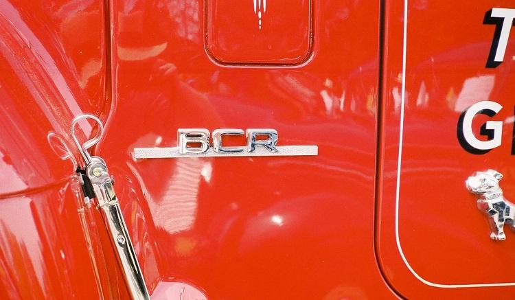

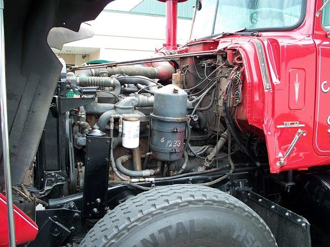

It is a B model Mack Converted to an R model.
A mechanically sound B with beat sheet metal or an accident could be upgraded with all the parts and pieces along with a new hood and cab.  The VIN would still reflect the B model origin.  You would then have a new looking truck with ease of access to the engine that the B model didn't provide.

The red BCR at the top of the thread seems to have a more spread out front axle than others I have seen.  Almost like a factory R front setup.  Most BCR's that I have seen have a narrower track, at least that is the way it appears to me.  Am I imagining things?

It is a wider front end.  The truck had started out as a single axle heavy wrecker.  Wheelbase has been cut down a little.
As built for wrecker service, the front axle probably is an FA522 or 601 instead of FA505 (8,000 lb) which was used on B tractors in many cases.
