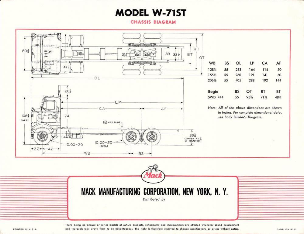

I saw on some factory chassis schemas that W frame rails had spread to the front like say B-model did. At the same time I'm sure LT rails were straight front to rear if you look at them from the top. Any ideas on the matter? Just a wrong picture?

Hi Vlad,
I agree with you almost all the time but. The frame rails are the same on the LT and W frames. This is a photo of my LTL frame and the spread is obvious towards the front.

Whoops!.. Many thanks for the reference picture. For some reason I thought LT rails were of the same shape as a common L-model had with just cab mounts etc moved backwards. Now I clearly see I was wrong. Probably I never crawled under an LT chassis since it's off a focus of my interest. One of the greatest looking trucks no doubt but my personal preference is an all Mack drivetrain. LT's with 707 were described as produced in some quantities but I don't remember ever hearing of any survivors.

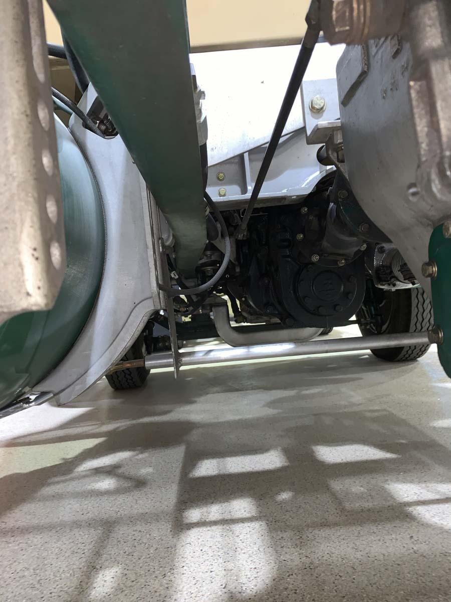

Here is a 1947 LT that I just picked up. The owner called me and told me he was not able to finish the restoration . He was 11yrs old when he and his Dad picked it up at the San Francisco Mack dealer!! It has the Mack 707 thermodyne gasser. the 47 thru 49 were on a different frame than the 50 on LT's
Does it still have the spread frame rails? Also looks like that’s a 707B motor to me. It could also be an A but it seems more like a B motor to me.
Please give us any information you have about the truck!
Also do you plan on restoring it? It’d be the only 707 powered LT on the road!
Who needs a back yard when you could have a :mack1: Yard?!
My bet that's EY 707ci Mack engine taking to account the production year.

C motors have the exhaust manifold on the driver side of the truck, this one has it on the passenger. The thing that leads me to believe it’s a B motor is the pattern on the block. My ‘53 has a B motor in it so the year isn’t really a reliable way of figuring out which motor I’ve learned...
