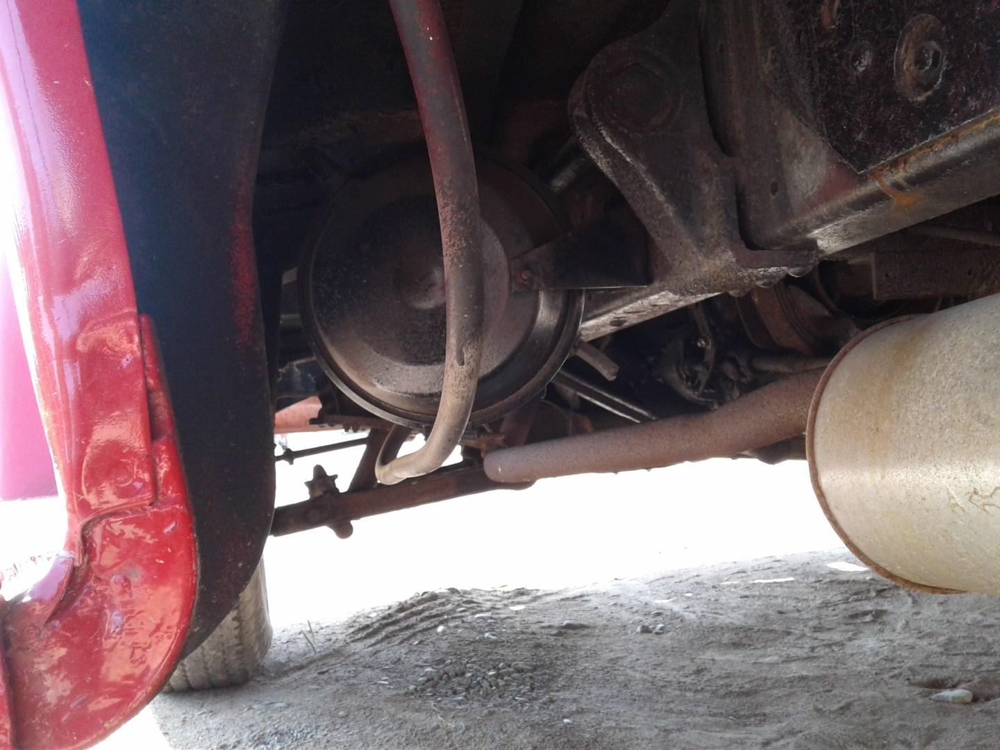

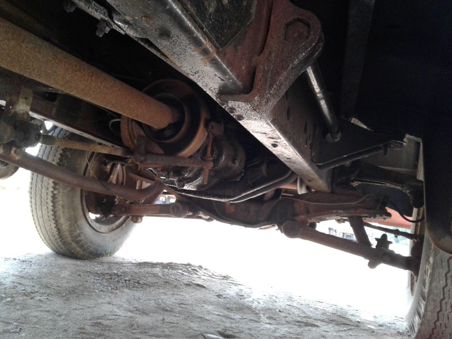

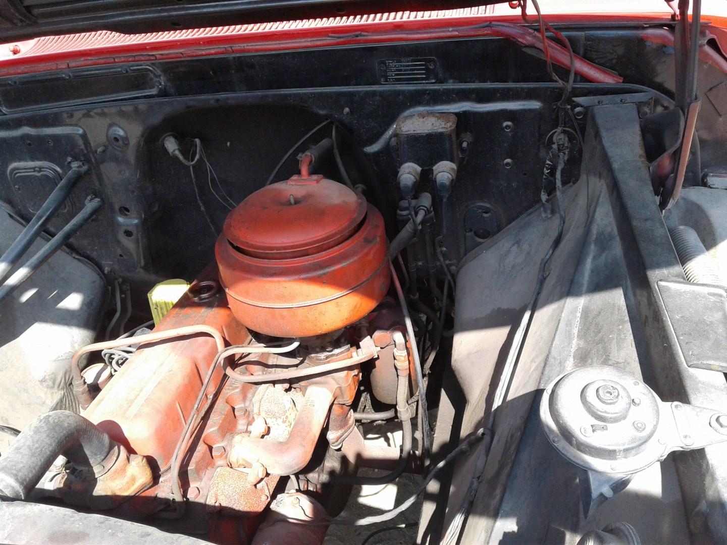

So that booster is for the clutch also? is that this big round thing here in this pic? I never crawled right under to see what it was.

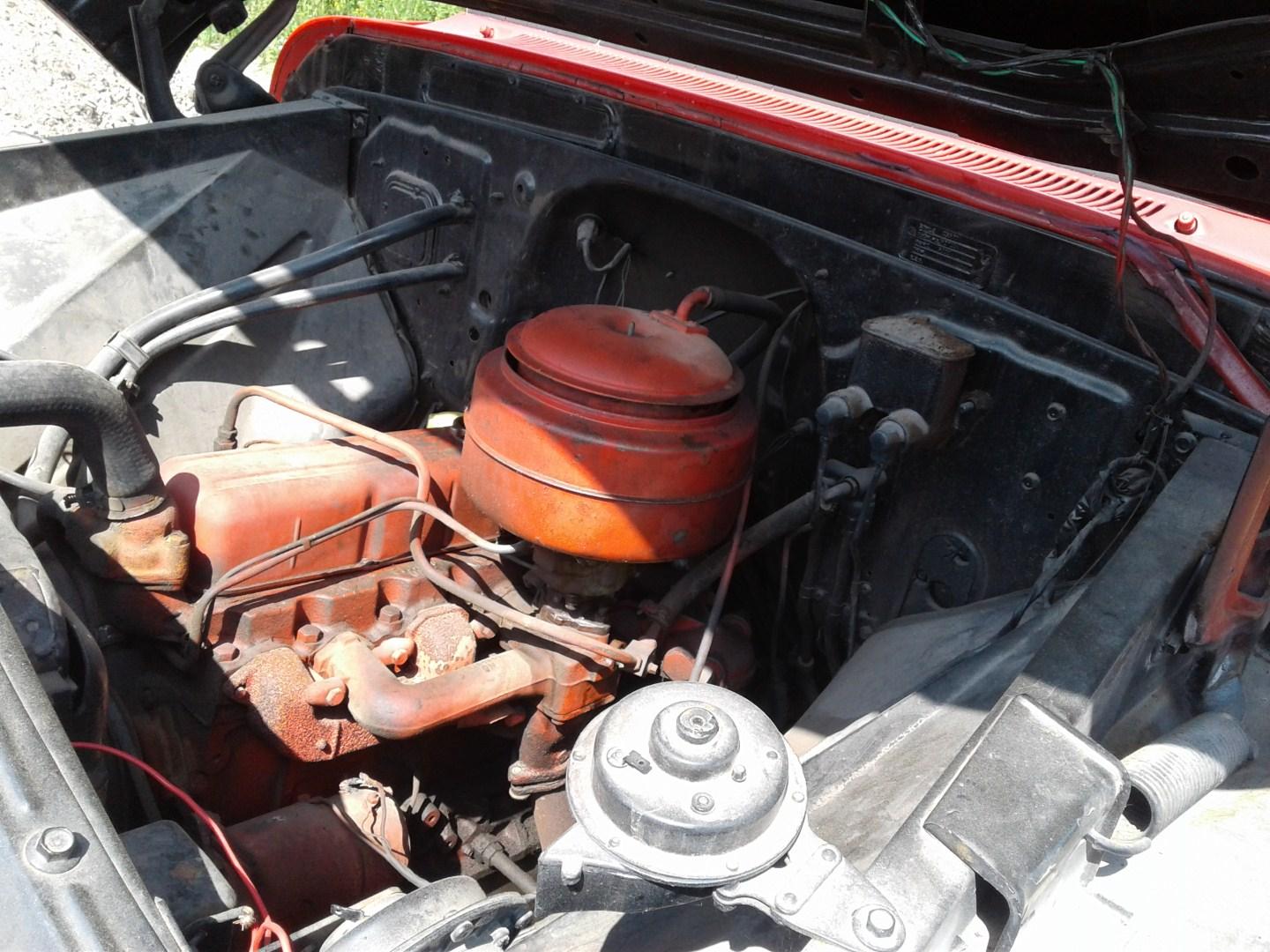

6 hours ago, RoadwayR said:

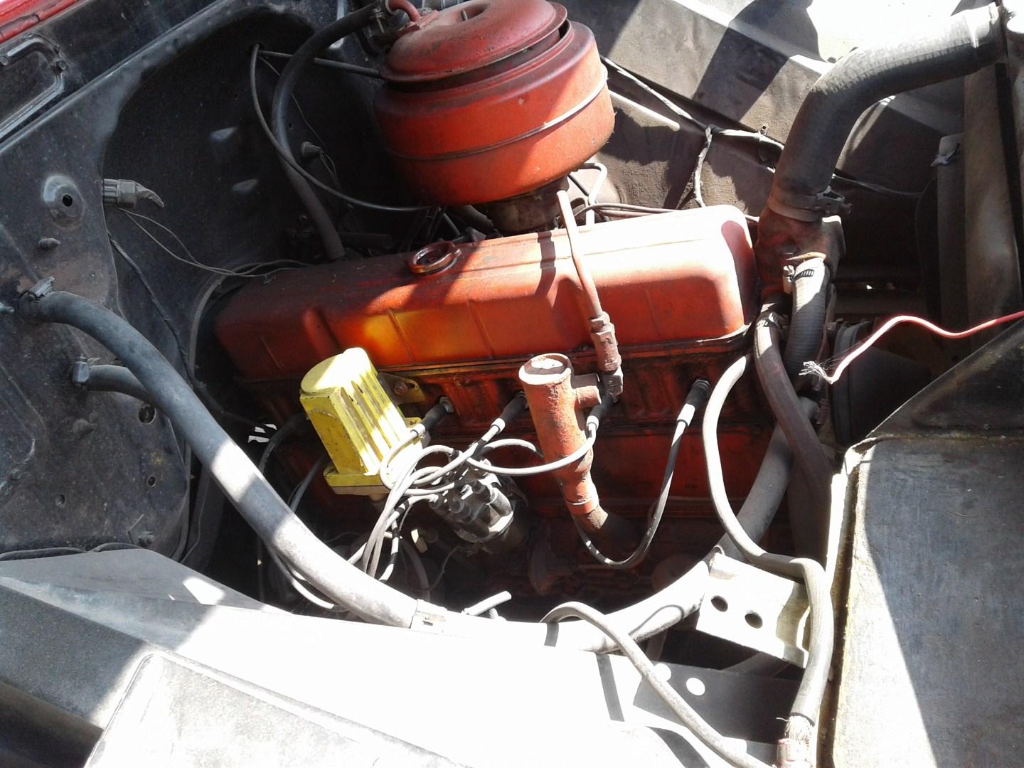

The 292 is a great engine, but that's not a 292!  Looks like the older 261 to me.  292 didn't come out until 1963.  The 261 was a good engine too, basically a larger heavy duty 235.
Really? I'm just going off what my friend told me. He has to find the ownership yet. He told me it is a 62 with a 292?

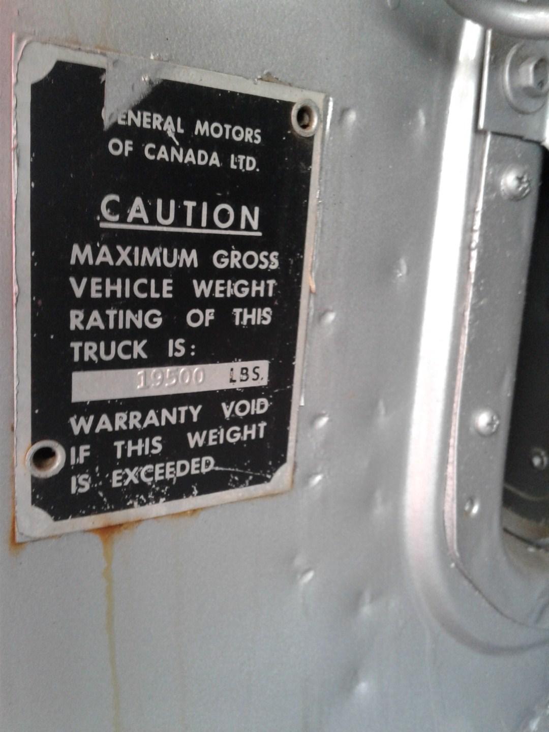

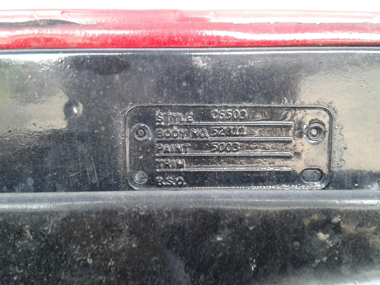

These are the only tags or numbers I could find on the truck.
that booster under the truck is for the brakes, not clutch. that truck will have a regular mechanical clutch.
another option for ignition is a pertronix points replacement unit. simple, and 10 minute to install.
That twin master is brake on right clutch on left C30 to C60 ran that set up until 1965.
Should of looked at pics closer,  fuel pump and dist are on wrong side for 292.

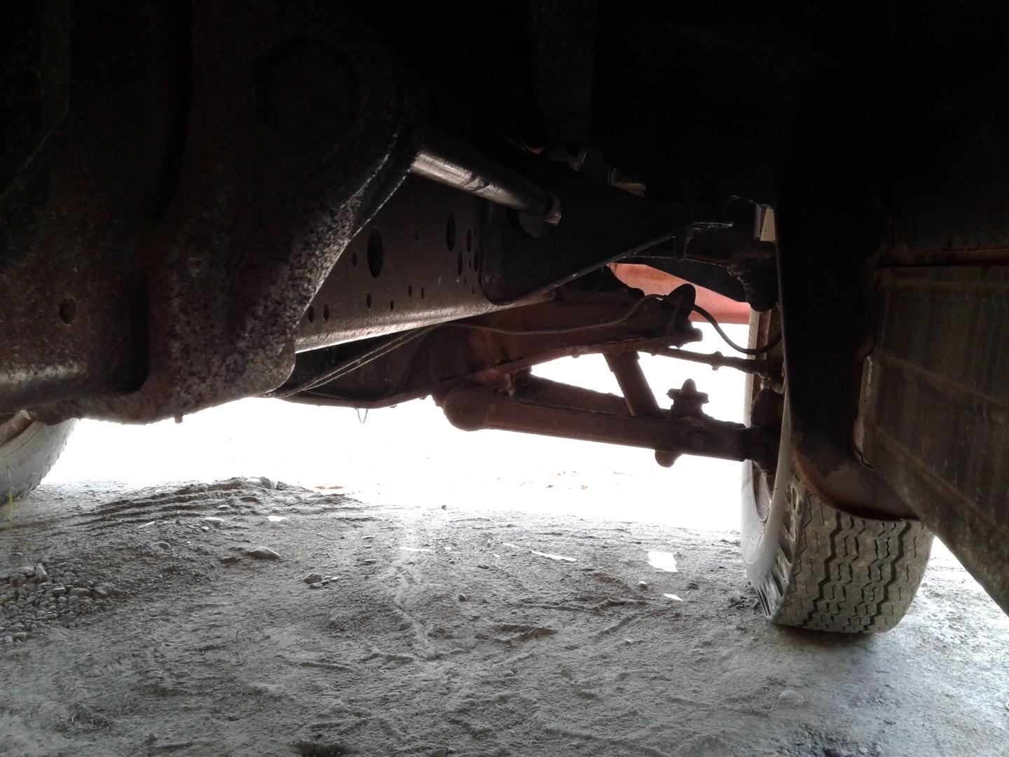

Still have the torsion bar front suspension?

4 minutes ago, 41chevy said:
That twin master is brake on right clutch on left, same ones I've used in hot rods  C30 to C60 ran that set up until 1965.
good call, i missed the two port master cylinder.
Treat the torsion bars with respect and a bit of lube on the hex ends. Our old farm truck broke one and I adapted a pair of 1976 El Dorado units into it.

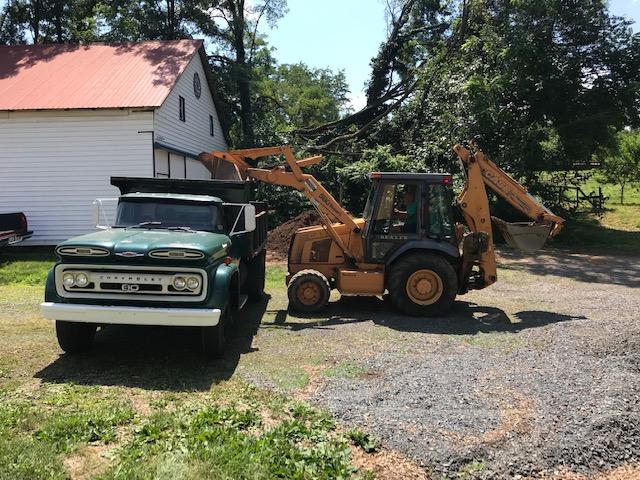

Very neat truck. I have a ‘61 C80 with a 348 and air brakes so a much different truck, but with independent front suspension.  Hopefully you never need king pins because we could only find one set and it was $1000.  Hopefully my old ones hold up.  I used mine today hauling dirt around the farm.  Mike
