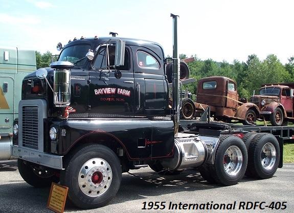

Was Page and Page suspension popular in N.H. and VT.? I looked at a B and a REO  in the respective states  and both had the same suspension.
I drove a 61 KW conventional for a while with Page and Page, seemed to ride better than Reyco or Freightliner 4 leaf with the short equalizers.
Also seemed to get around on rough ground well too. I think equalizing the rear of the spring packs helped.

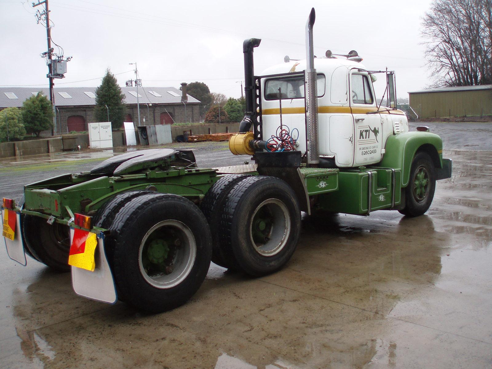

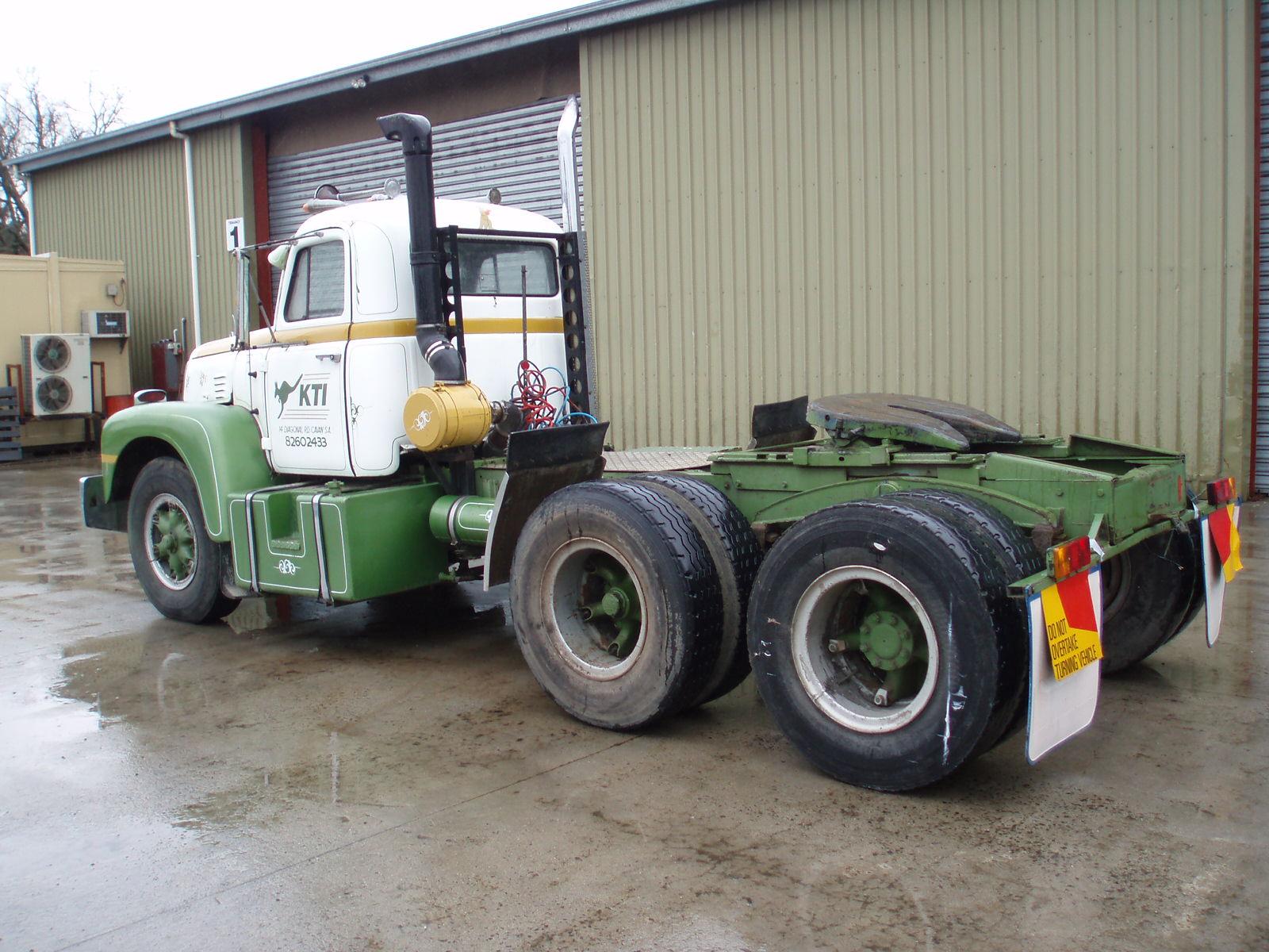

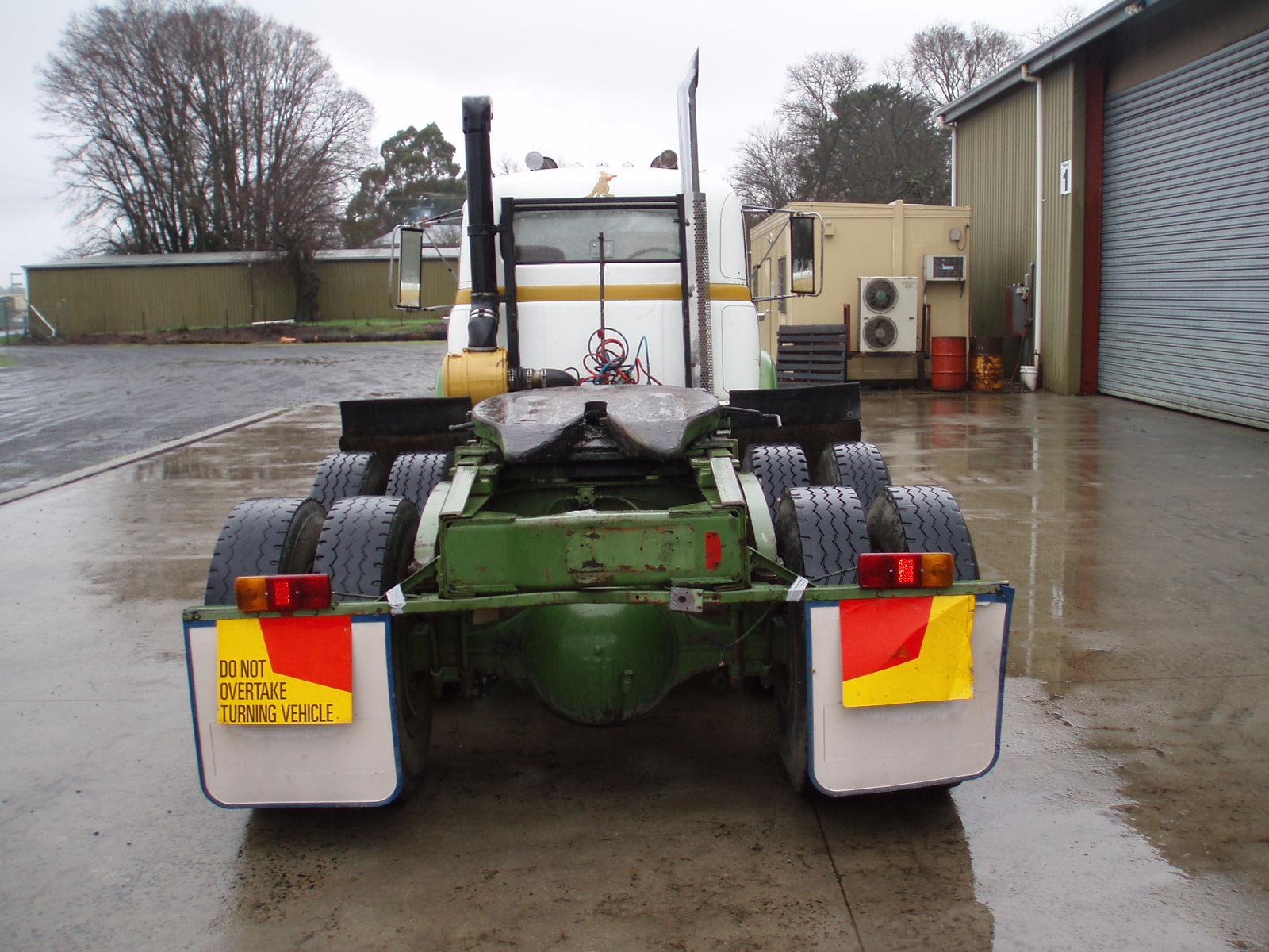

page and page was popular in Aust, 1965 Inter R200 with Page and page, lower truck tare weight more pay load for highway work, reduced maintenance so made a lot of sense, really how often is the tandem drive used on highway work where snow and ice not a concern?

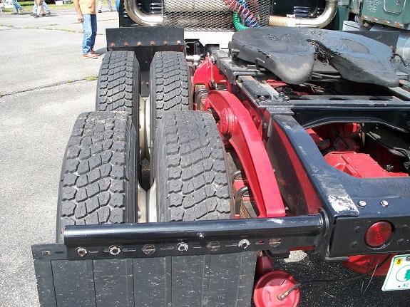

A B61 I was looking over at the Rambler Ranch had the Page and Page with one powered axle. Seems that gives you the best of both worlds for OTR. The B also had a belt set up to power the dead axle wheels. Different unit but they wanted 3 times what it was worth.  The owner is a heavy car collector (6 or 700 Ramblers in his collection)  but no knowledge of vintage trucks.

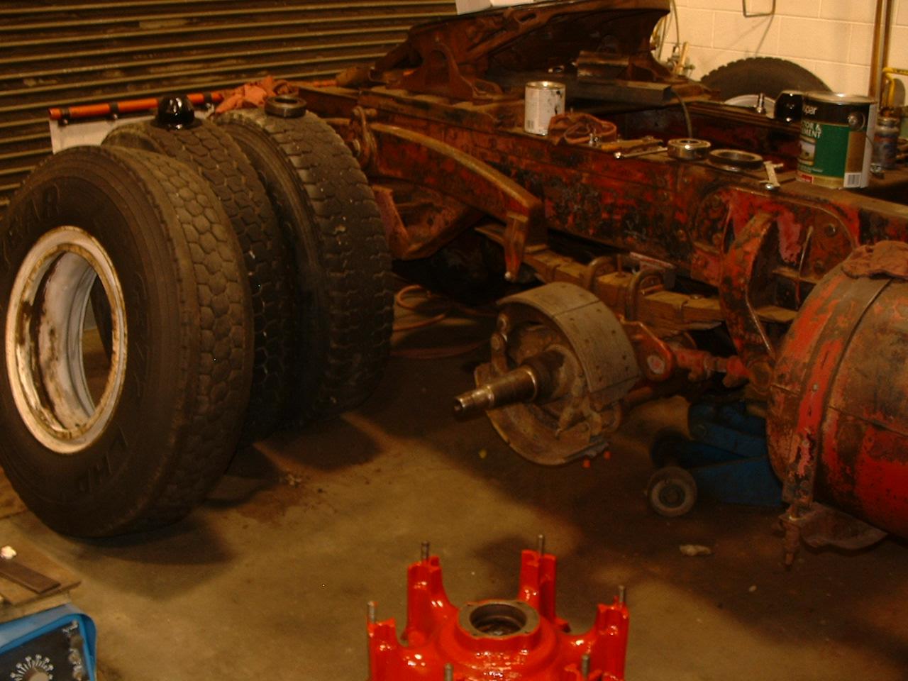

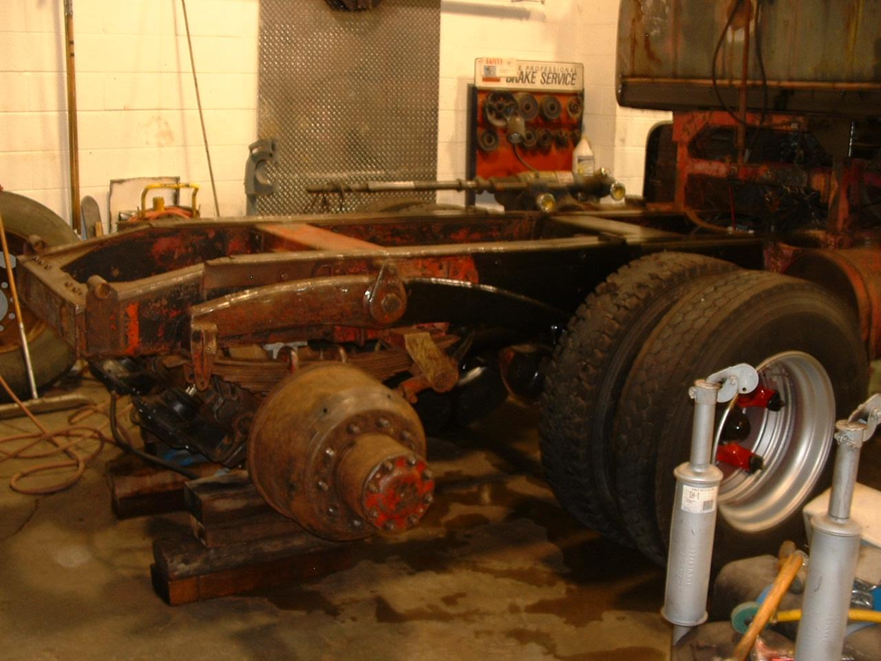

Thank you for the reminder of Transpec, yes this company was the Page and page supplier and fitter of the pusher axle. I see on the picture of the P&P, the pusher axle has spyder wheels and the drive wheels are budds!!! Did the P&P have budd wheels? In Australia 50's, 60' and 70's most trucks had spyder wheels so followed that the P&P axle had spyders.
I cannot recall seeing any P&P with budds.
Also in Australia, a single wheel pusher axle was popular, it was fitted in front of the drive axle for prime movers (tractors) to avoid extending the frame, and the P&P axle had brakes fitted. For tray trucks it was popular to fit a single wheel pusher which were mainly fitted behind the drive axle, to allow a longer frame and tray, to gain more loading capacity (1 or 2 pallets) and avoid having to extend the tail shaft. These single wheel pushers had if I recall a front steer axle with non turning wheels and individual springs, I can't recall if they all had brakes on these single wheels.
