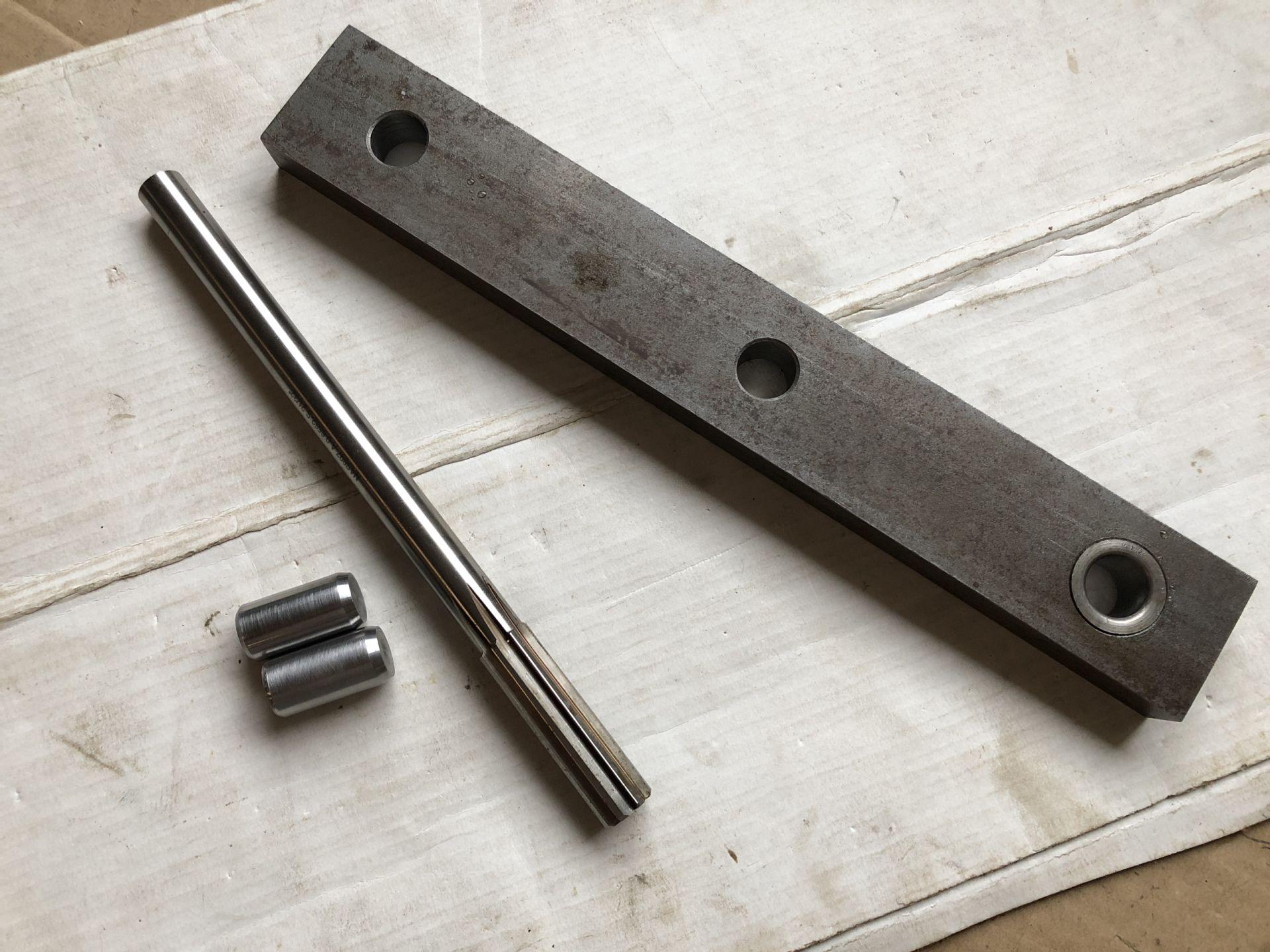

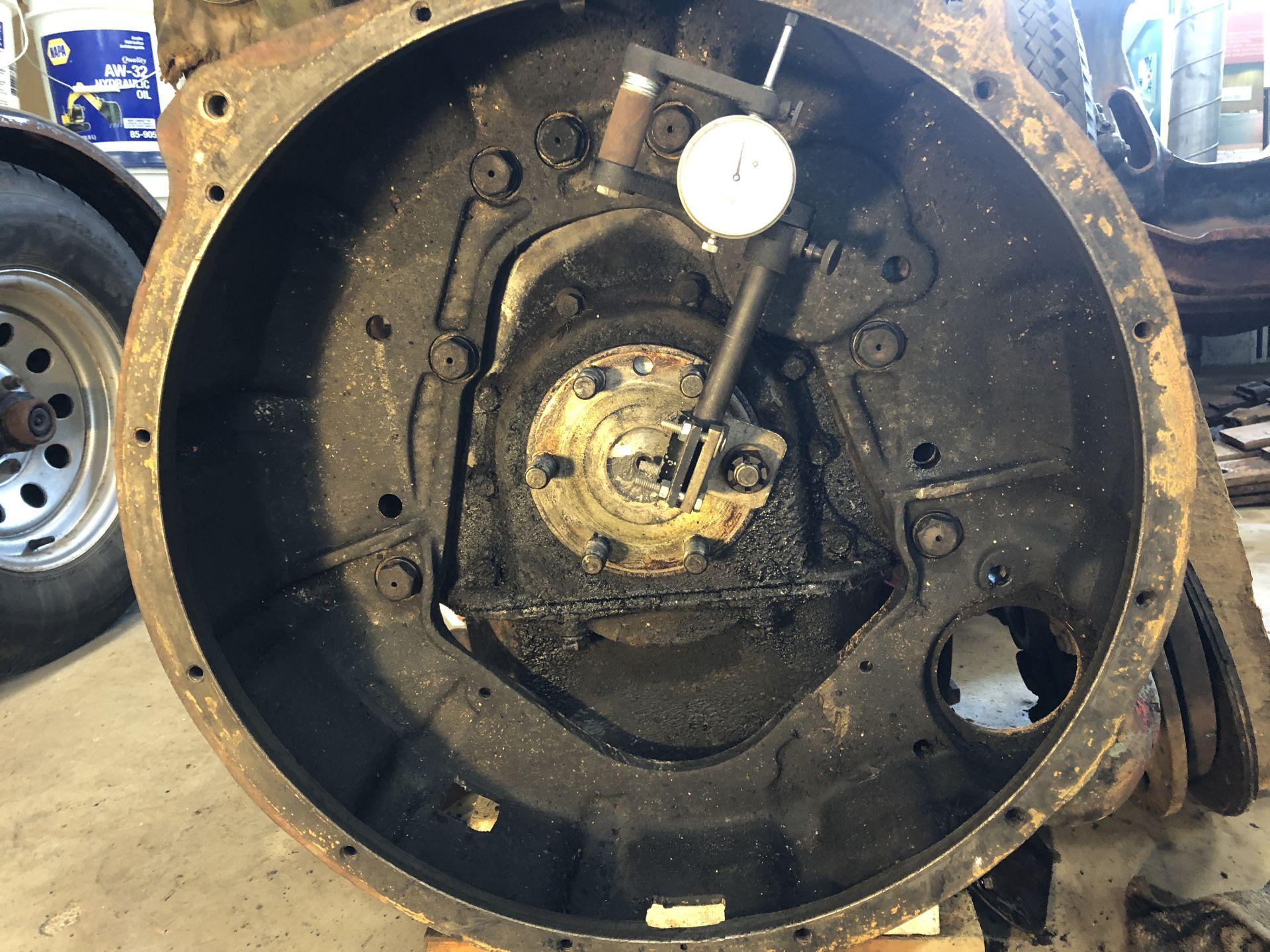

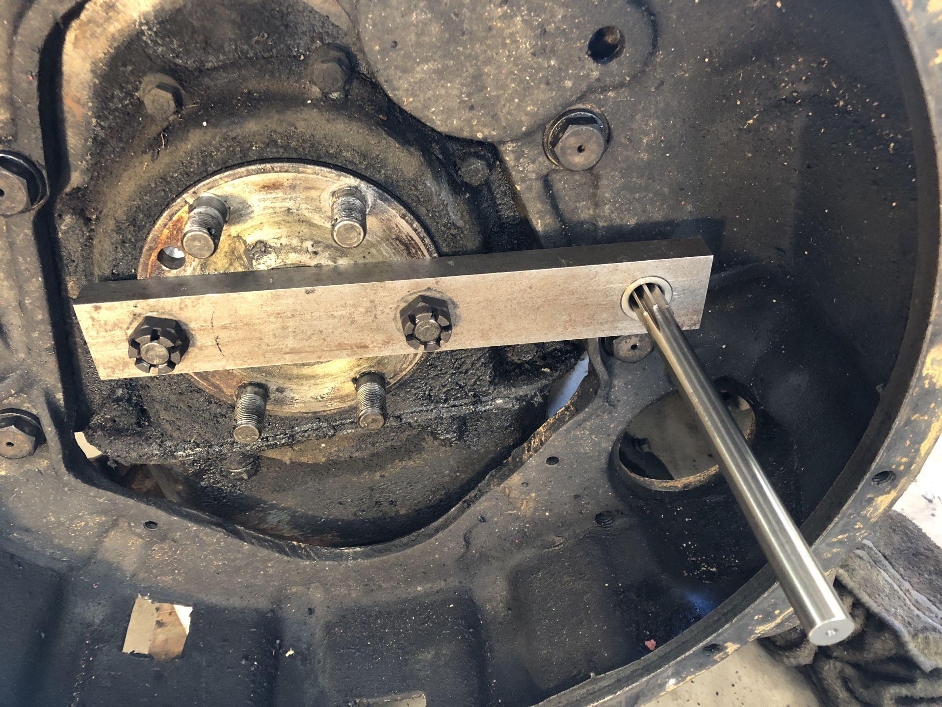

I am swapping a different flywheel housing onto my '58 673 because it had the shallow housing before and the duplex that mates to it has some issues. The housing is about .032" off center so I need to ream for larger dowels (the existing dowels are 5/8"). Does anyone know if I have to go to 3/4" dowels, or can I get something like .650"? I haven't been able to find anything but 3/4".

Know of anybody with a lathe to turn down from a bigger pin?     terry:MackLogo:

I have a machinist buddy that will make any size dowel from 4140 shaft stock. He has also done a few custom reaming jobs for me on site.
Have you done the dowel holes on a flywheel housing before? Can I just use a reamer with a jig to hold it square?

He has a jig for his reamer that bolts onto the housing. I let him make his own dowels and do the reaming to match. He has done 3 Cummins engines for me over the years.
