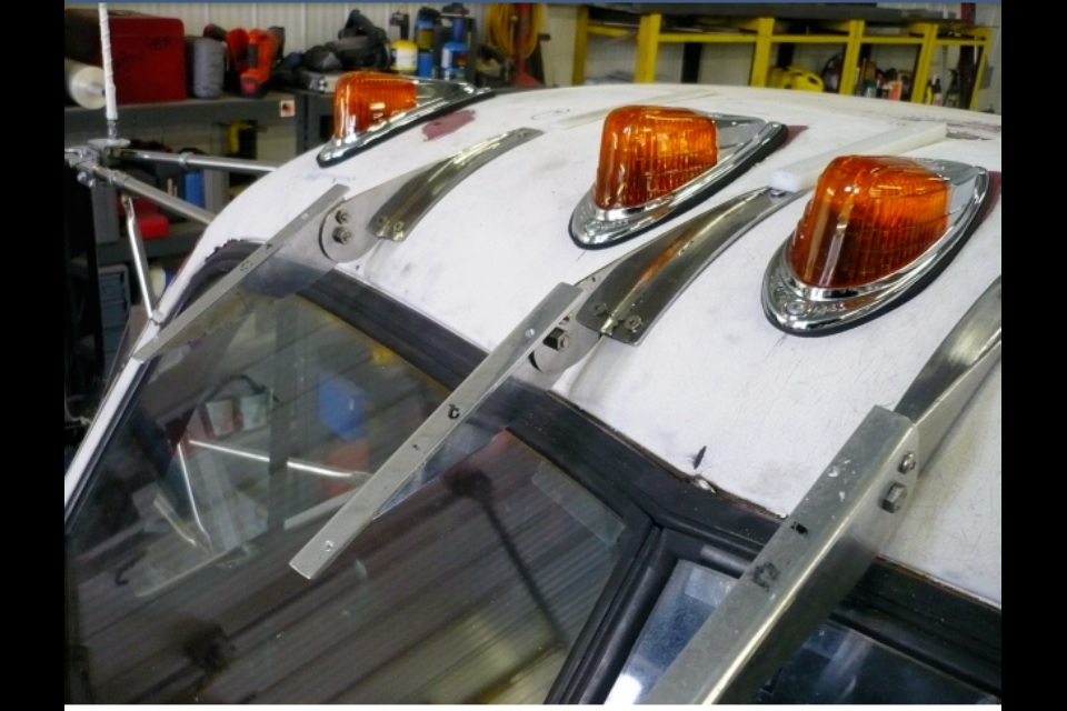

The problem I ran into when I made mine was mounting the ends of the visor.  The a pillars and visor ends don't match up due to diffrent angles.  I ended up using a 3/4" hole saw and cut 2 holes in each pillar.  Then welded 3/4 round stock in at the correct  angle to bolt the visor to.   The ends are very solid but I should still have some type of center brace.

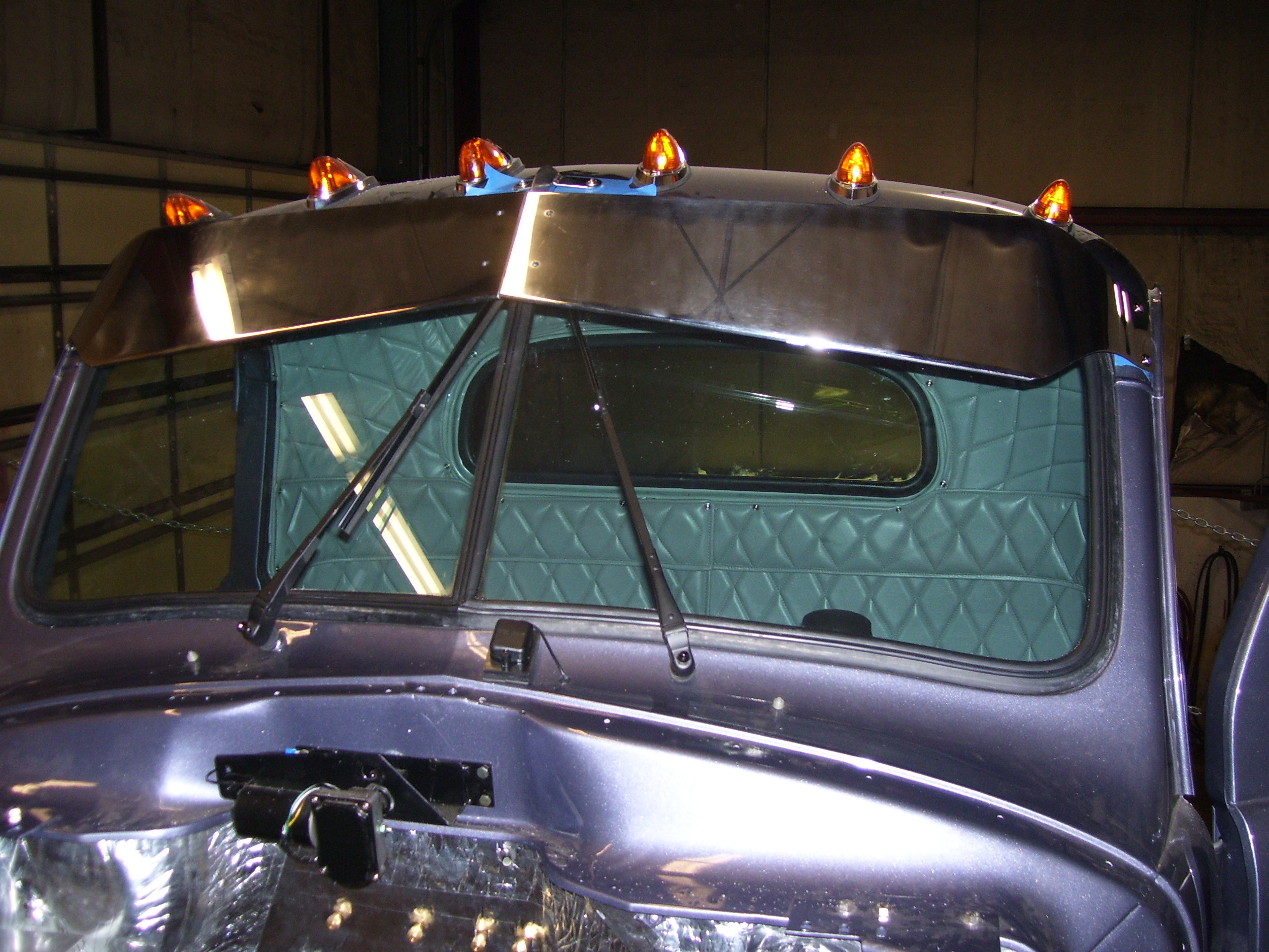

                  I narrowed this 379 Pete bowtie, had to reshape the ends slightly to fit cab sides and made a one piece center support
                  using 1/4" button head screws to hold it in place. Very strong/sturdy, the visor is 16 gauge stainless and heavy.
