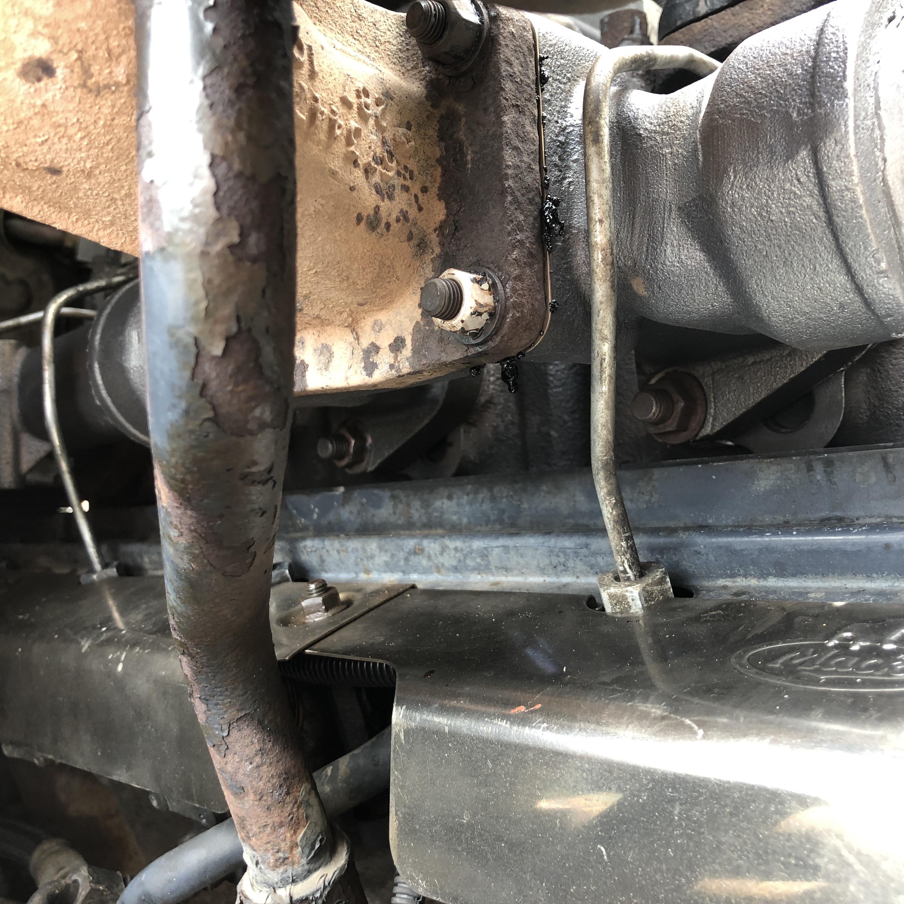

I wanted to list Sparksracing's (above) comments. He burned out an AI manifold and needed to replace it so he put the E-Tech manifold on his Aset and ran all original parts in tandem with a Programmer (he said Pittsburgh brand). The transition of surface mates can't be smooth, but its a mate.  Right off the line he blew his tube boot off and the thing went to smoke, hence the black tar seeping out the gasket. He got things straightened out and from his observation it sounds like the manifold turned him from a 460 Econodyne into a 460 Maxidyne.  :loldude:     First AMI460?
Ok
i have re-tested and all looks ok. No more slobber and normal black smoke, but more than before. The truck runs good for the moment, the only difference. I think is the turbo boosts a little bit slower than before. Before i would boost up to 32 psi now it takes longer to get it, but the truck has more power, it’s strange. I think all is ok. I think when the boot kicked off the engine was not breathing and a little bit of engine oil was go into the exhaust and caused slobber, cause now all is ok . Today it’s too hot 42 degrees outside and the pyro looks like normal, temps 8-900f, but when I let off the fuel pedal the pyros going down more fast than before. I found it more normal, it’s like my Peterbilt.
thank you so much
