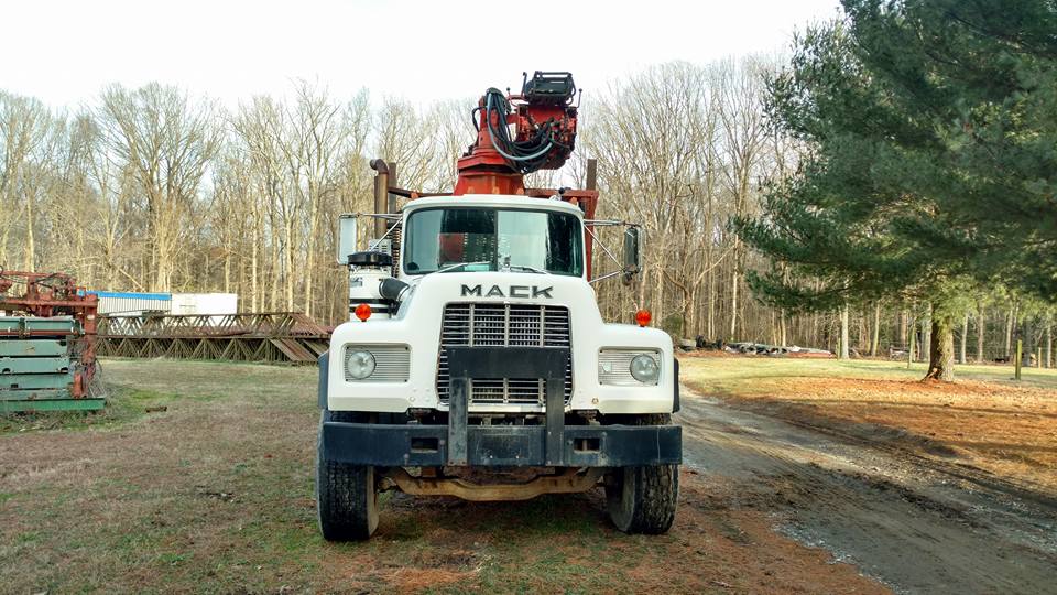

Hi All, I bought a 1988  R model tri-axle log truck recently with a Prentice 120 loader. Was a down south truck and clean compared to what you find up north here in New England. It has a 2070 Maxi torque 7 speed transmission. two lows and then direct five. Fourth to fifth is amazingly high jump (70mph all day ) I live in hill country and 4th direct is the max as I have delivered some loads already. Third is good but need a split gear between 3 and 4.  5.37 rears I believe, would it be cost prohibitive to put a 13 speed into this truck as I do plan on keeping it because it is rust free.  Does it bolt up if a Mack tranny is used? Thanks.

You can basically put any trans in you want if you have the right bellhousing. I have a 13 speed eaton/ fuller in mine. You'll probably have to shorten or lengthen driveshaft

i was in  the same situation as you    i had a t2080 mack tranny      3 lows and 5 highs    i had 573 rear gears     i went to an eaton 8ll  and had to switch my rears to 442 to maintain top speed      i like the difference       not such a big jump between gear changes   i had to shorten driveshaft a couple inches    i say go for it     its only money
