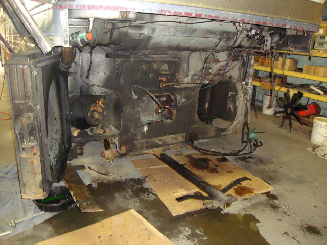

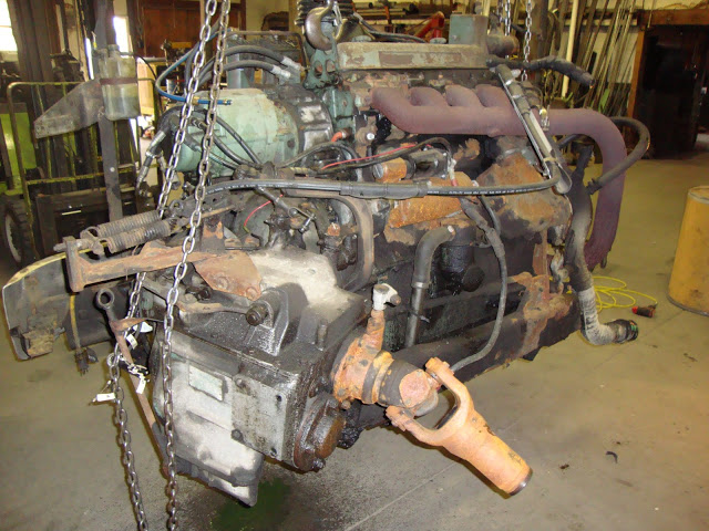

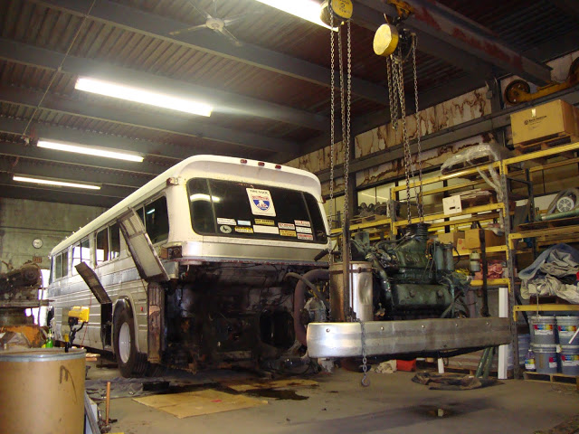

I stole a few photos just for educational purposes... it shows a removed "package" and the bulkhead with the diff showing on the left. Believe it or not, on some GM RV's with the bed at the back this is the fastest way to replace a starter on an 8V71/92..!!!
to find a 2 speed diff in the correct left side position is probably impossible... more conventional layouts of T drive buses is just like a truck but 180 degrees out and can be utilised in RV conversions..
