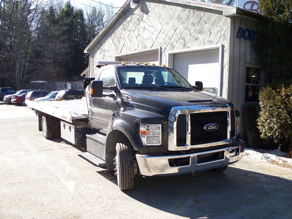

I hope it works out that the Ford engineers have done their homework. I have always been partial to Ford products but currently don't have any skin in the Powerstroke game. As an aside, I friend of mine has a brand new Ford F-650 roll back with side puller being delivered in about 2 weeks. I will take some picture of it and the engine under the hood. A gas V10 !!! He is sick of the diesel issues and the Duramax in particular of his current Chevrolet.
Jim, Sounds good. the 650/V-10 gasser makes a lot of sense for those that don't run big miles on an annual basis. Unless you run the miles, and/or you are always at the max of your GVW, gas makes sense and at this point I do believe Ford is the only player in class 6 (and 7 for that matter) with a gas option.
I would bet your friend has about 10 grand more in the bank from his upfront cost that he can use to subsidize his increased fuel cost.

Well, he has had for less than 12 hours now. Time to get it washed and lettered up and see how a V10 F-650 will perform.
Is that a Jerr Dan? Went by Jerr Dan dealer in Lancaster MA other day and looked like there was a dark (black or blue) Ford along side building-thought it might be your friends. Local U-haul yard just got a coupe of 650's in.
