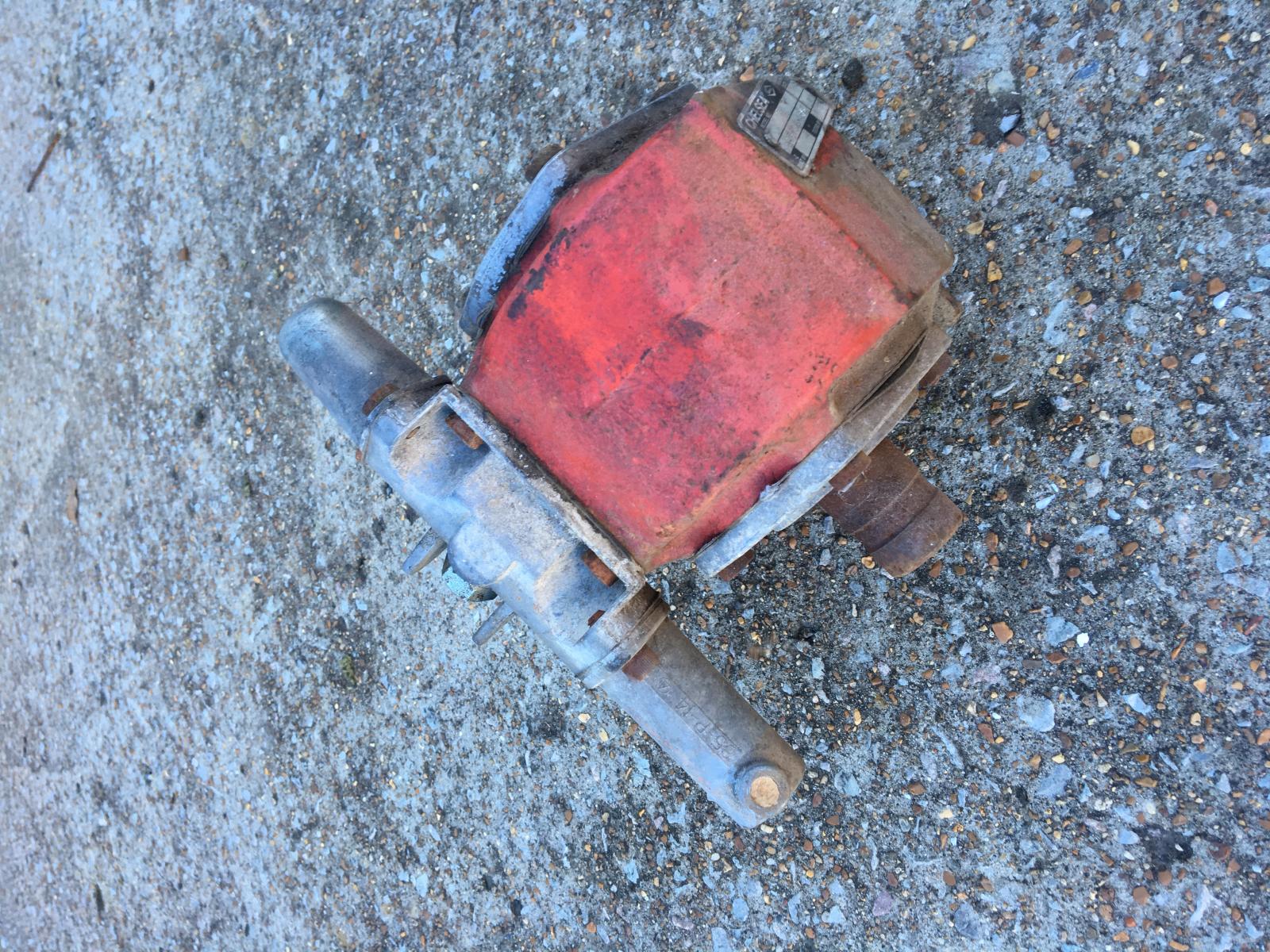

I've got a Chelsea PTO for a T2100.The reason I have it is when the T2100 took a dump, I replaced it with a 12 speed 1070 and the PTOs wouldn't interchange.
I now have another 12 speed that needs a PTO. I'm going to see if I can just swap the gears to get it to work. If not, the T2100 PTO will be available to sell.

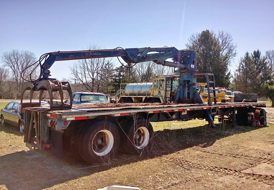

I know this is an old thread, but i'm looking to put a wet kit on my 84 mack mh613 with the  t2100 and am looking for some guidance. Local mack shop has no idea what parts to order. I'm trying to set it up to run a three line wet kit for pulling a logging trailer with grapple loader.

It's a 1988 Transcraft TL 100k-43 with a Hawk 1500 grapple. I'm not sure what the specs are for flow rate or pressure but i'll do some digging. As far as direct mount or driveshaft, what would determine that? I don't know much about wet kits.

IOW-don't guess on pump. If you didn't get one with the loader purchase.....get the right one. Are the I.D.'s of the pipes on that trailer two PSI pipes @ 1-1/4" and 1 return pipe @ 2"?
Looks like someone routed your stabilizer lines outside the receiver tubes? Can't see how those won't get ripped off?

Looks like all three pipes are 1-1/4. I haven't got the trailer yet so i'm going based on some pictures still. I went and checked it out in person once already and took a few of my own photos for reference.
The photos below I was going for rough measurements on the couplers, but it gives an idea of the pipe sizes. The third line is currently capped off. Current owner has never used the rig, but previous owner before him must have ran it as a two line.

I’ve still got the one posted above. It’s available and came off a 2100.
