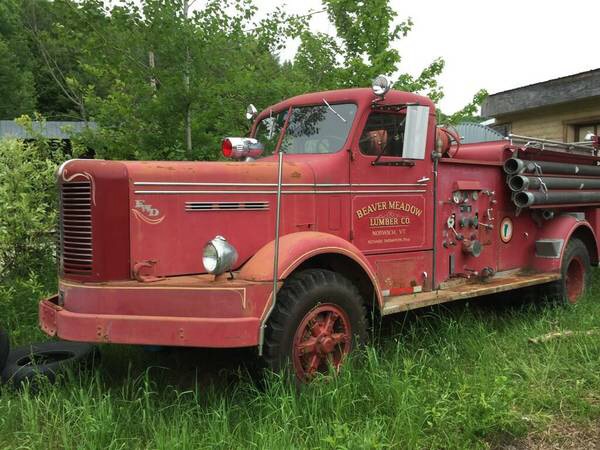

One way or the other I'll save it, as a fire rig that is no longer an option. I'm looking into a complete functioning 1949 FWD ex U.S. Forestry rig. 44,000 miles, new clutch, brakes and tires 1750 GPM pump used for an RV park - fair grounds, but I need to buy the FWD, a B-61 six wheeler and a B-75 ten wheeler tag set up. All or none as package deal. The 3 will fit on my trailer with some creative "stacking"
Going by the info and the owner input. I do/did think it sounded high though.
1949 FWD (4 Wheel Drive Division) Ex U.S. Forestry Fire Truck
4400 miles, 572 Cubic Inch Waukesha in line 6 Cyl. runs excellent, new tires, brakes and clutch. Eng has 2 plugs per cyl & 2 ignition systems, Magneto & Points, 1750 Gallon per minute pump, very straight.
There is no way in hell that is a 1750 pump- And I dont think the CID of the Wauky is correct either. First of all, a 1750 pump was unheard of back in those days- secondly one would never put something that big onto a brush/stumpjumper platform- there's absolutely no call for a pump that big (hell even 750 is a lot of pump for a stumpjumper.....) and lastly even if the 572 CID is correct (which I dont think it is) that's not enough engine to push a 1750 pump- Based on my rough calculations you'd need at LEAST 445 horsepower.......I drove a 1750 once and it had a 60-Series Detroit set at 500.
I betcha the Wauky is either a 140G series (554 CID) or a 145G series (817 CID)....Unless it's a model Wauky that I am unfamiliar with, but the 140/145's were the 2 most popular fire chassis engines and had the dual ignitions.
We will find out. I asked for chassis, engine and data info. He sent me the gov purchase id numbers and date of acceptance. We'll wait and see.

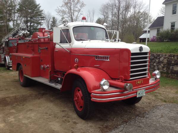

Wow! Nice. It's a lot bigger than the FWD I'm looking into. Bumper to rear step is probably equal to that ones wheel base!
