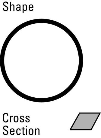

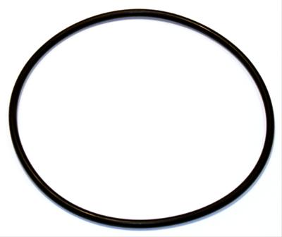

But, I have found 2 different housing gaskets (see pictures), and wonder if anybody can shed any light on it, without me having to take mine apart first. Might be a 121SB45.
The first gasket I have found, which might work in there, appears to be an O-ring...round cross-section. This is what Wix calls for for their element.
The other gasket I have found is a "beveled" cross-section. Personally, I would have called this a "diamond" cross-section.
Both these numbers come up on one cross-reference or another. Some of these cross-references would tend to suggest interchangeability between the 2 parts. But, when you look at the dimensions, the "diamond" one is quite a bit thicker.

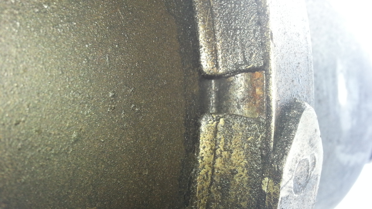

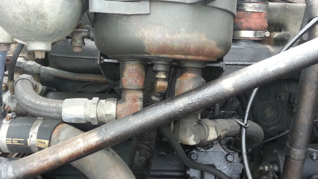

Looking between the gaps, at the shape of the bottom of the canister lip, it looks like it would use a round seal.

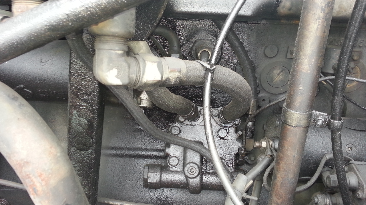

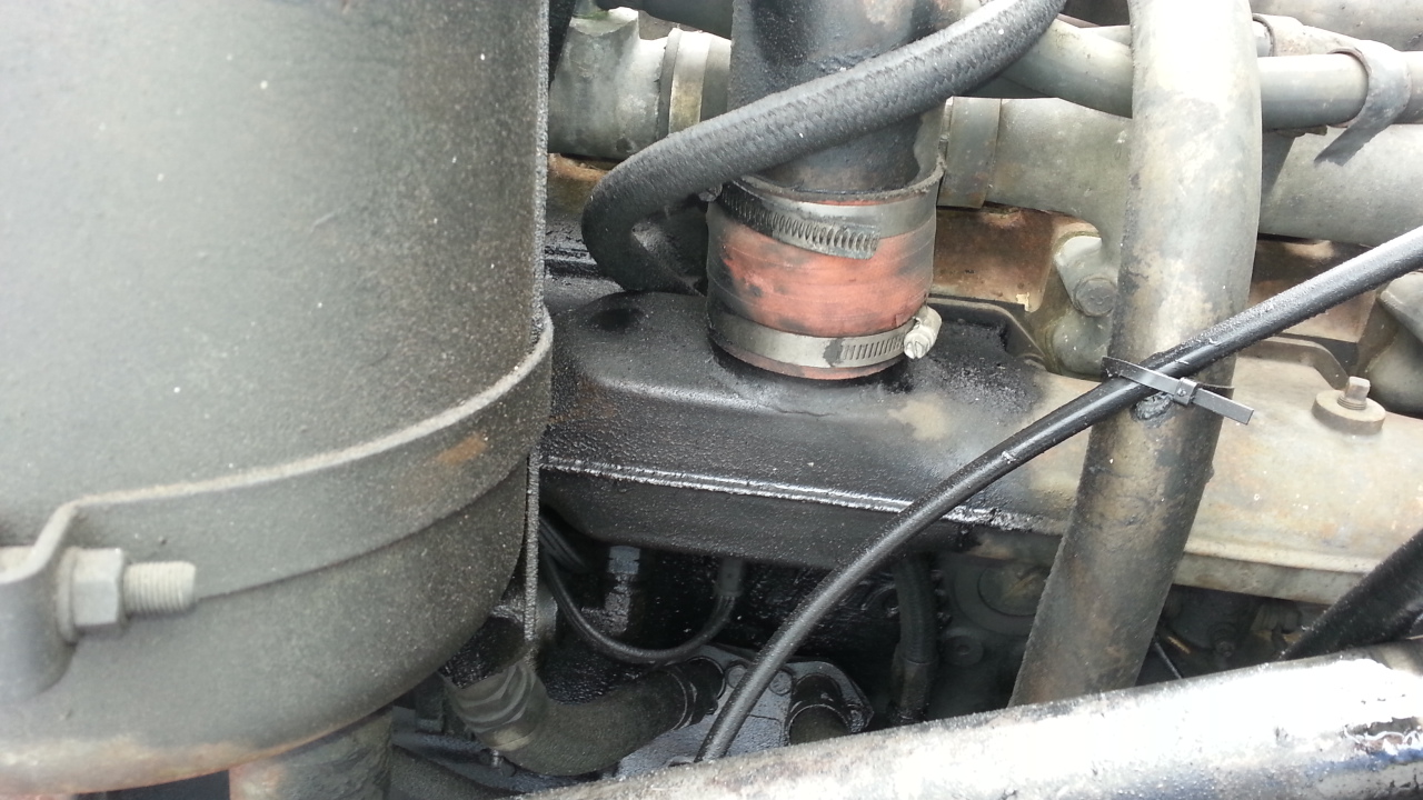

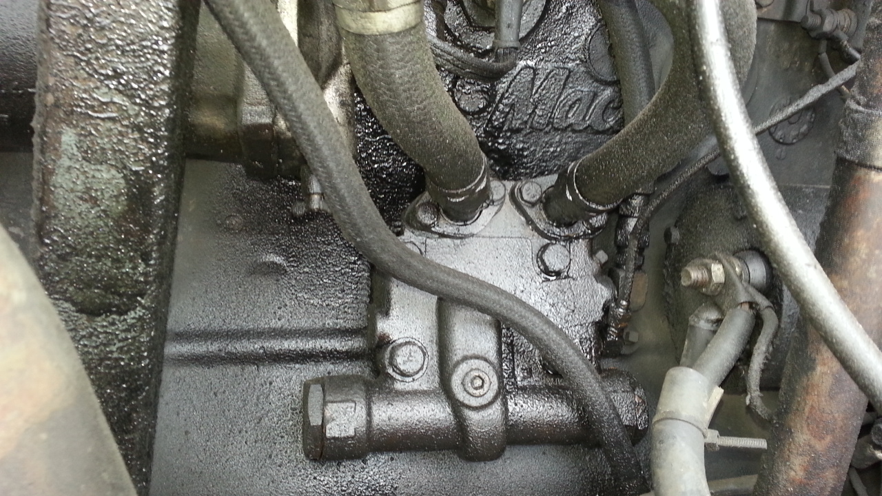

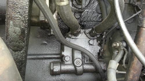

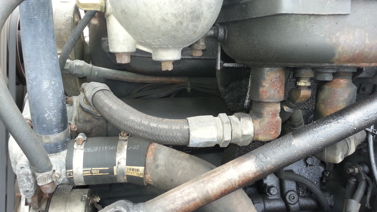

Here are a few pictures of the side of my engine, just to see if it helps anybody's memory...
post-11199-0-74421600-1407864111_thumb.j
post-11199-0-81960600-1407864135_thumb.j
post-11199-0-93967900-1407864148_thumb.j
post-11199-0-11301600-1407864163_thumb.j
post-11199-0-02916900-1407864180_thumb.j
I posted my project on a few other truck forums that I used to frequent.
I see you have an oil cooler, that will take into account also. Likely not needed since it is just a toy truck. Not sure how that comes off and if you can just bypass it?
Yes, the small line just puts oil back into the pan. I just removed the fitting from the block and plugged it. Typical spin on will not have that drain line, unless like Glenn mentioned it is a 3 filter set up with a spinner filter. Which I would guess would do the same, put just filter oil back into the pan.
My local Mack dealer had(got for me) the new plug to replace the block heater fitting. It was not a big deal to get apart, just some light heat with propane torch and a chisel broke it right loose. Wire brushed everything and installed the new plug.
Larry
