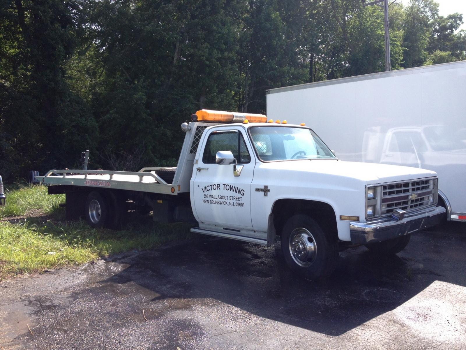

Thanks. Ill use this until I find a Mack rollback. The DM that was in Long Island the seller never got in touch with me. Nice part is this is old enough I can take it to some of the shows. I have a year to get this and the General ready for Macungie! The wife can follow me out there in this while I drive the big rig.
Hatcity. They were both beyond my price point. The MR is not what I was looking for and the SL is cool but again, not in my range. Ideally I need a 22-24' deck and wheel lift off the back.
There was a CH on eBay last year I was digging for around $15k but no wheel lift. I found an old ad that's still up on it:
http://twentywheels.com/view/12520-1992_mack_ch612.html

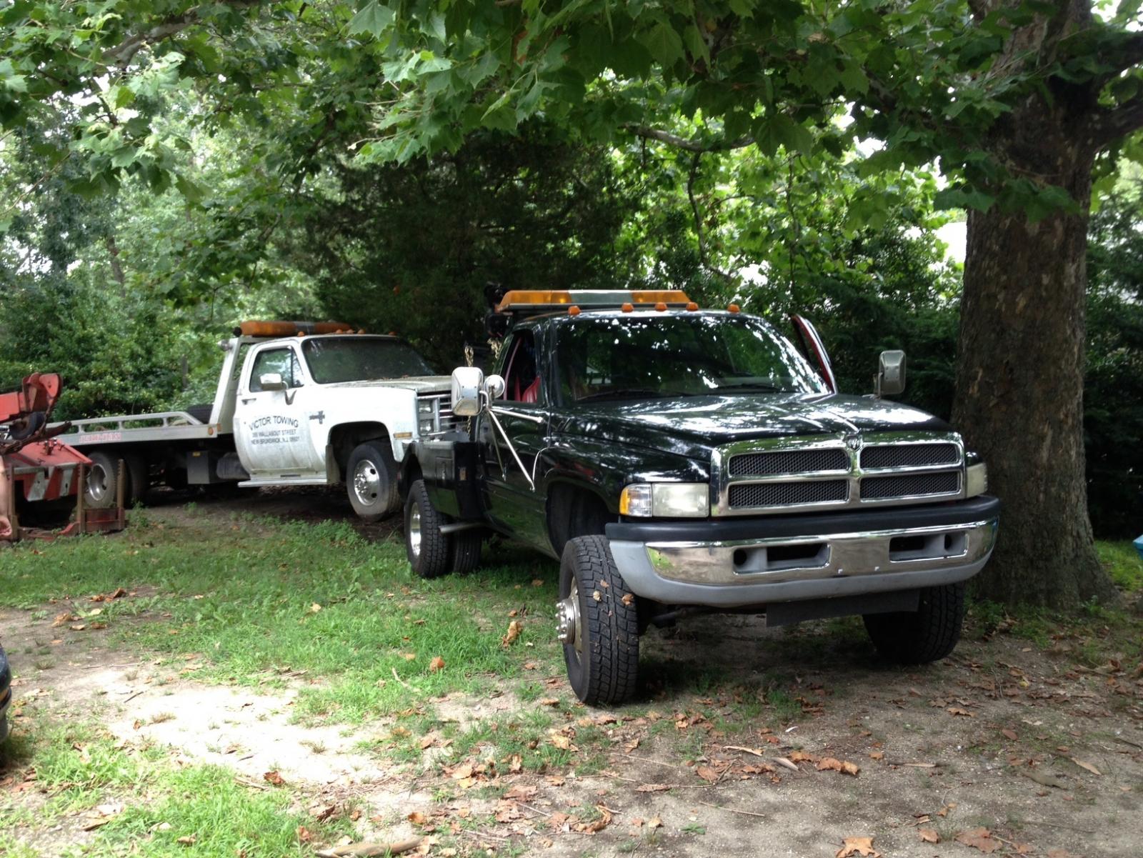

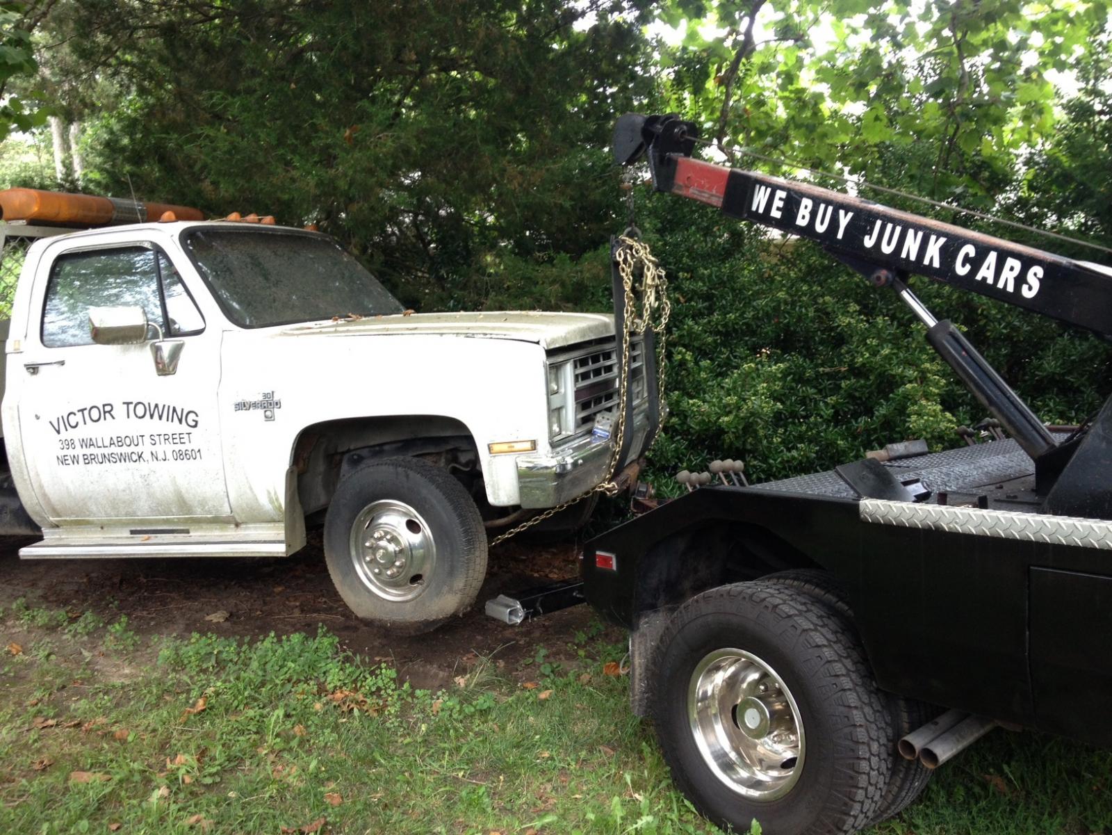

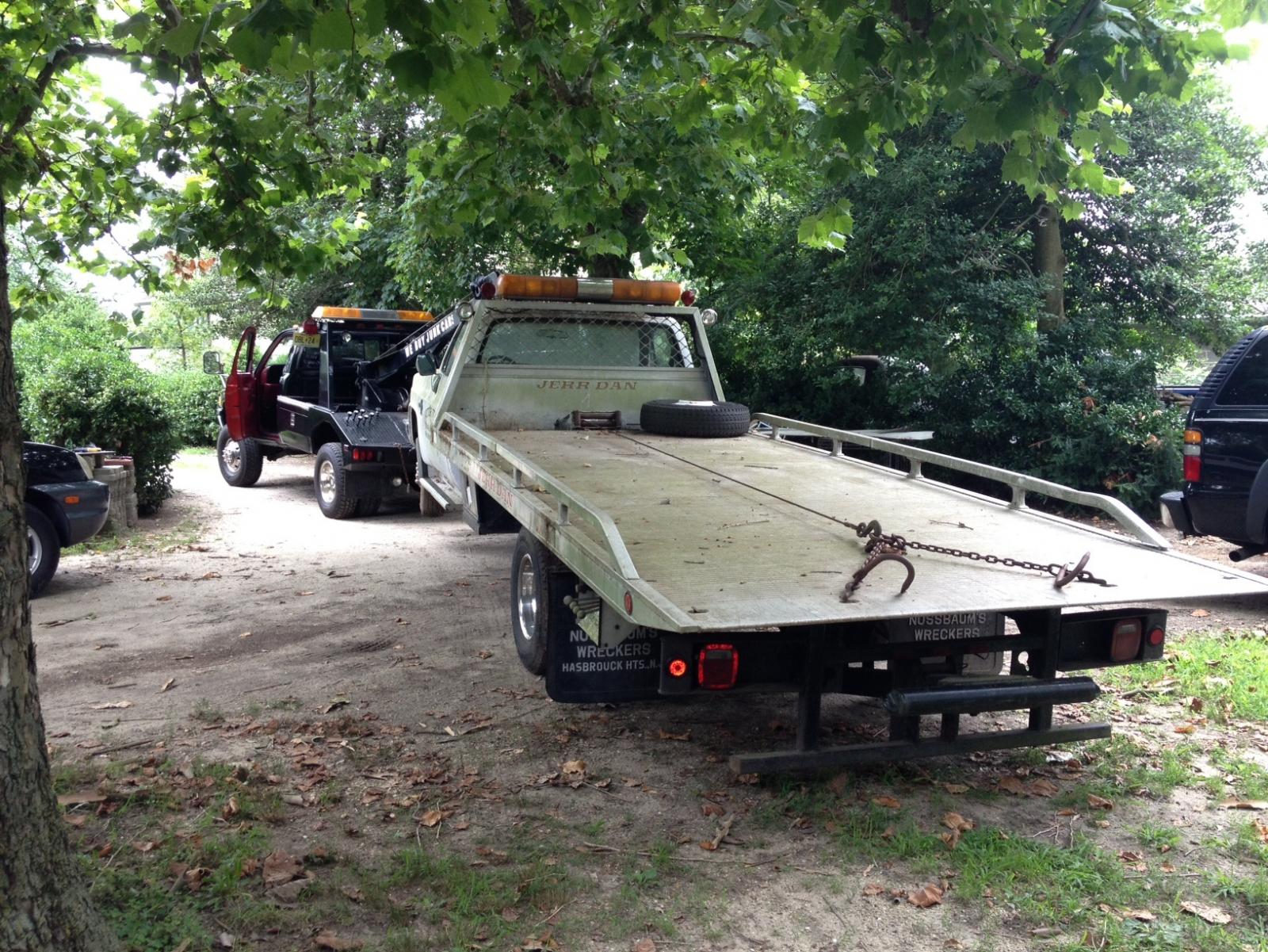

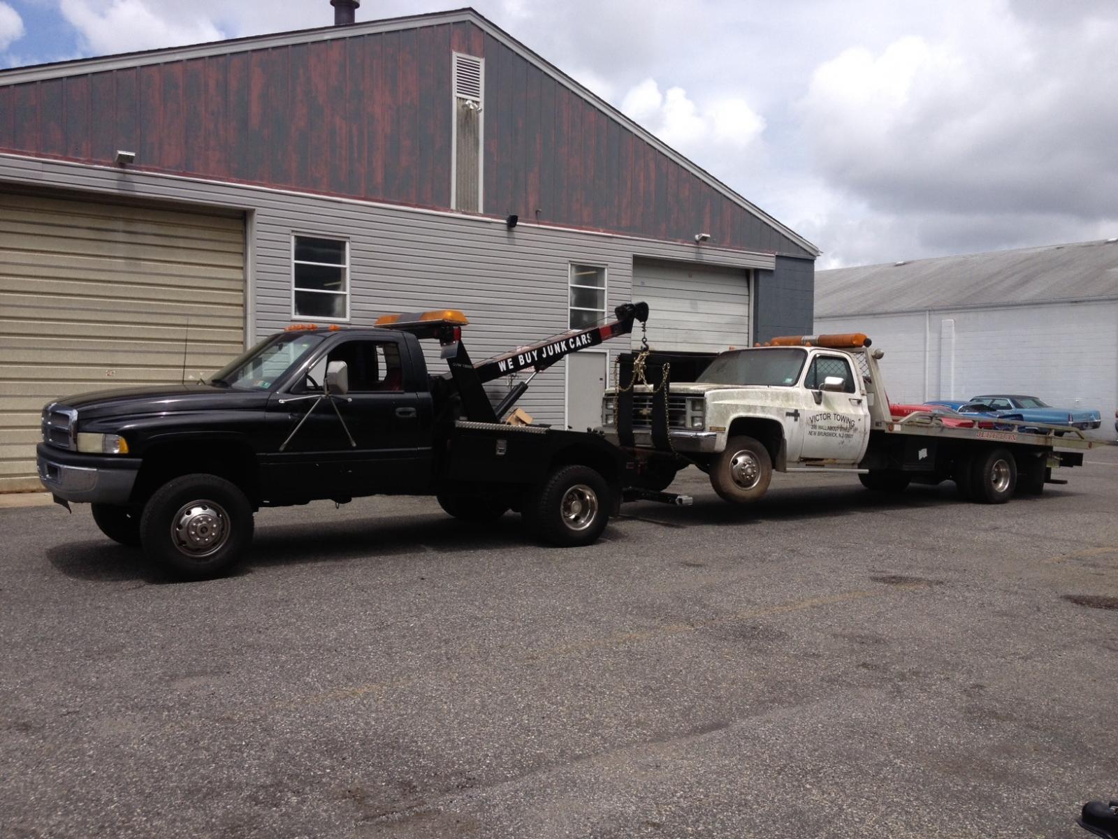

Tozzi, I was but this was 4 miles from me and a price I couldn't resist. I figured I would clean it up and use it until something else bigger comes along. With the low miles, I should be able to make a few bucks on it when the time comes. I've always liked these and this is loaded with options. It will serve me well for a while. I just need to install a hitch on the back to pull my car trailer so i can haul two at a time.
Quick update: got the ol girl running today. Just need to charge the battery and replace the starter. Fired right up. Idled rough for the first minute or two then smoothed right out. A/C even blew cold! I have a hydraulic leak in the controls for the rollback but it operates. Brakes were hanging up from sitting and felt a bit spongy but it stops. I am happy with the progress. I hope to get it on the road and working by the end of the week.

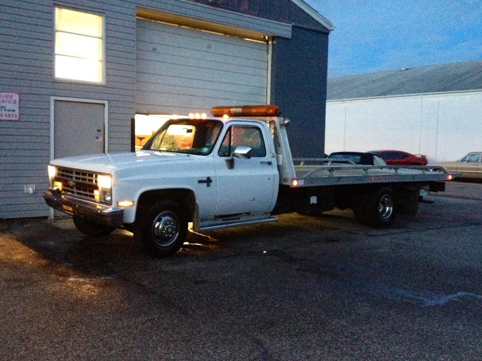

Does it have Vacuum assist or Hydra-boost? If it has Hydra boost and it's off the P.S. pump run it from lock to lock slowly a few times to purge out the air in the accumulator. When Hydra boost sits for a very long time a small bit of air works it's way to the pump and to the accumulator, it's the highest point in the system.
The DM on L.I. was an ex Town of North Hempstead Municipal truck, you didn't miss much. Paul
Paul, thanks for the Hydro-boost tip. I already did that as there was almost nothing left in the pump. Topped it off and ran it side to side until all was well and quiet.
Good!! Glad to help. Paul
