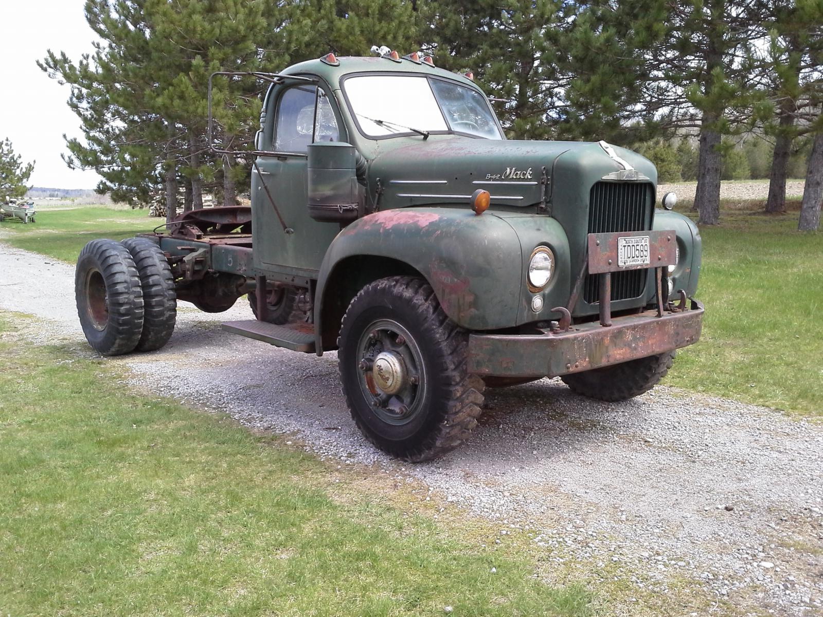

I received the Mack B42 from out west and am very impressed with the overall body and frame. Its amazing how clean all the metal is. A few dents here and there, I noticed what seems to be a few stress crack on the back of the cab. The interior is very straight also except for the seat. I checked the oil and threw a battery init but the starter would not engage. After crawling under to remove thr starter I see a 4" by 6" opening in the block were a rod came threw on the 401 gas engine. So that being said, I have sentfor information from the Mack Museum and looking for thoughts on a replacement engine and whether I should find a diesel or the original gas motor. The trans is a 5 speed with no 2 speed rearend. Just wanted to know any thoughts or ideas. I do like to keep things original but?

I did not know on the engine, it was purchased on line and has not been plated since 1981. I figured there was a reason they parked it and I am ok with it. I dont know if there are a lot of parts available for the 401 gasser or even if I have ever seen a used 401 for sale. I have some option on diesel engines but hard to find a donor truck in northern michigan.
