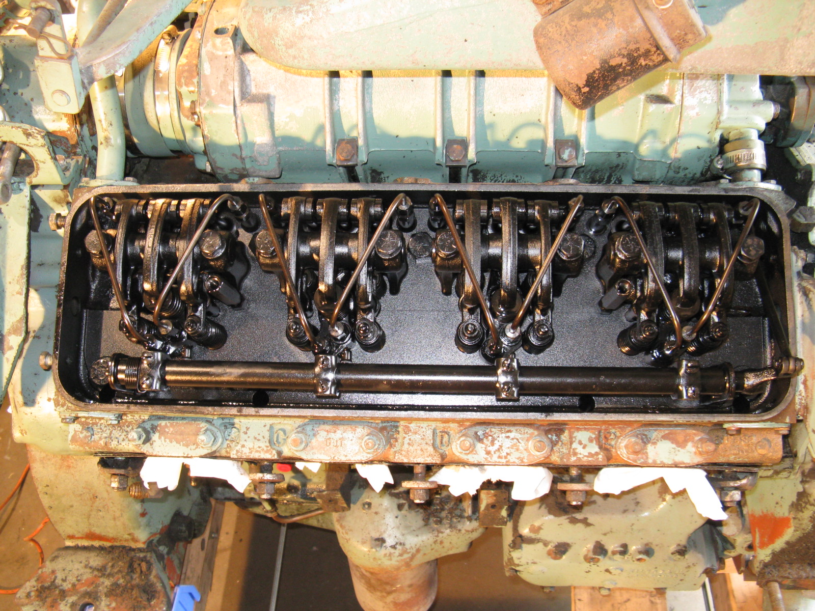

Get enough of it open and soak the parts with PB Blaster or some other favorite penetrating oil. It works although it takes time. That is an easy place to start. If that fails after a few weeks (reapply regularly too) you will need to think about strategic heating but that can get out of hand quickly. If you have no idea how to go about that you can mess stuff up quick. Use brains and caution.
Good luck
Also take intake hose off and look/reach down in there to make sure there is no obstruction. Like acorns or mouse nest, etc... Then, like gmerrill said oil it up. When it comes time to fire it up, Keep the intake hose off and a piece of plywood handy just in case. I f you haven't fooled with 2 stroke Detroits much do youre self a favor and pull valve covers then work the rack to make sure you don't have any stuck injectors. If you do and you try to start it 1 of 2 things will happen. It will either not run or run away to the point you wont be able to shut her down. A little penetrating oil on a stuck injector may help along with a little moving action. Good luck

as said by WS721, pull the valve covers, disconnect the link rods from the gov and move the shaft and watch the injectors... leave the rods off for the first fire up...
to free off the seized cross pins have you ever thought of removing the intake and dumping it a bucket of diesel??..the intake flap is spring loaded, check that works too...

All good info so far, I would pull the covers, check the rack and injectors for travel and pull the intake shut down and free it off the truck. Then just re install the intake, valve covers and fire it up. I have to pull valve covers and free stuck injectors every spring at CSX, all the older equipment has 2 stroke Detroits. I had a crane I had to pull the cover and free a stuck injector twice in one year due to lack of use.

I keep a fire extingusher handy and have the intake hose off so I can spray it in the intake if it runs away, its gonna trash the engine anyway so I might as well save some fuel and time cleaning up a scattered mess.

Keep a carbon dioxide fire extinguisher nearby, not a dry powder type, if you want to save the engine if it does catch fire. The dry powder will corrode, and ruin, everything it comes in contact with.
I have been using a mix of 90% acetone and 10% auto transmission fluid as a "rust buster". Seems to work better then Kroil, etc.
