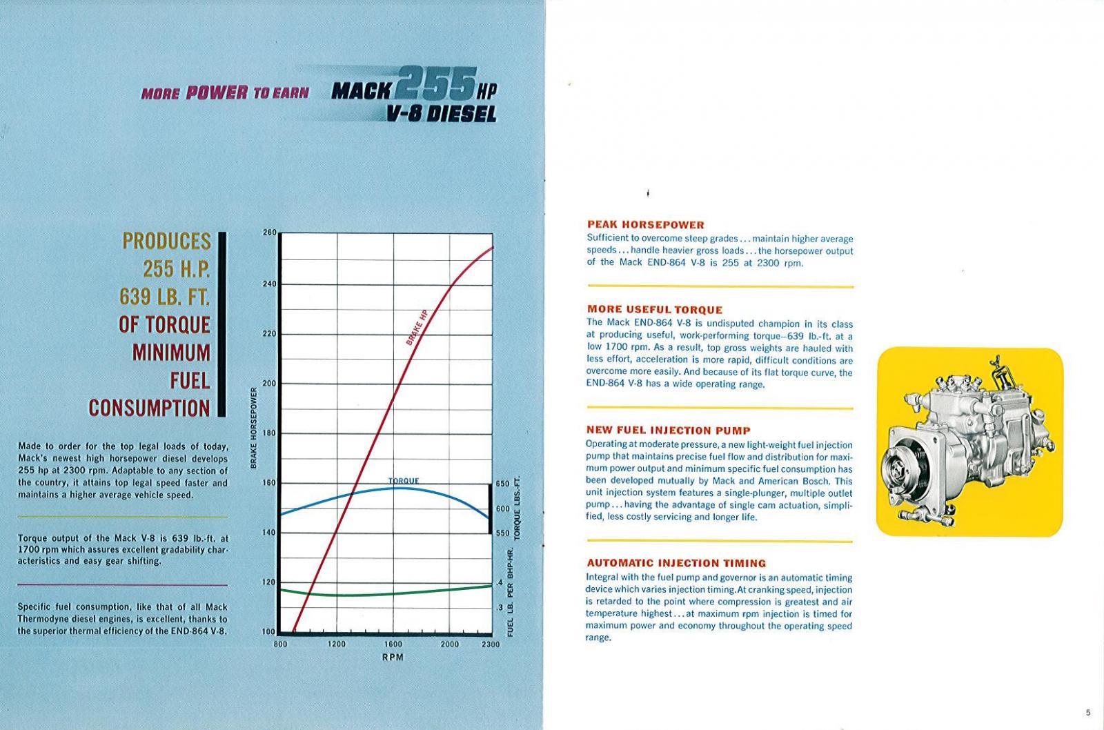

Cool brochure. Thanks for posting it. That injector pump was the weak ling in the system. I can see they had a good plan with all the stuff being gear driven and easy to get at...that pump just didn't last.
I was never a fan of the rotary pump. but I recall the army's multi-fuel engines had rotary pumps (i.e. LDS465 and LDT465 in M35 series trucks).
:SMOKIE-RT:I believe those were rosa master pumps developed by a Stanadyne engineer. The one rotating element had to supply all 6 or 8 cylinders. To much work for one part. Unlike the in line and v bosh pumps where each plunger could take a rest while the other 5 or seven supplied fuel. These pumps were on the early ford 6.9's and 7.3's. Would usually last about
100,000 miles. Rebuilds were about 300-400 dollars. Now one new ford injector is about 350.00 dollars. I think we are going backwards as far as maintenance costs and replacement parts.
These were American Bosch pumps (as were the pumps the those M35 multi-fuel engines)
