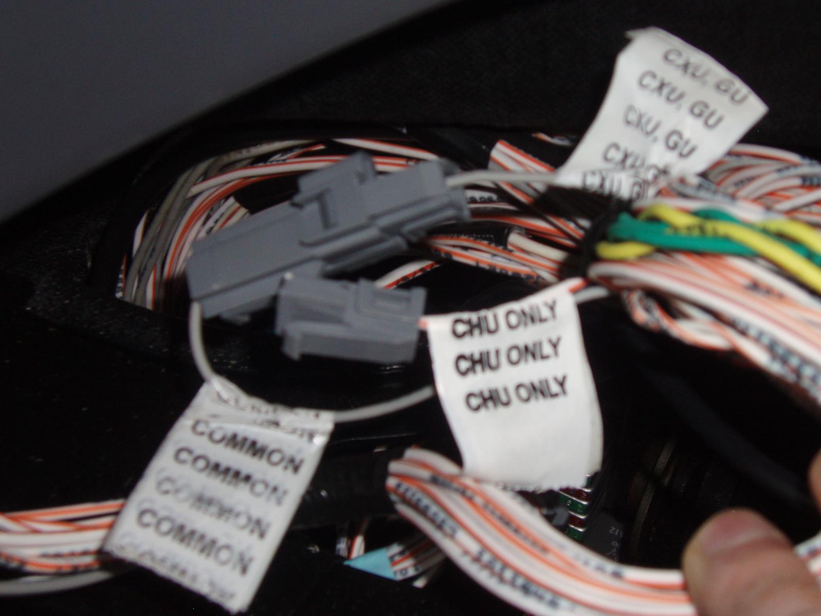

Make sure that behind the dash cluster, that the factory pugged in the correct wire according to what type of truck it is. We found lots there were incorrect and were burning up hood harness.
