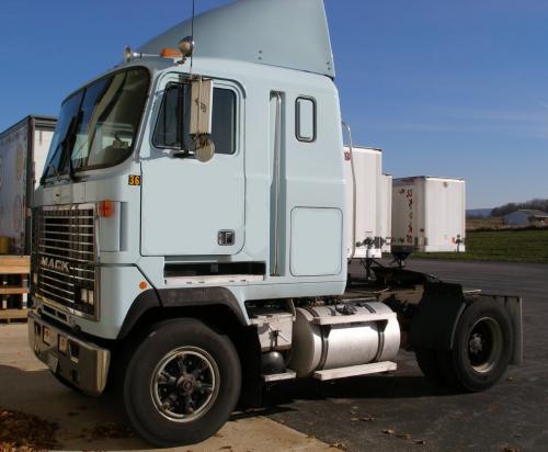

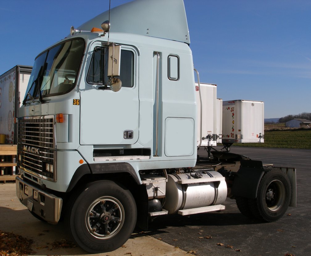

The glad hands on your trailer are on the drivers side as are the hoses on a MH. Install the door front and center. Add a deck plate, steps and handrail to the passenger side of the truck. You keep the trailer side smooth, don't violate the integrity of the bottom rail, and you don't have to crawl over the fender of what ever your hauling. When you upgrade to a conventional daycab you can go from the truck straight to the trailer. LOL
David - good point about the lines. I will have to look at the right side. The MH has dual tanks and I was thinking about removing the right tank and installing a step toolbox. Someone suggested I keep the tank. If I keep the tank, I could install steps like the left side. I already have a deck plate and I think I saw a handrail attachment. Good suggestions....nice of you to spend my money! :whistling:

Mark I see a side door. It is on the driver side. (On theMack)not the trailer.
mike
Only problem is,that door is very seldom used when i'm on the inside!.........................................Mark
