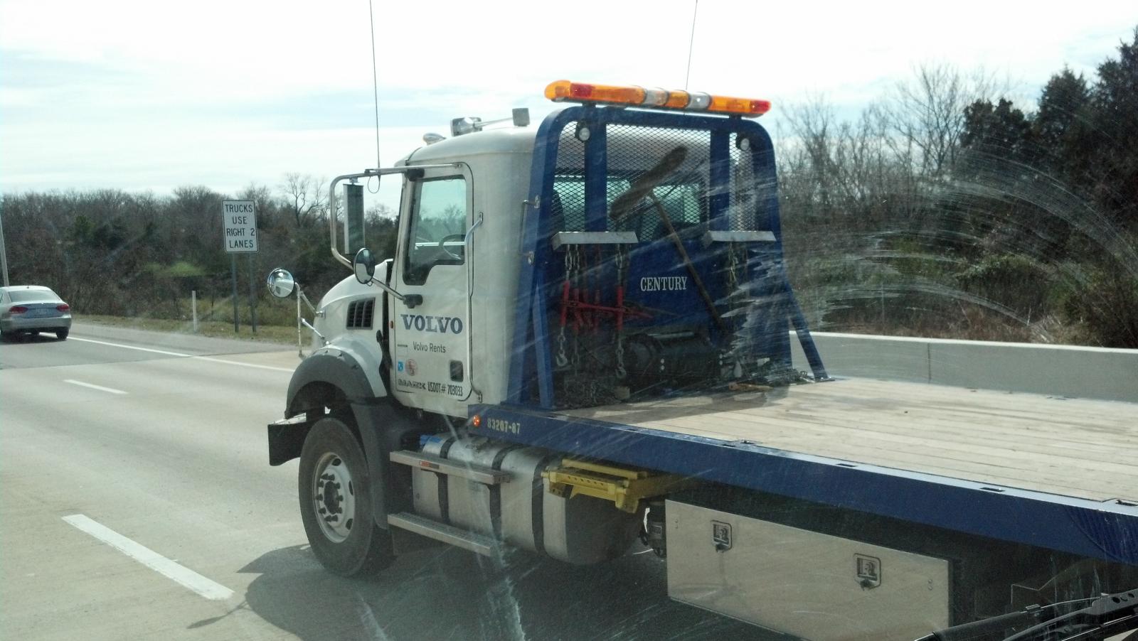

Even Volvo would rather have a Mack
Volvo owns Mack and the GU is a Volvo with a bulldog on the hood, makes sense to me. Its just a reminder on who runs the show.
A Volvo with Mack Rents on the door would be a better way to drive that point home. Those who would find this picture unusual already know the back story.
