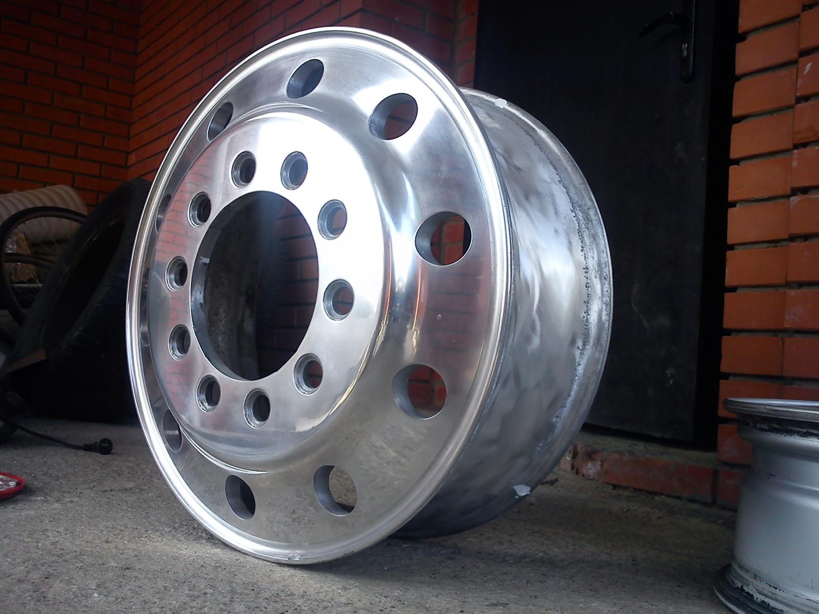

Mine had deep corrosion when I looked 'em up close. I mean max.close.
I had to cut off no less than 1 mm of surface with a big lathe.
Than sand them hard with 240 on a wooden block to flat waves. It took 2 working days for each one.
After 240 I made 600, 1000 and 2000 wet during 1-1.5 houres and polished with just a cloth by hand in half an hour.
Of cource I tried soft disc with green agent for a first but got black stains where I touched it. Needed too slow revs.
So continued with a piece of leather and got a bunch of little scratches.
Ended up with chrome polish and clean cloth.
And again, when I look them over up close I can see little black traces inside aluminium. Wonder what acid would do if it penetrates into :whistling:

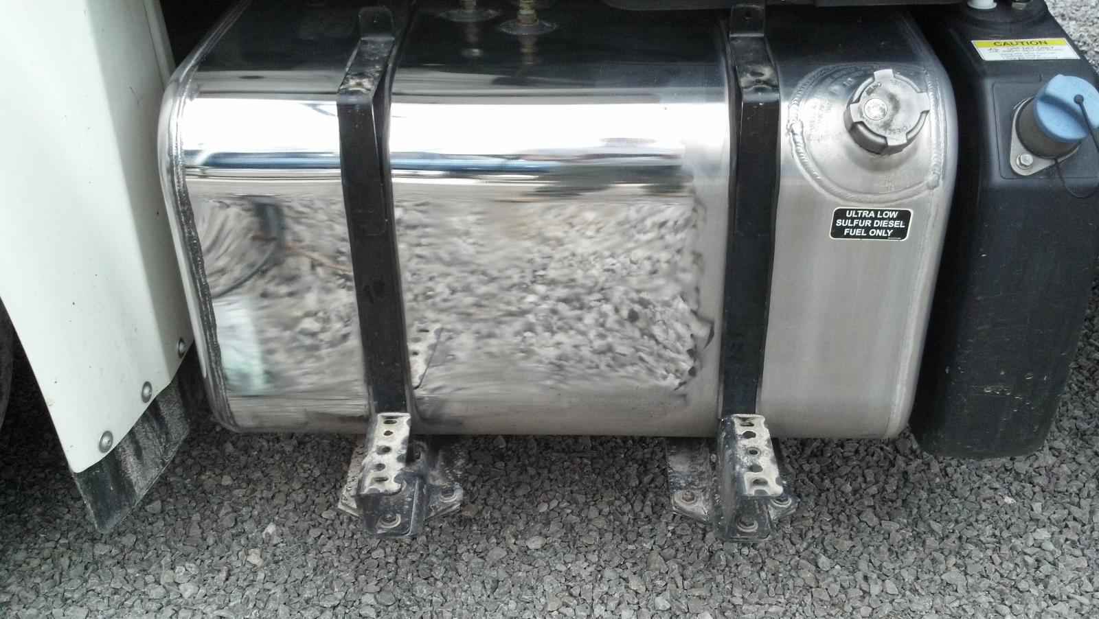

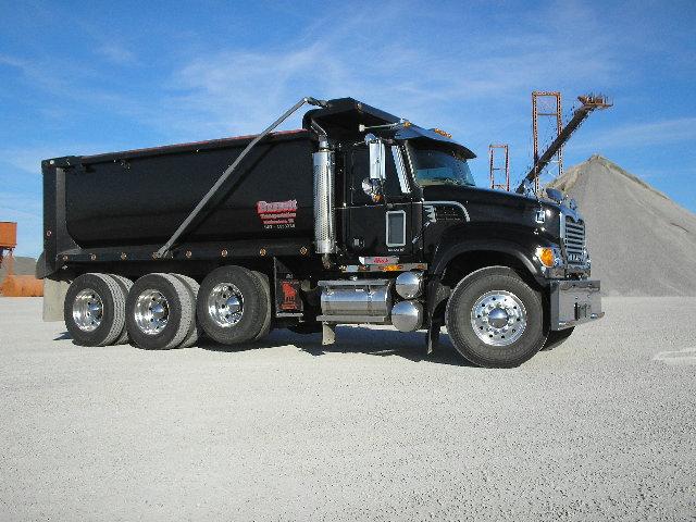

I got into a polishing project today, my new company truck has an aluminum fuel tank that was unpolished figured id get it done while it was nice out.
post-5240-0-85304500-1362867787_thumb.jp
Brilliant...!!! pardon the pun...

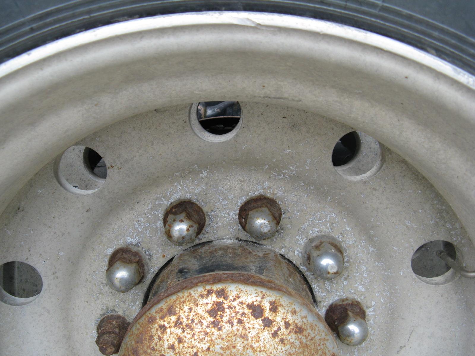

need some advice for a newbie polisher...
my rear wheels look like they have never been polished, or, at least for 10 years. Some pitting corrosion has set in and I'm sure when I remove the wheel nuts I will find more problems..
I have used Alodine previously to remove corrosion out of pits in aluminum plate, any probs using it on truck wheel rims?
are these wheels beyond hope of ever shining again?
I have heard, but not yet seen the results of, machining a small amount of aluminum off the rim as a solution... I assume it is done within factory limits for material remaining.... anyone had this done??
added a pic of my worst wheel, hope the res is good enough to see the pitting...
advice gratefully accepted
BC Mack
post-10384-0-35422800-1362887093_thumb.j
I would sand em then machine polish, I think they'll come out ok, when sanding don't use force just let the sander or sand paper slide across. It takes longer than applying pressure but you don't get sanding scratches and you won't have to wet sand before machine polishing. I would start with some 200-300 then work down to 800 then hit em with some green jewelers rouge on a stiff yellow buff.
