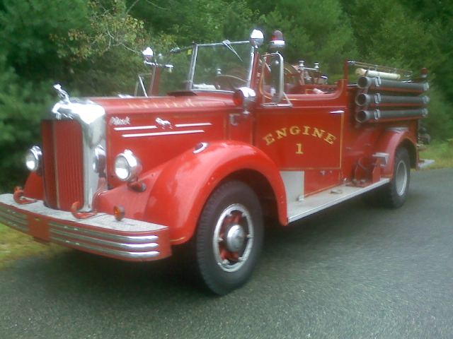

hi louie ,your mack looks great, now the clean up begins, looks like in great condition, If you need to paint the diamond plate on the running boards a lot of guys use a mix of Rustuleum white,gray, silver for a nice finish (plain silver will rub off).

I've never heard of this. I have been painting steel diamond plate on fire trucks since christ was a corporal and have never had any problems with plain silver. Sure it rubs off after several years at contact points (like where you step to climb in.....) but other then that no problems at all?????????

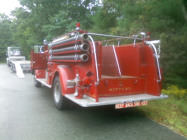

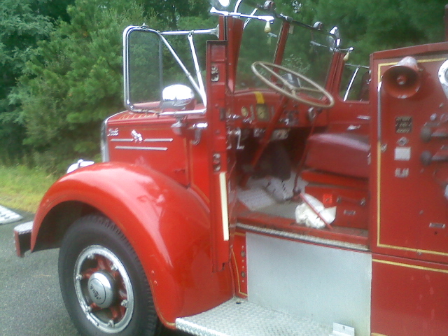

Yeah I definitely need some paint for the diamond plate......any suggestions as to what mix, color, or brand you guys have used would be helpful. In looking at the truck it seems like the running boards unbolt......anyone had luck doing this? I also am looking for someone to do some chrome work? Thanks for he help
Yeah I definitely need some paint for the diamond plate......any suggestions as to what mix, color, or brand you guys have used would be helpful. In looking at the truck it seems like the running boards unbolt......anyone had luck doing this? I also am looking for someone to do some chrome work? Thanks for the help
Edited by Loadstar
Congratulations on the purchase and getting her home expeditiously. Regarding the chrome, do you mean you want some rechromed?? Hard to tell from photos but before you go through the cost and hassle of sending stuff out for refinish, try a really good polish like Maas or Flitz. If you have any light pitting, Flitz sells a buffer that goes on a hand drill and is good at getting out light rust or pitting. If it looks cloudy/rusted or pitted, before you rechrome try quadruple ought (0000) steel wool with Flitz or Maas. You will be surprised at how good it comes out. DON'T use a drill with any type of metal buffing wheel. If you can't find Maas, let me know and I'll send you some. Flitz is easy---ebay.
You probably already know this but I would change all the fluids ASAP. Especially important is the pump transfer case. Many apparatus don't get this checked while in service so it is essential to make sure you have fresh oil of the right viscosity on board. Same goes for the cooling system

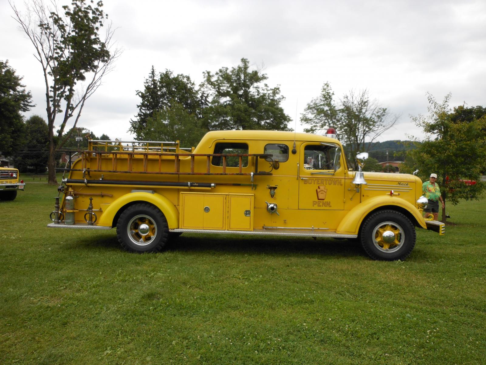

They changed the fenders around 1948. My truck was built in 1947 (85LS1101) and has the old style fenders. Harvey Eckert calls these high crown fenders. You can easily see the difference when you compare them to the fenders on the truck above. These are the same fenders as used on the commercial L models. The others were only used on the fire trucks. I do not think they are not the same as were used on E and A models, but are of similar design.
