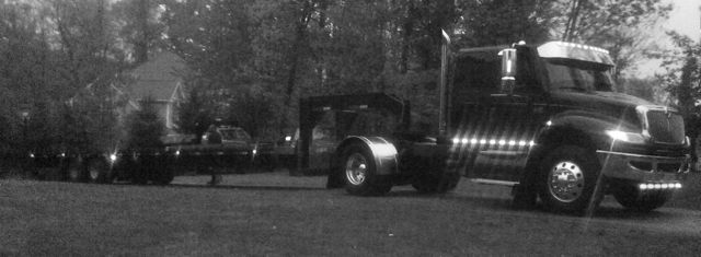

I would not put that thing on a International Lo Pro bed. Extremely top heavy and most likely it will be over loaded. I know my single axle b61 is 12000 lbs. How far do you have to move the truck? I have a International 4400 with a 40' gooseneck. I might be able to give you a hand.
Tom
Also, Im only in Sussex NJ. Id love to go and check that thing out with ya if you don't mind.
