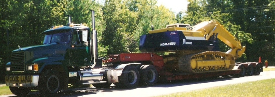

Sharpest CH I've ever seen. Mack Green with black spokes and some bling. Perfect.
Jim

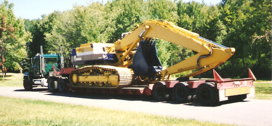

Thanks guys, Here is another angle. This truck went like hell and loved having the thirteen speed. Pulled 6 jersey barriers back to the yard one day and had a stage coach thinking he was gonna pass me all the way from New Haven to Hartford....didn't happen and as I got off the exit ramp as he went by he got on the horn and said, Lowboy....you can really move the mail! That made my day for sure.post-426-0-24559300-1336259973_thumb.jpg
