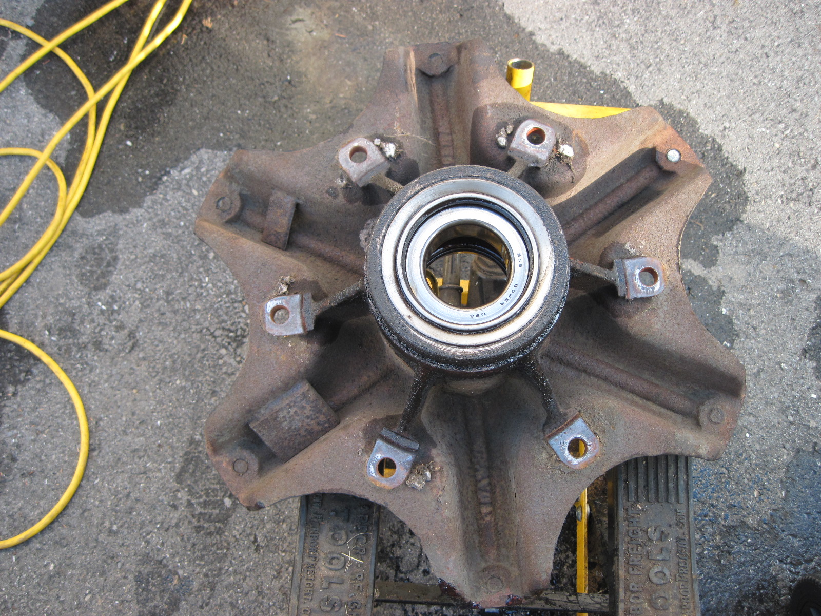

The Mack Dealer spin balanced both steers on the truck...on the pass side, there are two pcs of flat steel welded to the back side of the hub presumably for balance...
The drum wheel combo (pass side) has a heavy spot, when I took the drum off and mounted just the wheel, there was no heavy spot.
When it warms up a little, I will remove the drivers side drum, and swap front rear tire on the passenger side...
post-6773-0-80982700-1323437766_thumb.jp
