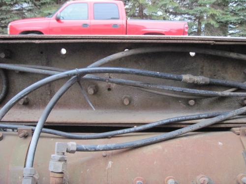

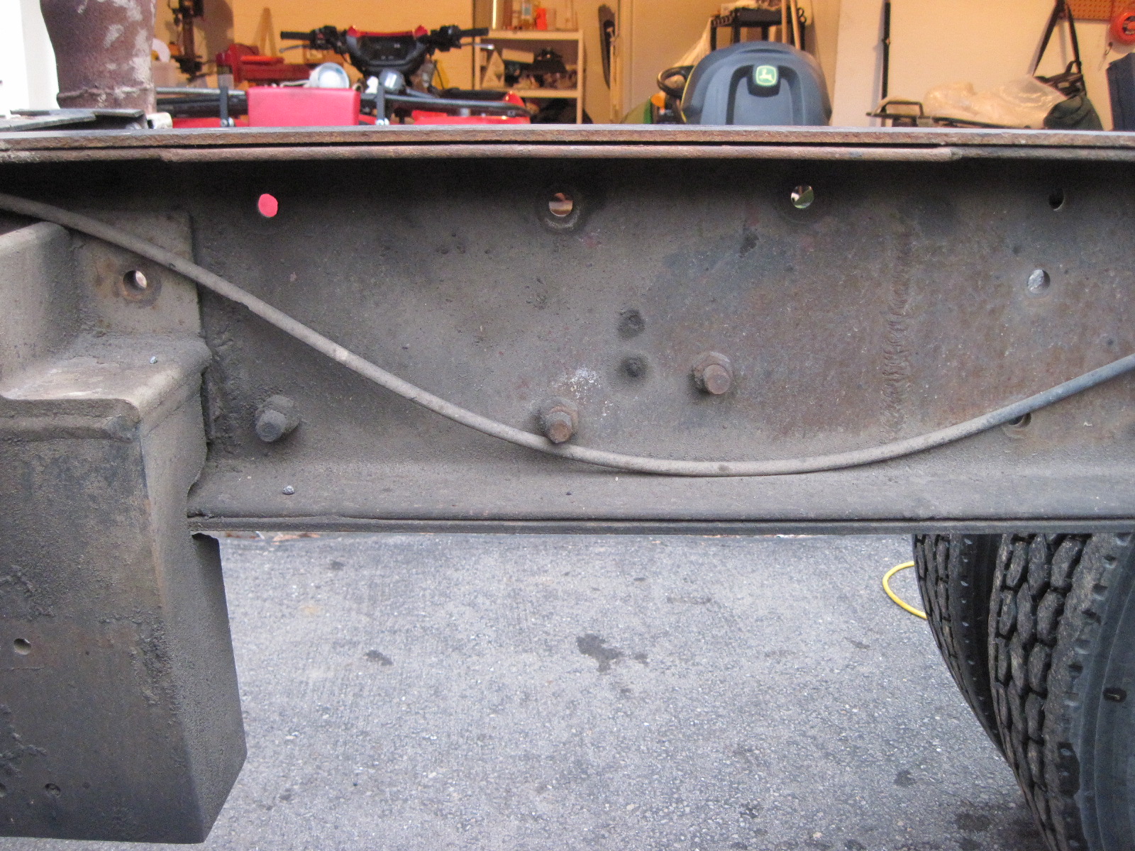

If the frame has been shortened could you take some pictures of the frame from the back of cab to the fifth wheel and post them when you get back?
Here are a couple of the pictures...only the inside frame was shortened...dont know if they bought new rails or what, but the outside rails are NOT spliced...also, cant figure why there are two cuts on the inner rails...

Every hole in the frames should be nut and bolted together with fine thread grade 8 fasteners. Especially where the splice was made. There is the flex in the frame rails as rob mentioned.
Yes, that many holes in line with one another is bad news. Close them as suggested and tighten each fastener you can get to before proceeding further with isolation.
Rob
Also I don't see any cross members could you take a picture from the rear of the truck showing the cross members. Also are the bolts body bound bolts, this would help with strength? The old rivets worked quite well but it is hard to replace them in the field.

The only cross members are the one at the back of the cab and the one at the rear, these plus the trunnion mount is all there is...I will start tightening and filling holes...
Thanks
There is your problem, not knowing how much space from the back of the cab cross member to the trunnion, you should have one cross member right in front of the of the front drives, and have no more than two feet between cross members. Your frame is flexing in this area causing the wobble. Mack used to have a couple of different cross members that you can put in with out pulling the bogies. Maybe someone that works at a Mack dealer can help you source them. I remember that the were not expensive and not hard to put in. Mike
My thoughts exactly. I've made the crossmembers from 1/4" wall tubing and bolted webs through the rails, and the new crossmember. Get everything tight.

exactly. I think mack still sells a three piece one that you don't have remove the the boogies just measure it out use existing or drill new holes.
