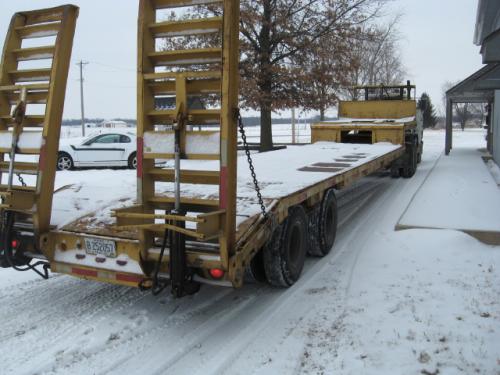

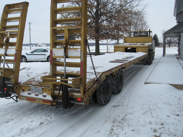

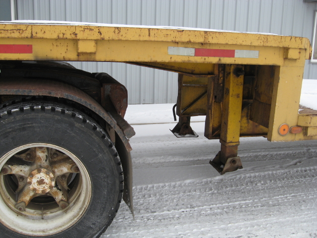

Wonder if S-Cams are siezed? service brakes as well as spring brakes not working maybe trailer needs some work :pat:
The trailer does not have spring brakes. There is a plastic looking valve the air tank feeds and has four hoses attached that run to the service chambers. These hoses do not have any air applied to them so no "S" cam action, or brake application. I don't know if the pilot line is supplying air or not at this point, or the valve is stuck. I got the truck winched out of it's predicament and put it inside the building to warm up.

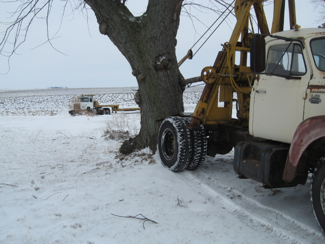

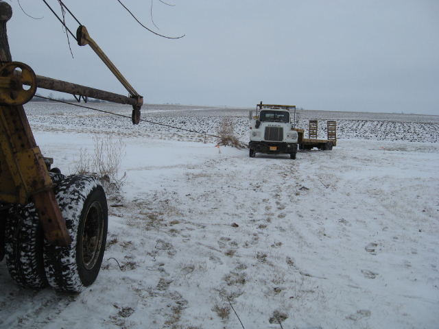

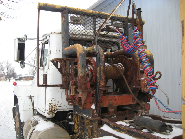

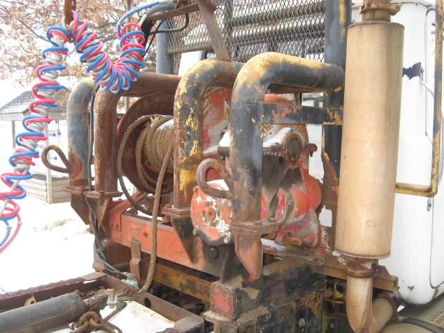

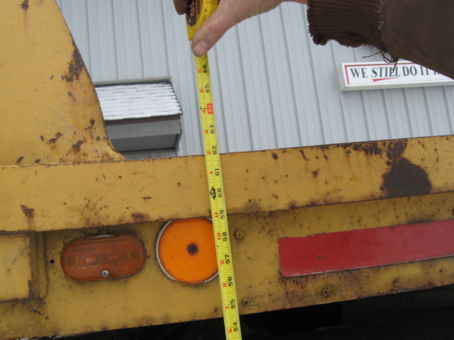

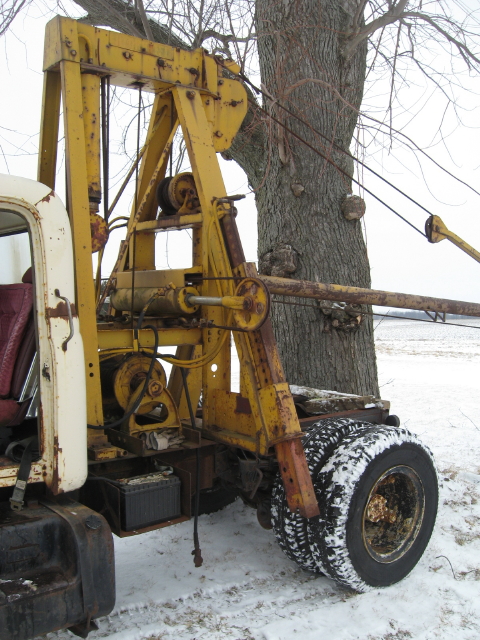

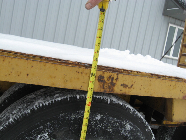

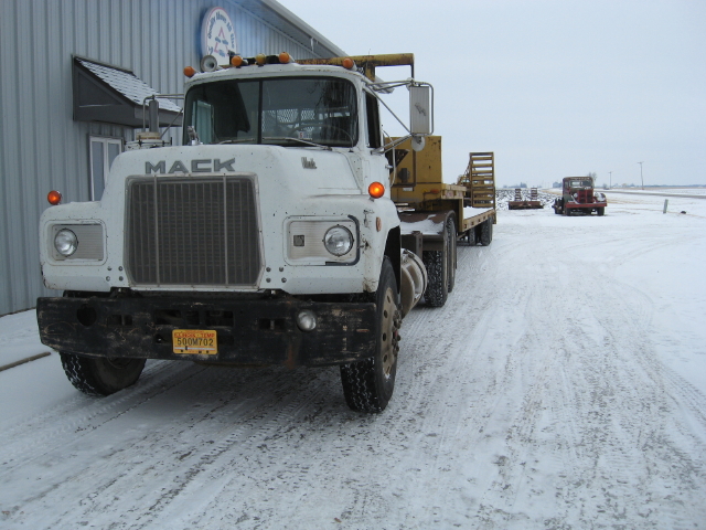

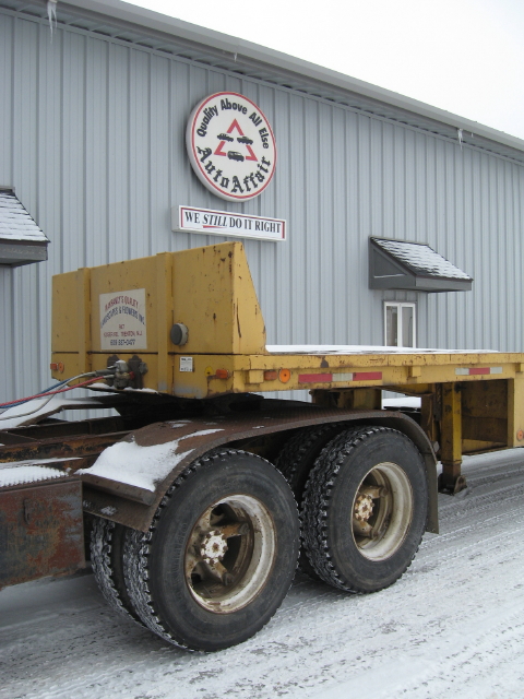

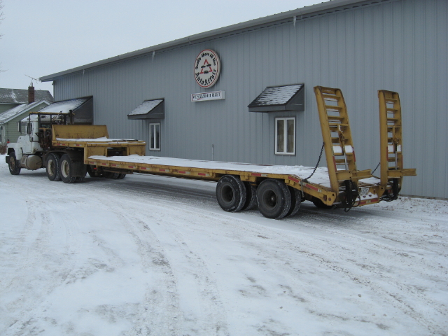

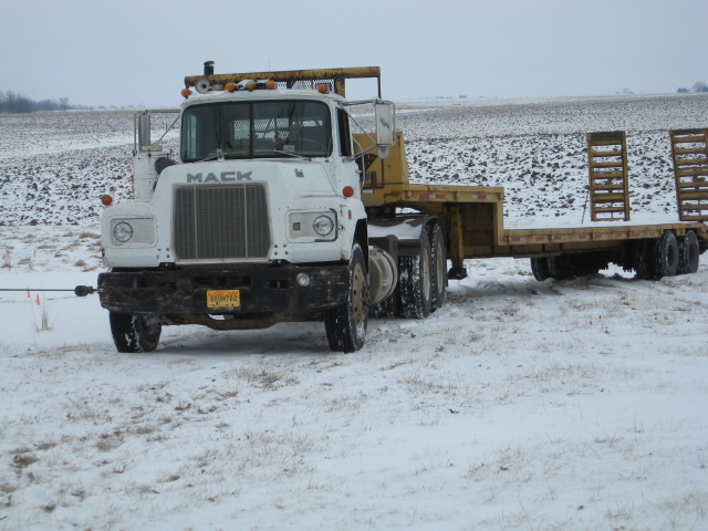

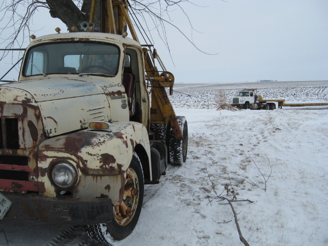

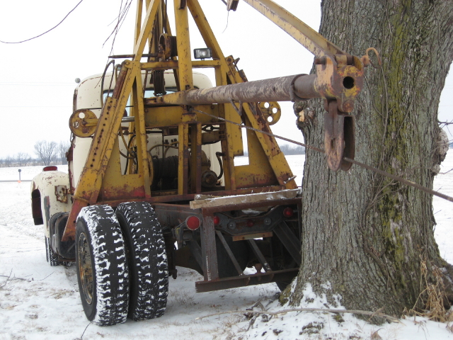

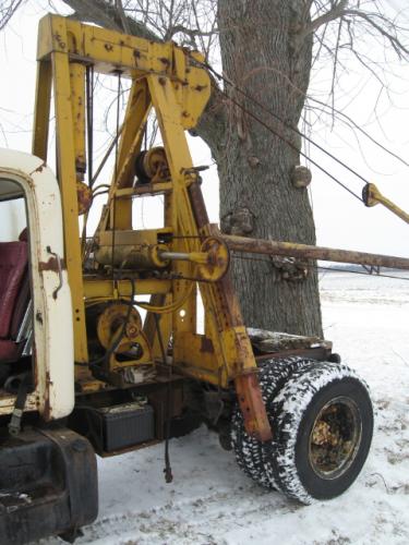

Got it winched out this afternoon by backing ole "Fred" up against a tree to keep from pulling back. The hill was so slick I had to winch up to flat ground as under the snow is plenty of ice. Here also are a few photos of the trailer hooked to the truck. It is all now in the building warming up so I can diagnose the brakes tomorrow.

Heck, ya might get 'er in the garage and thawed out and everything will be working fine. A little moisture in the system tends to freeze up valves on cold days and make things not want to work.
That's also the easiest kind of repair to make...providing you have an indoor heated facility large enough to fit the truck & trailer, which I'm guessing you probably do.

I'm hoping it will thaw out overnite. The trailer was pulled from Manchester NH on Monday and I received it on Wednesday night. Cold weather all the way. The building is 100ft deep and the truck and trailer are backed up to the front of the brown R700 with an R model cab in back of it. The trailer is 42', and the tractor has about a 220" wheelbase.
It was kinda neat to see black smoke from the stack under acceleration too. Means some heat in the exhaust and will surely clean up the innards of the engine. The fuel in the truck is at least four years old.

Hey Rob, hate to get off topic,but what is in the background,upper right side of this picture? could'nt make it big enough to see clearly,and my eyes ain't what they used to be!...........Trailer looks to be in pretty good shape by the way!.........Mark
post-5836-0-72644400-1295752346_thumb.jp
Thanks Mark.
The truck is a 1948 Federal. I really don't know what is going to happen with that one yet.

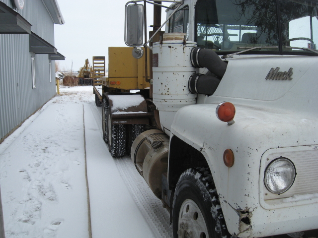

Im specting you best be getting you a rain bonnet on top of that air filter mister,,,good pics,,,randyp {thas prolly whats making it bounce}
The rain bonnet is on the front seat. I had to take it off cause the truck when stuck was about 250 feet from the shop and needed a shot of ether to get going. It was 2 degrees outside overnight and this thing has a 1500 watt heater on the engine. Too much current to pull through extension cords that far. I don't like to ether engines but it fired right off.

Actually there was a very valuable lesson learned here. I've never had a semi trailer and certainly never operated one in the winter, off road. I had no idea how easily this truck "stuck" with the trailer hitched up. I've been over that same area in all four seasons with my trucks and never been stuck once. Oh well, I know what not to do again so I suppose that's positive.
I also did discover about the truck something that displeased me. I think the power divider needs rebuilt. Sometimes it would hold both axles together, but most of the wheel spinning was done only on one axle. It does not have the air interlock but rather the automatic one. Sometimes the truck would spin tires on both axles however. Also was able to figger out where the slight exhaust leak was under the cab. It was so cold outside I could see just a trace of exhaust escaping from a rub hole under the cab. So small I couldn't feel it with my fingers but it would put exhaust into the cab without the floor mat in place. I thought it was the flex pipe from the turbocharger but it looks good. The leak is dead under the cab floor and on top of the fuel tank will little room to run through.
After I got back up on solid ground I went down the road about a mile to see how the truck pulls. To my surprise it is amazingly smooth through the acceleration up to highway speed. I then turned around and headed back to the shop and as I mentioned earlier the smoke was dark gray to black from the stack. I've never seen this truck really smoke under acceleration due to no weight back there. I may drive a truck up on the deck later in the week and go for a cruise.
During the winching I was standing outside of ole "Fred" at all times. Once I got off the clutch to start pulling I just guided the R model around the trees "Momma" planted last spring. They are just sapplings so would flatten easily then that's a whole nuther set of problems! I was always gonna build me a set of scotch blocks for "Fred" but never did and have never had a way to anchor him down under a pull. He is actually a small crane, but does a fine job winching especially when he's all you got for that task available.
