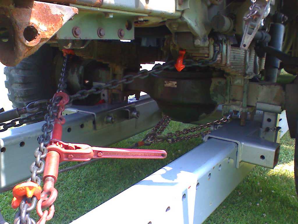

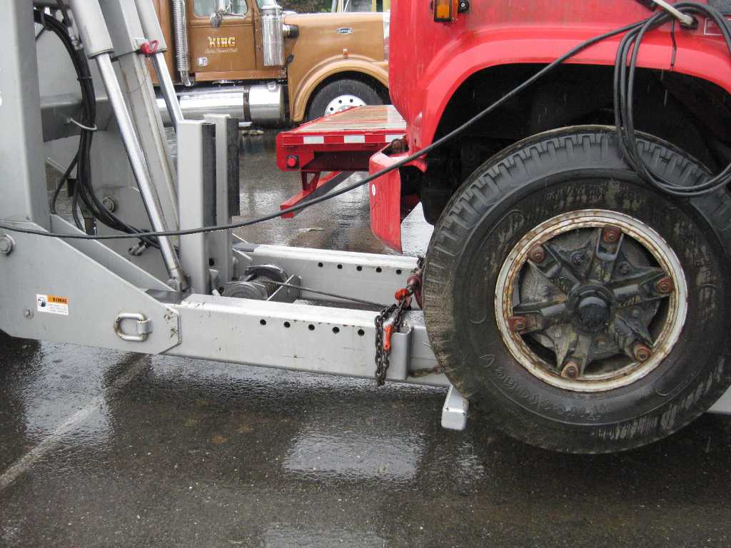

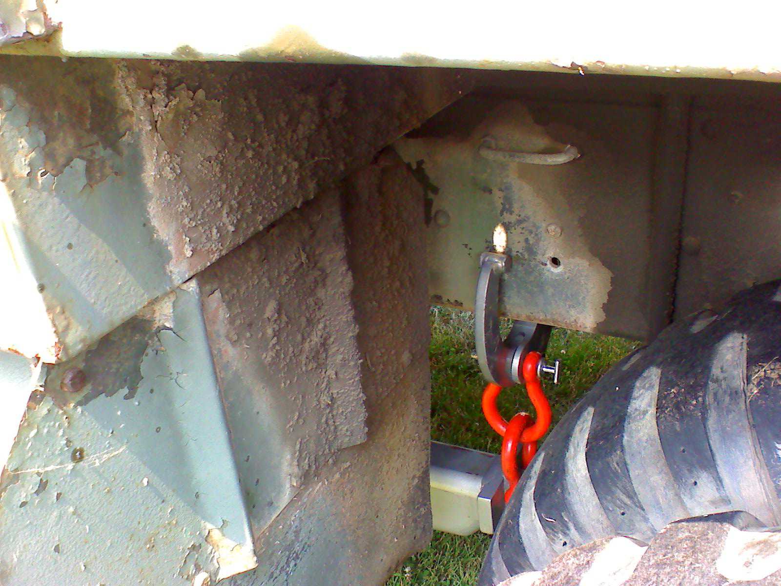

  11. Yup I was going to say the same thing too, tru-hitch. Basically it works like an underlift, the front wheels/steer axle rests on the front of the boom close to the goose neck. Then at the rear of the boom there are clevises that you chain to the frame rails. So when you lift the goose neck, the boom lifts the front wheels but the rear of the boom wants to stay put on the ground since the 5th wheel is a hinge. So the chains tied around the frame rails start to lift the rear of the boom and now you have converted the truck/tractor into a trailer. The weight actually goes on the pin instead of creating a see-saw effect like that of a regular wrecker. Here are pictures I took at '09 and '10 macungie of how the setup works: This picture shows lifting using the wheels This one shows lifitng using the steer axle This is a frame clamp at the end of the boom, chains can also be used like I mentioned above. Overall its a pretty sweet setup. Would be a great way to move antique trucks around (as long as the tires hold.)

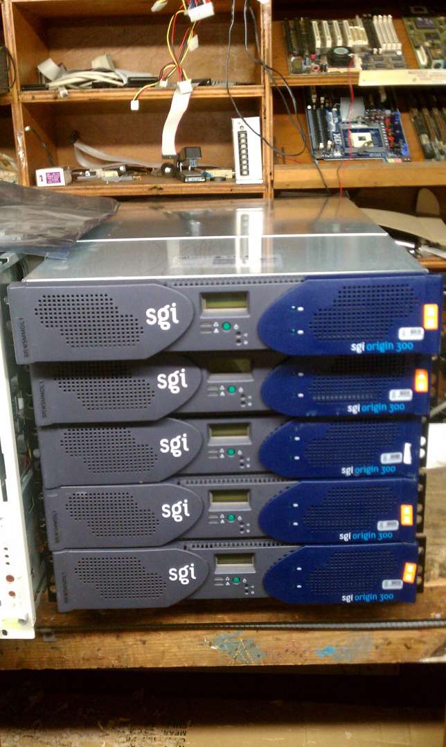

  16. I still watch some kids cartoons. My two favorite modern shows are Adventure Time and Regular Show. Both air on the Cartoon Network. My random: Silicon Graphics Origin 300 servers I just got the other day
