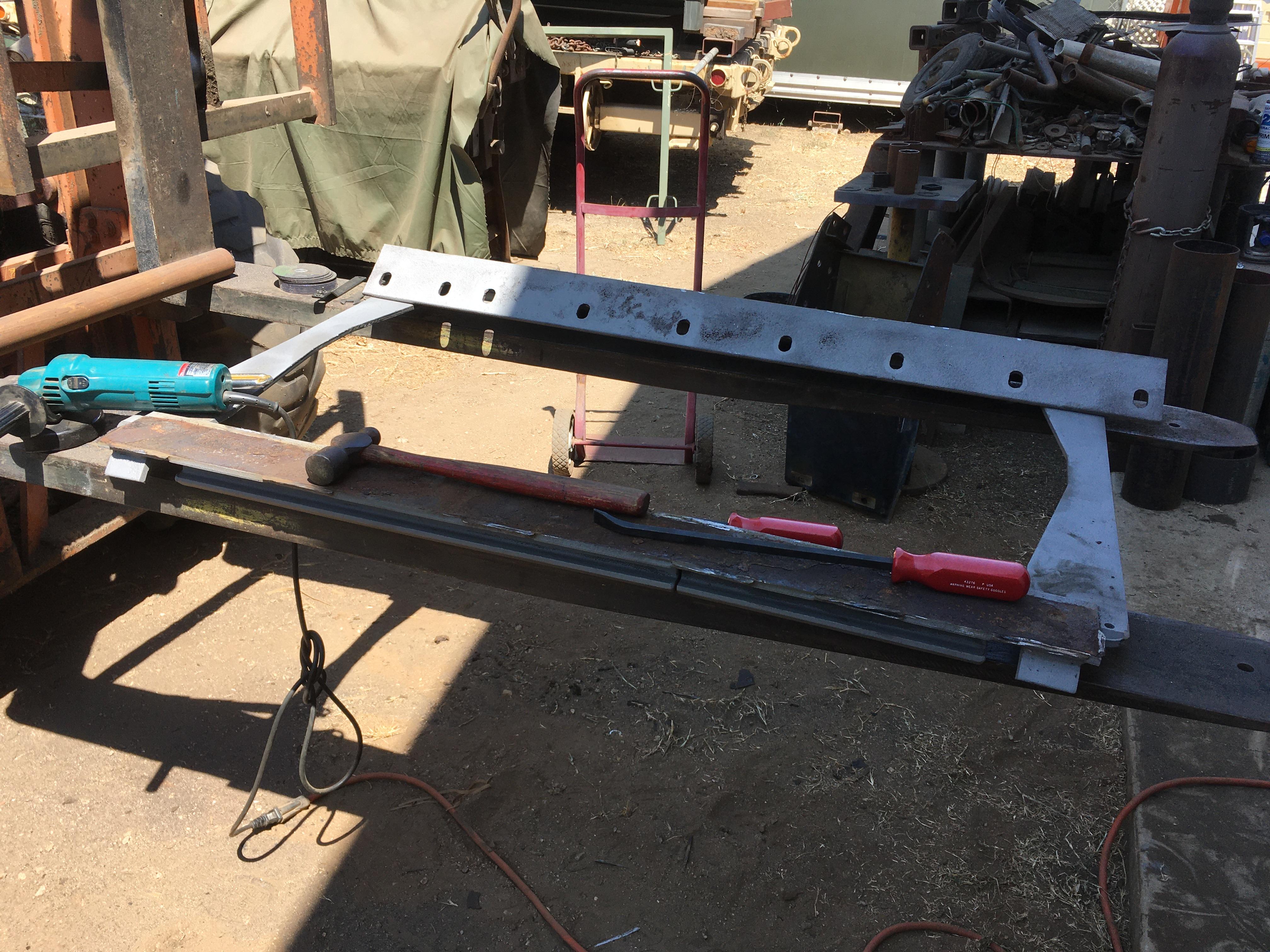

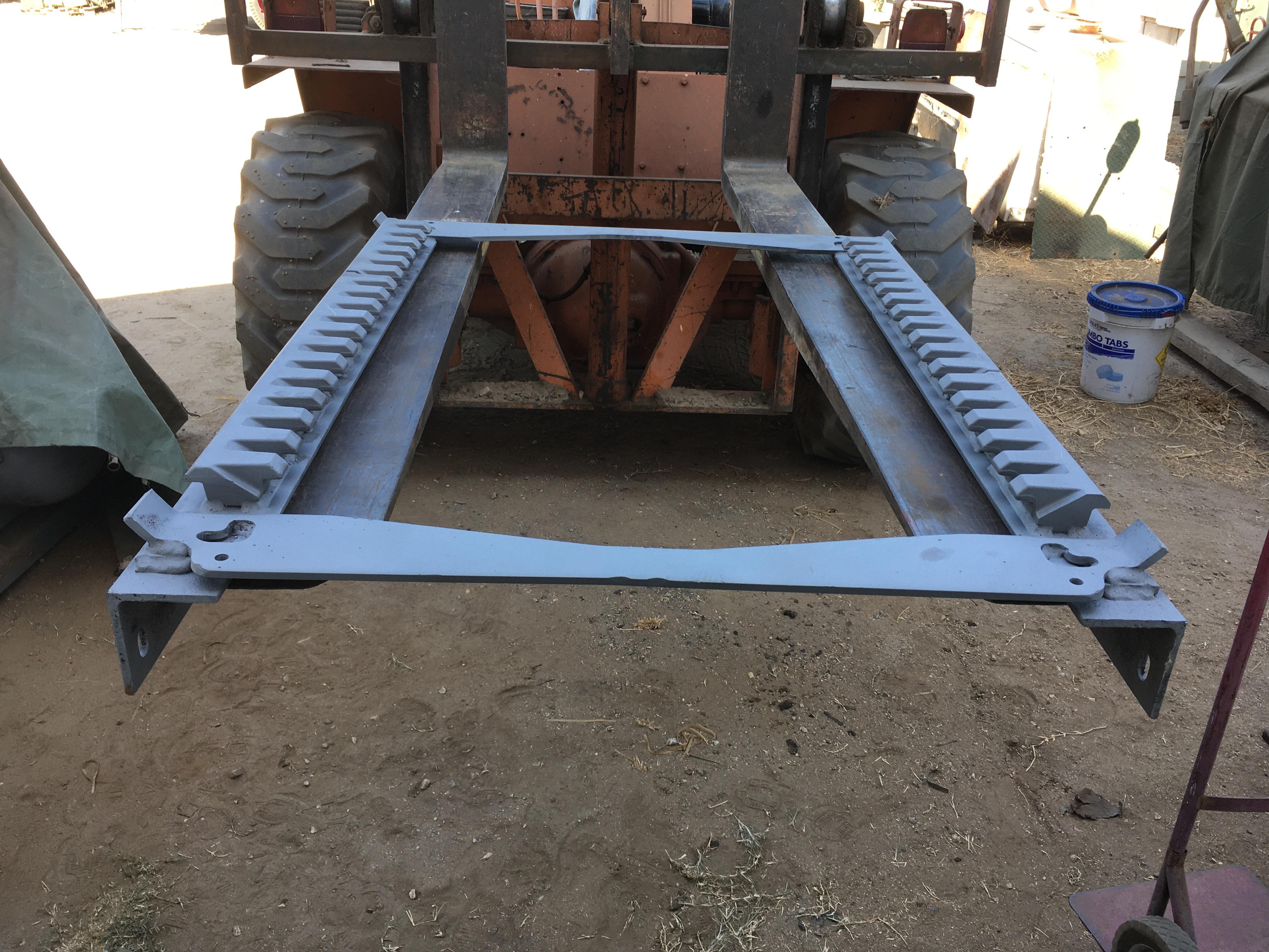

  1. I picked up a sliding mount for the truck Saturday It did come with a fifth wheel The base is disassembled and almost ready for the sand blaster. The sliding part will be powder coated
