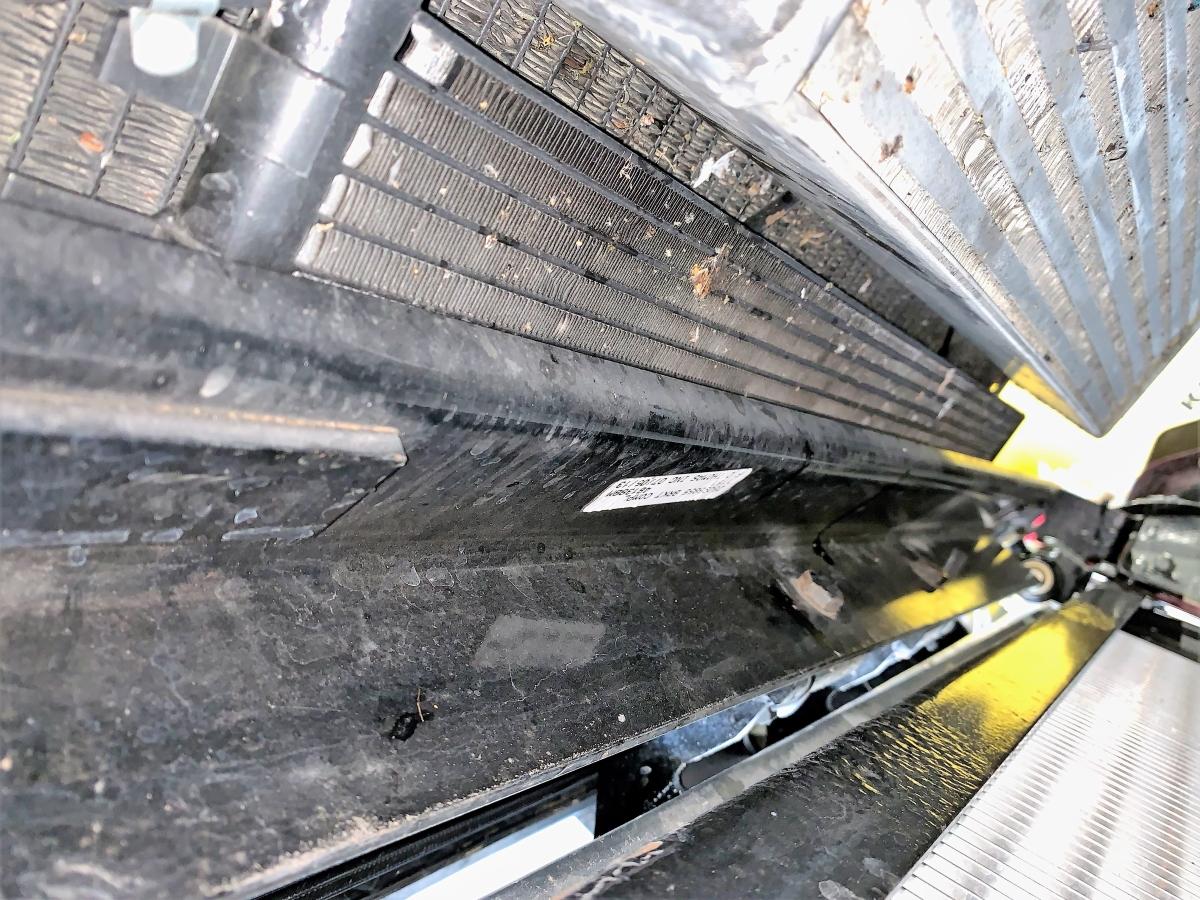

The evaporator coil is in the air box under the dash. The condenser coil is mounted in front of the radiator or a Grilldenser. Maybe a little confusion there. i did have to find the one condenser coil that matched the size I had to fit it into. The CL 700 parts worked perfectly and I did have to tell the parts guy to special order it. Just as You said the current part as a little different in size sometimes. The new part I used was smaller and does work better in the RW. I used the Red Dot parts that are currently made and sold by the OEM, Red Dot, and others that cross reference them. Mack may not have them but Red Dot or Kysor made the units for Mack and still stock or cross reference most of the parts. Changing over to R134 takes different parts than what came on pre 1993 R-12 systems and a little retro-fitting is required. -

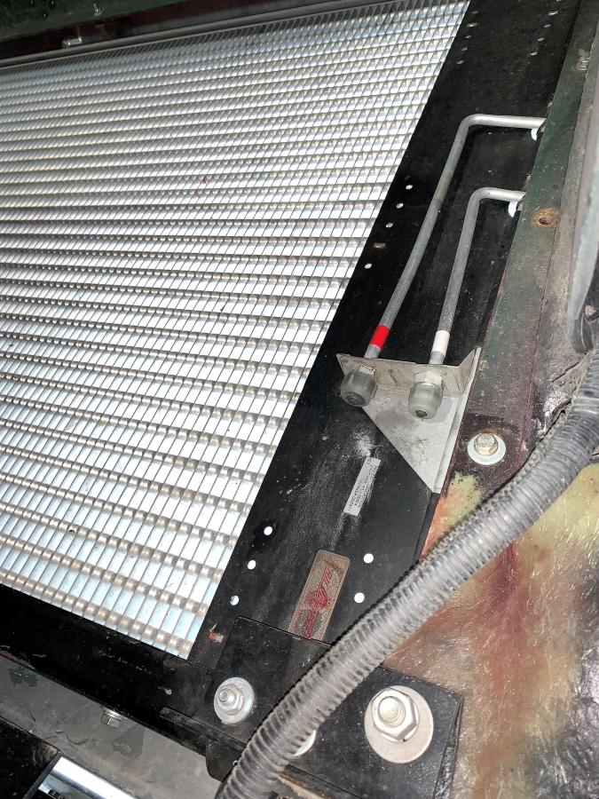

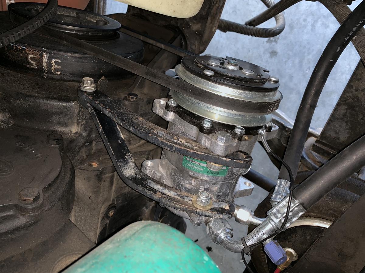

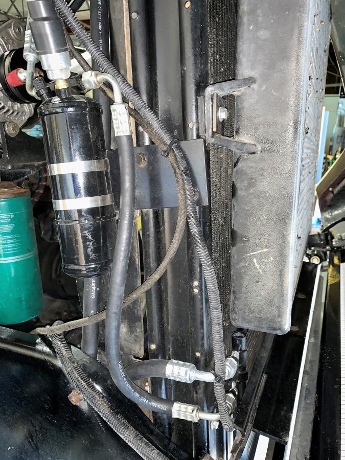

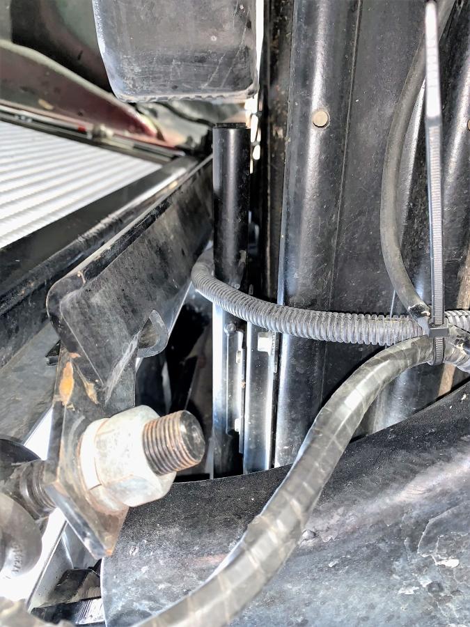

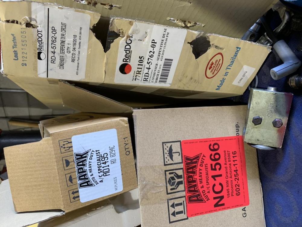

The evaporator coil is the same, I just had mine tested for $20 and reused. This is what the parts look like installed. Just cap your Grilldener ports and reroute the lines to the condenser mounted under the air2air. Part numbers for: Pump, Condenser, Dryer and showing expansion valve. Installed with new Condenser, Dryer, High pressure switch, New high pressure lines. Don't forget to get the high pressure tap in your hose fitting, I did the first time. (red cap) New pump, was shinny until running in rain for a couple of hours. Get low pressure tap in hose fitting. (blue cap) n New condenser mounted under the air2air between radiator and hood bracket. Driver side view of condenser. Plenty of room but I did move the radiator back 1 inch. It was not needed with this version of condenser coil that is thinner than older ones.
